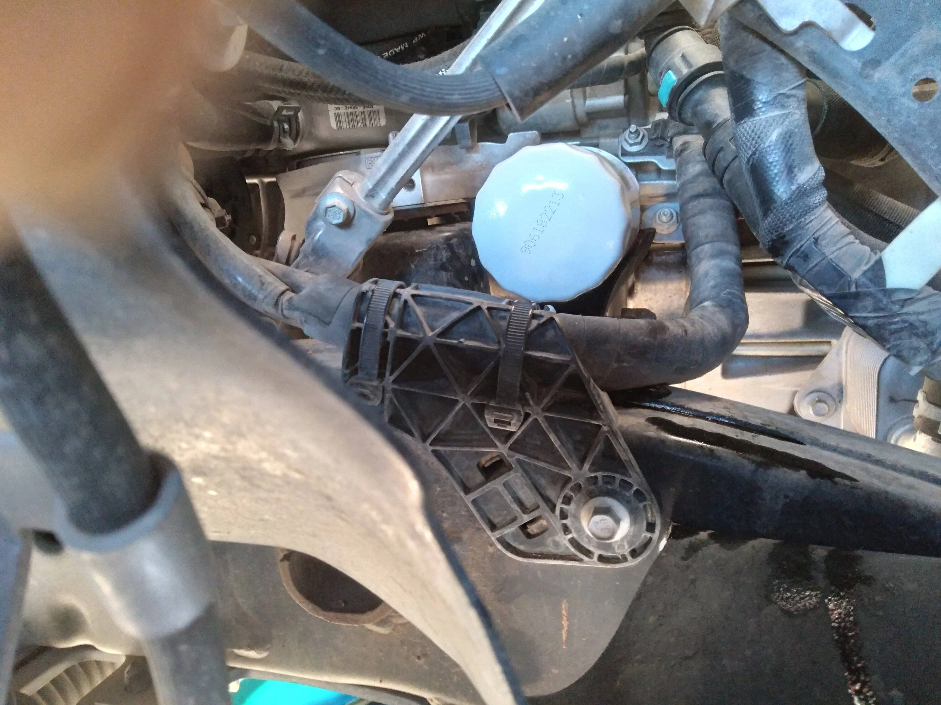

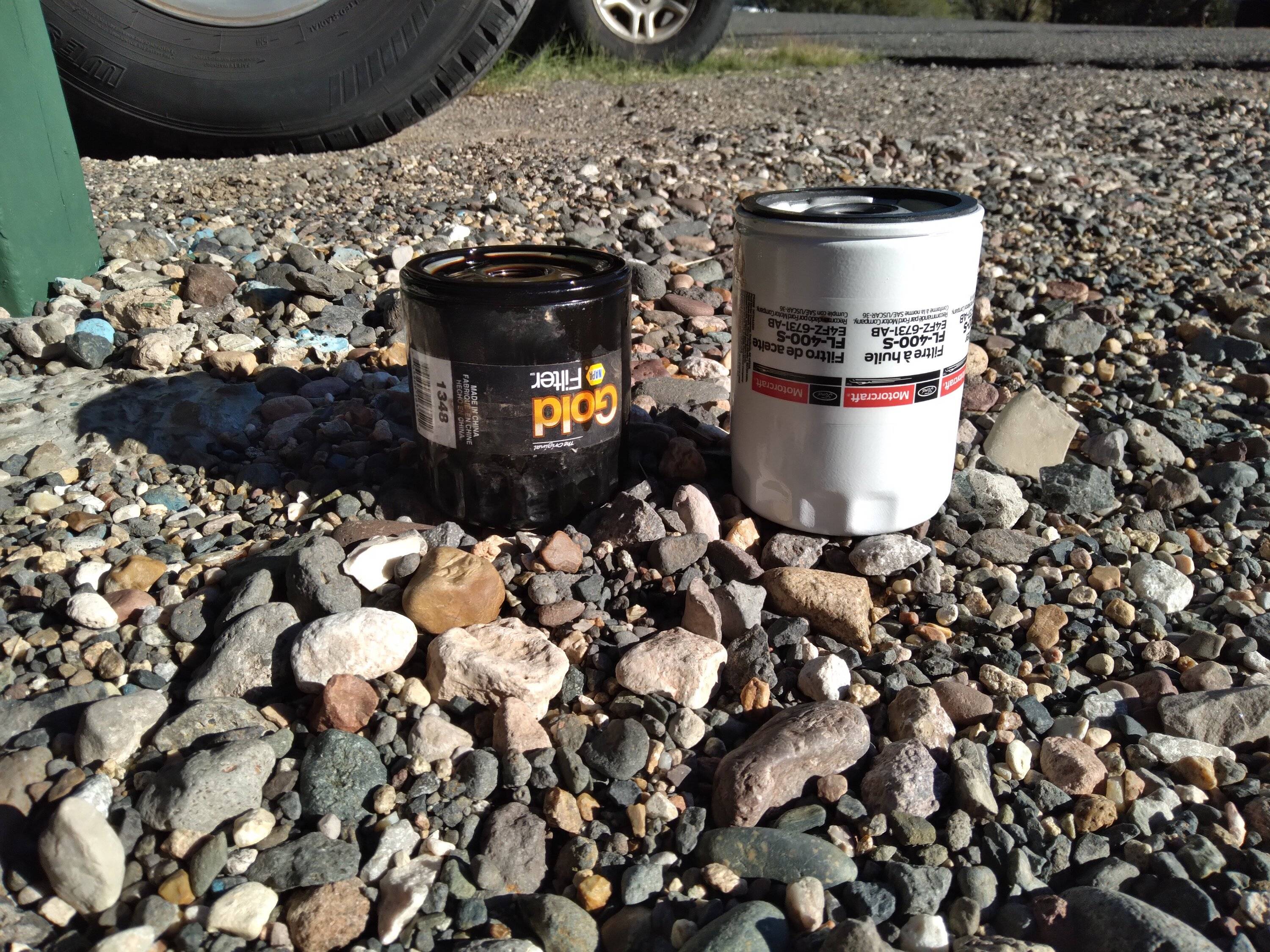

My first few oil changes I used the FL-910S filter. Walmart had them for $7, almost half of what the dealer was charging.
Walmart was out of them last time so I got a Wix (NAPA Gold) filter from NAPA. It is about the same capacity as the 910S filter.

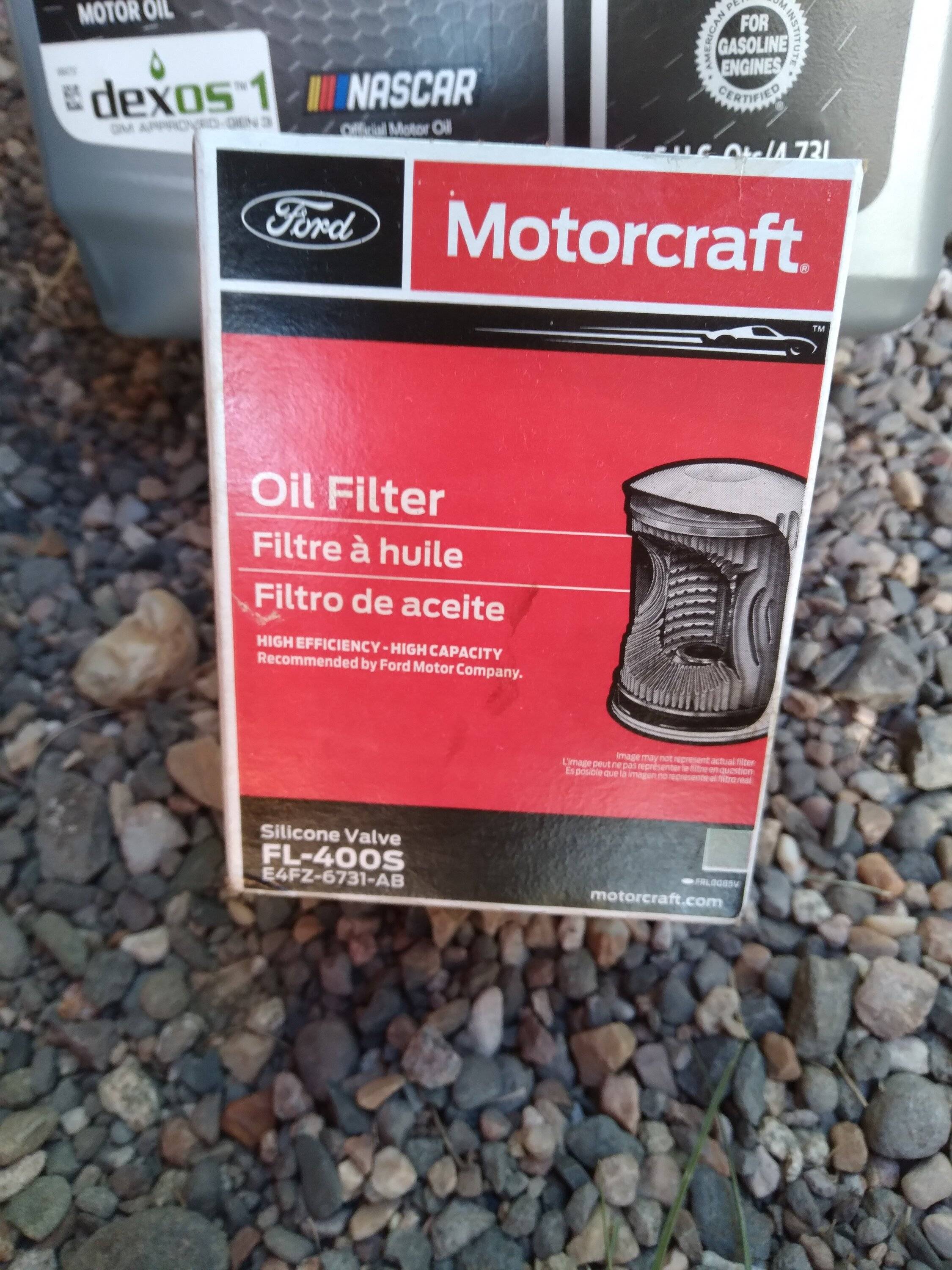

While getting some Mobil 1 for the oil change I did yesterday, I saw the FL-400S Motorcraft filter.

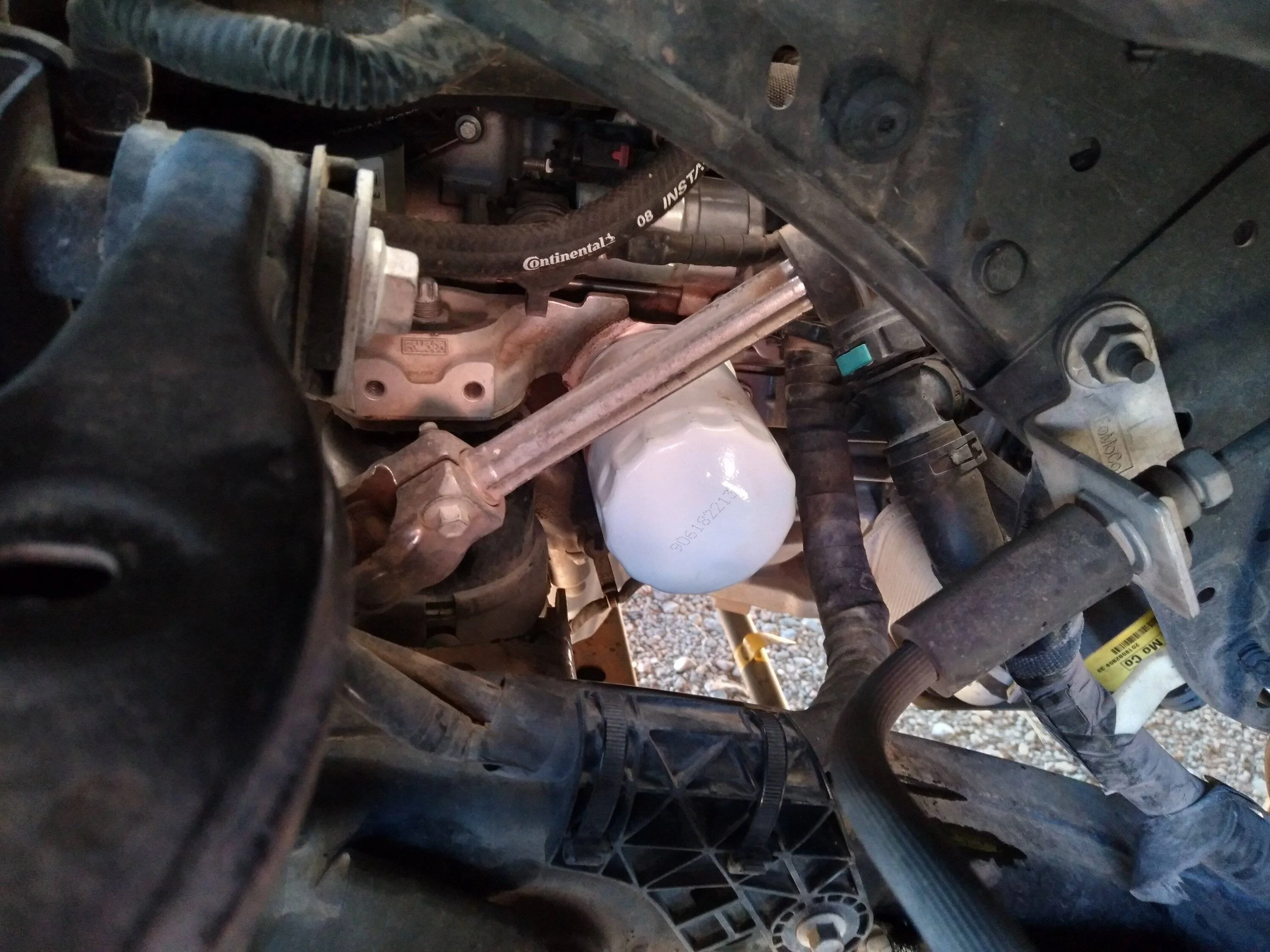

I couldn't find out what it was meant for ( maybe the old Ranger with a V-6 ?)) but I purchased it, and was happy that there is plenty of room for it, as it is longer than the 910S and has increased capacity.
Except for the additional length, it appears to be identical to the stubby FL-910S.
I know our engines are just a 4 cylinder, but they work hard. I don't think extra capacity is a bad thing.
I used a longer-than-normal Wix/NAPA filter on my old Grand Cherokee that had the 4.0 inline 6.
There a no clearance issues, the filter could be even longer if need be.

I know this is an old post, but my Tacoma uses the same filter. The larger in the wix is a 51516xp. Same micron, bypass etc just a little larger.
Wix has all the stats on their website
