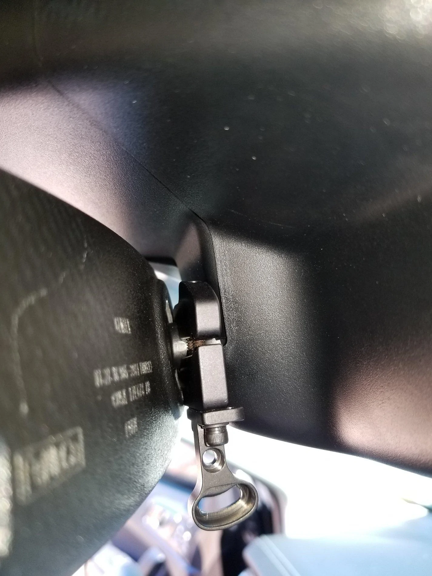

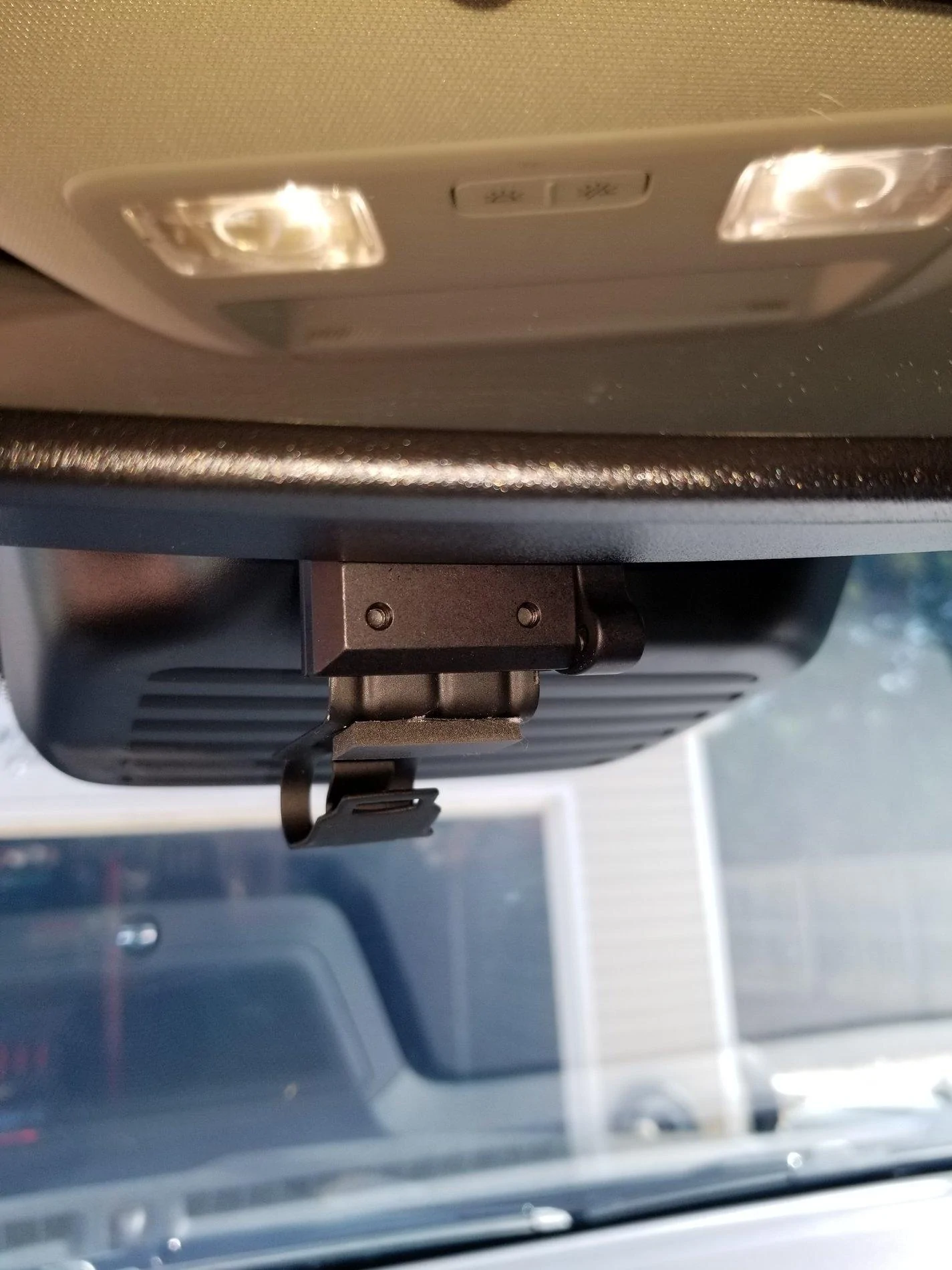

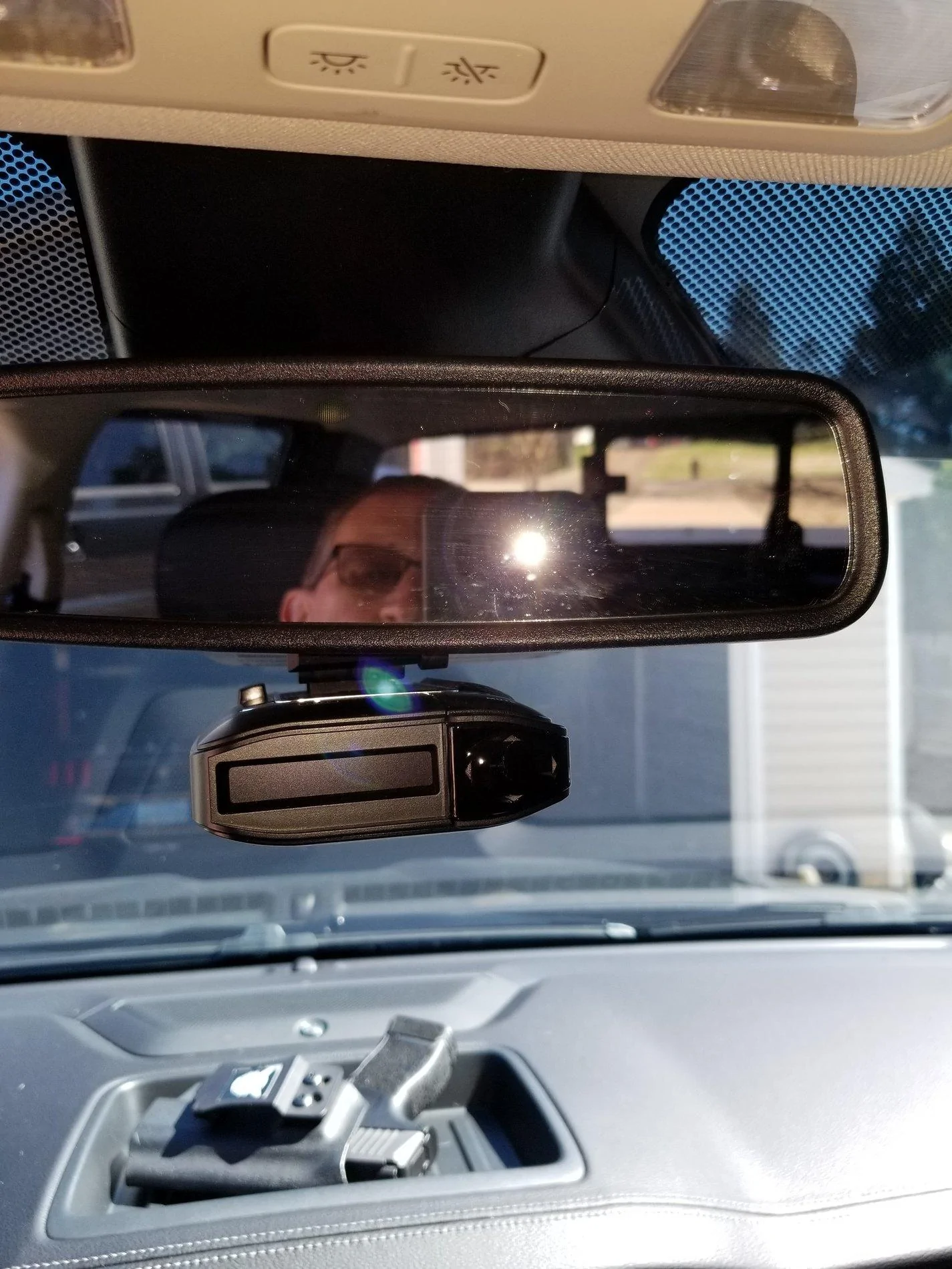

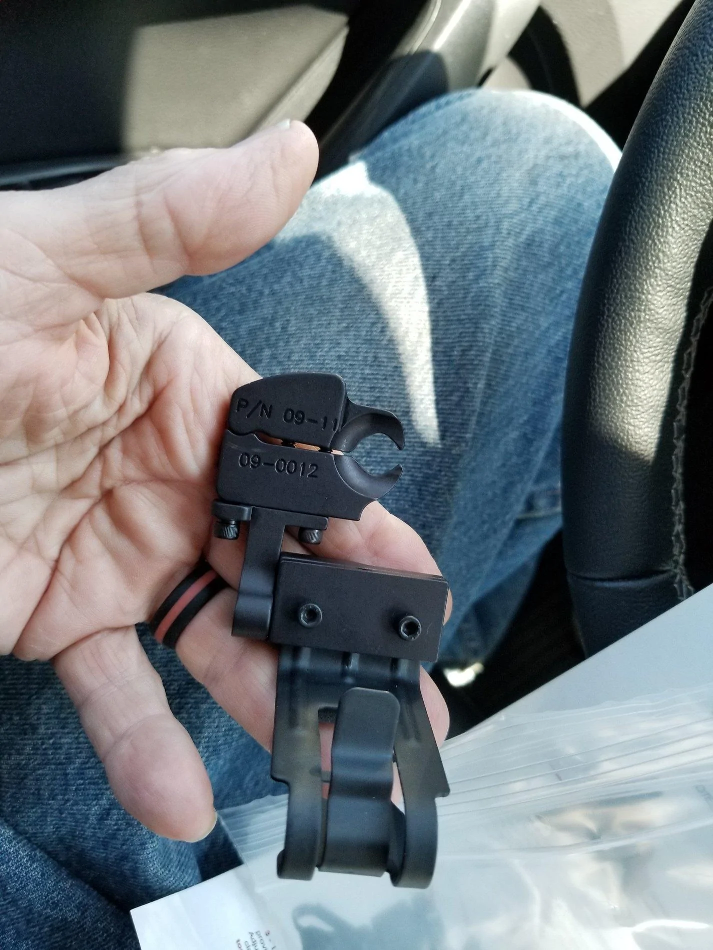

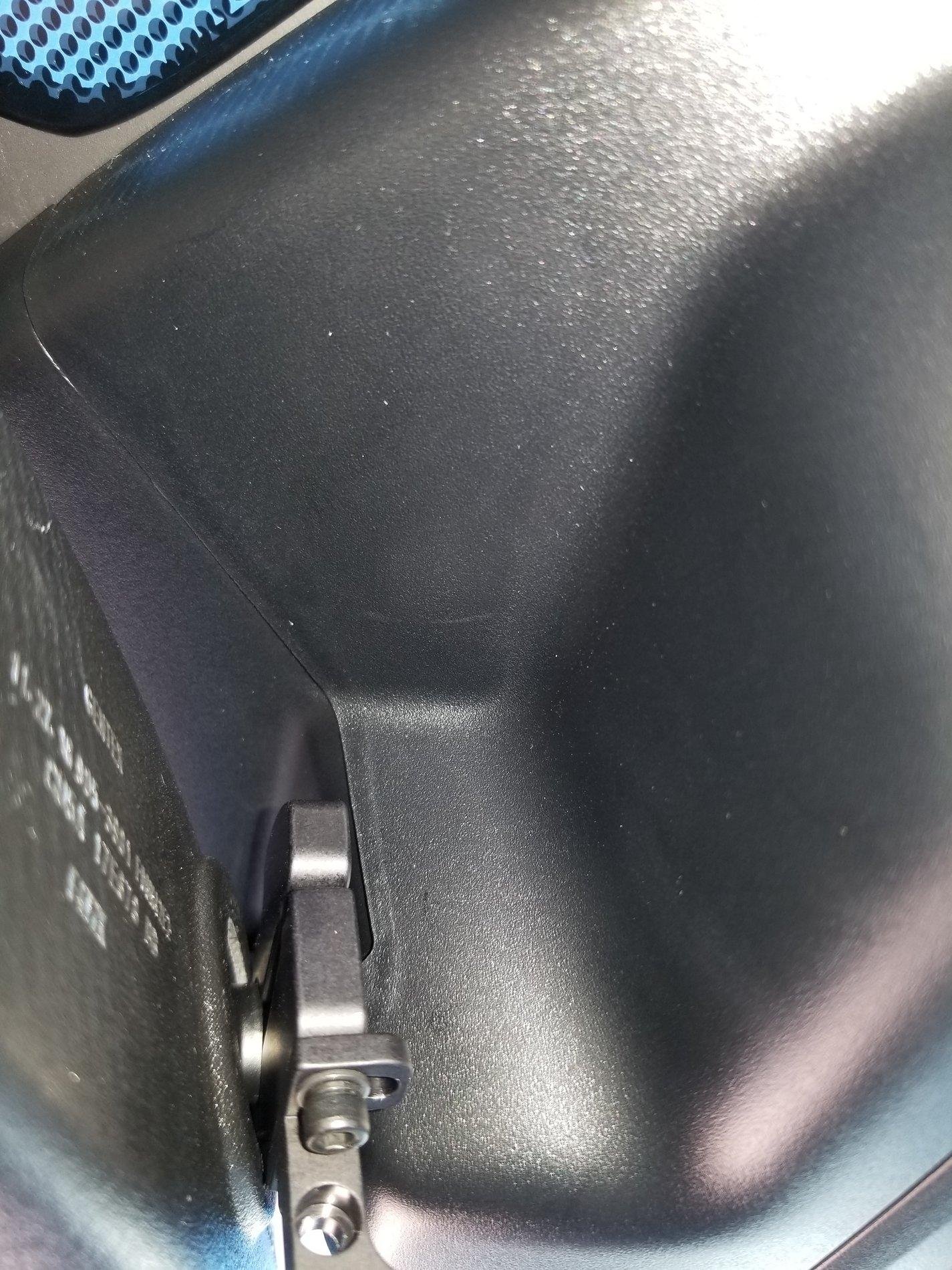

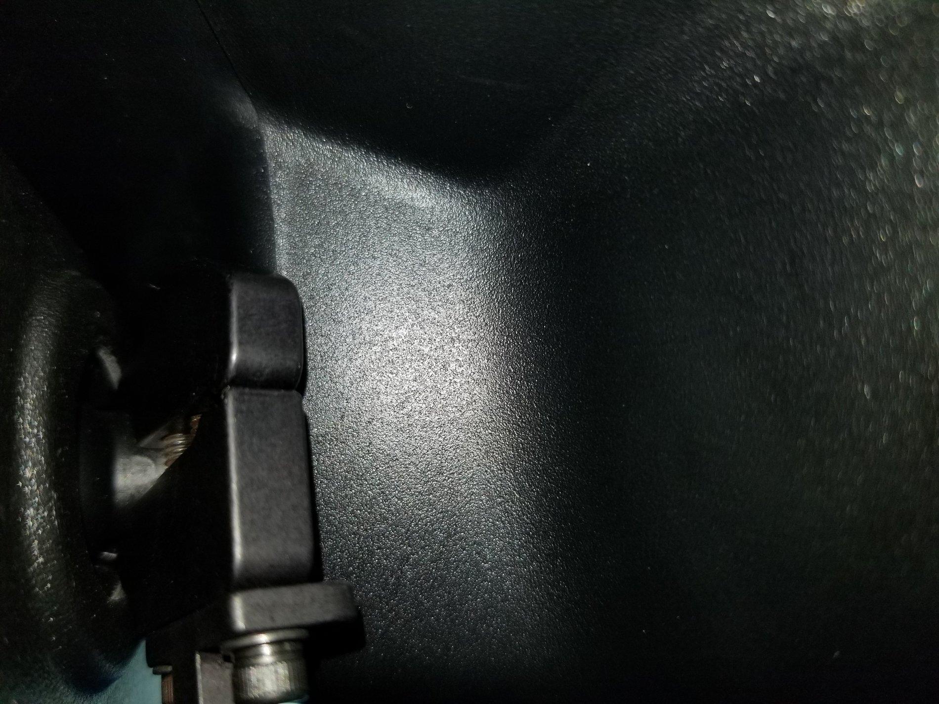

My Blend Mount for the Escort 360 came in today. It looks to be a real nicely manufactured piece. Install took about 5 min with the hex wrench they provide. It seems sturdy enough and with the weight of the 360 it appears that it will work quite nicely. It basically is a C style clamp machined to meet the contours of the mirror and stem. Well done BlendMount !

Heard from my supplier and apparently I didn't install it correctly.. the 2 C pieces are supposed to touch.. took it back down and put it on right..
My bad... duh

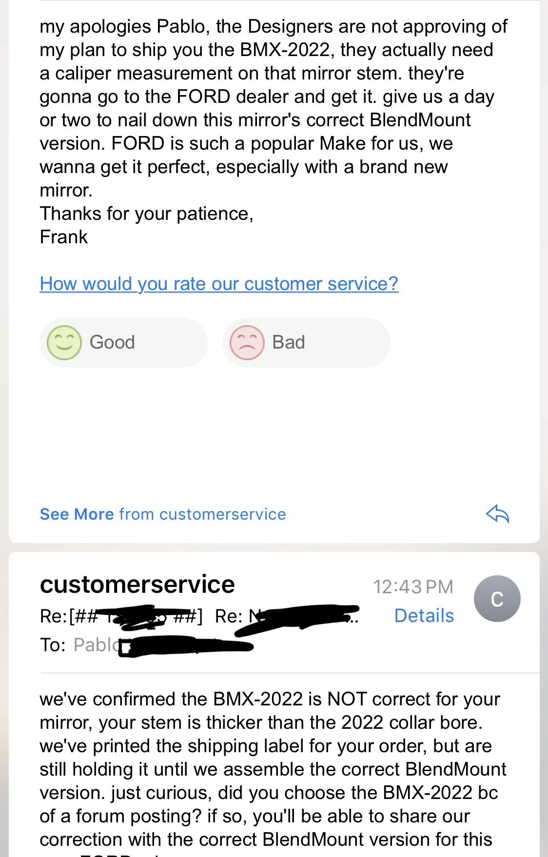

So I reached out to Blendmount to order the BMX-2022 part for our Ranger. While it looks like it still works, the designers weren't satisfied with the fitment and will be putting together a new kit in the near future.
Their customer service is top notch and always have clear and fast communication!

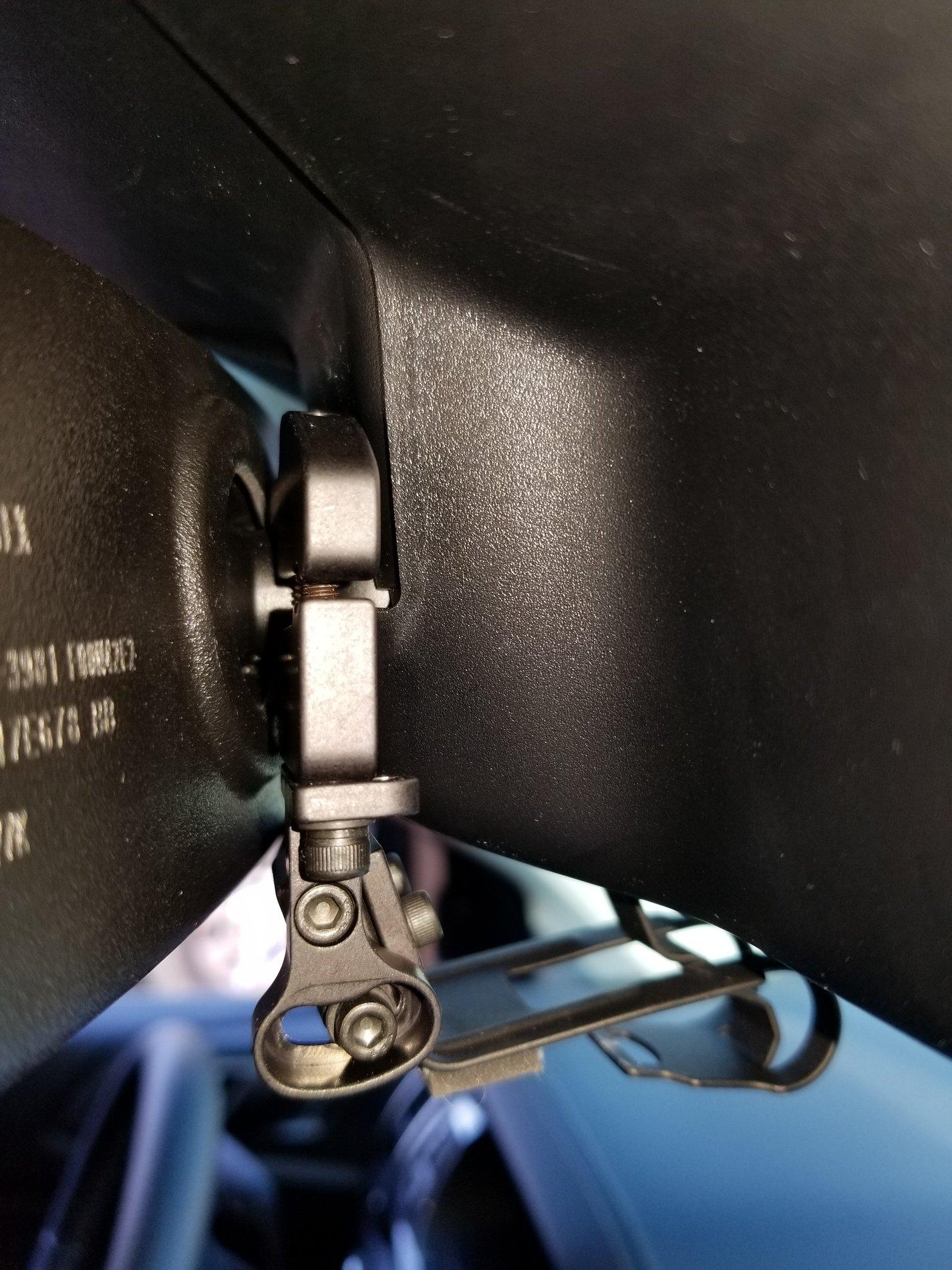

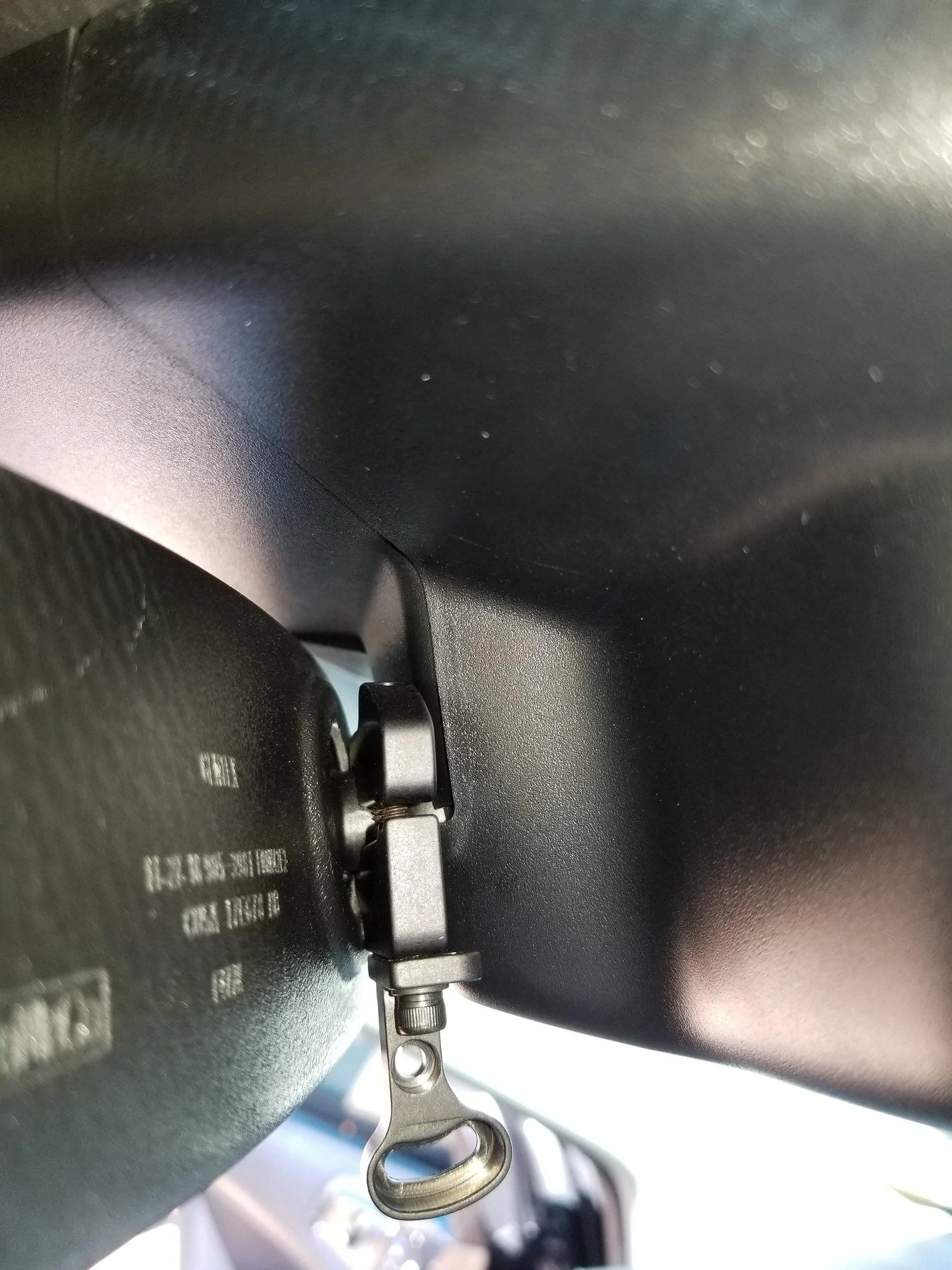

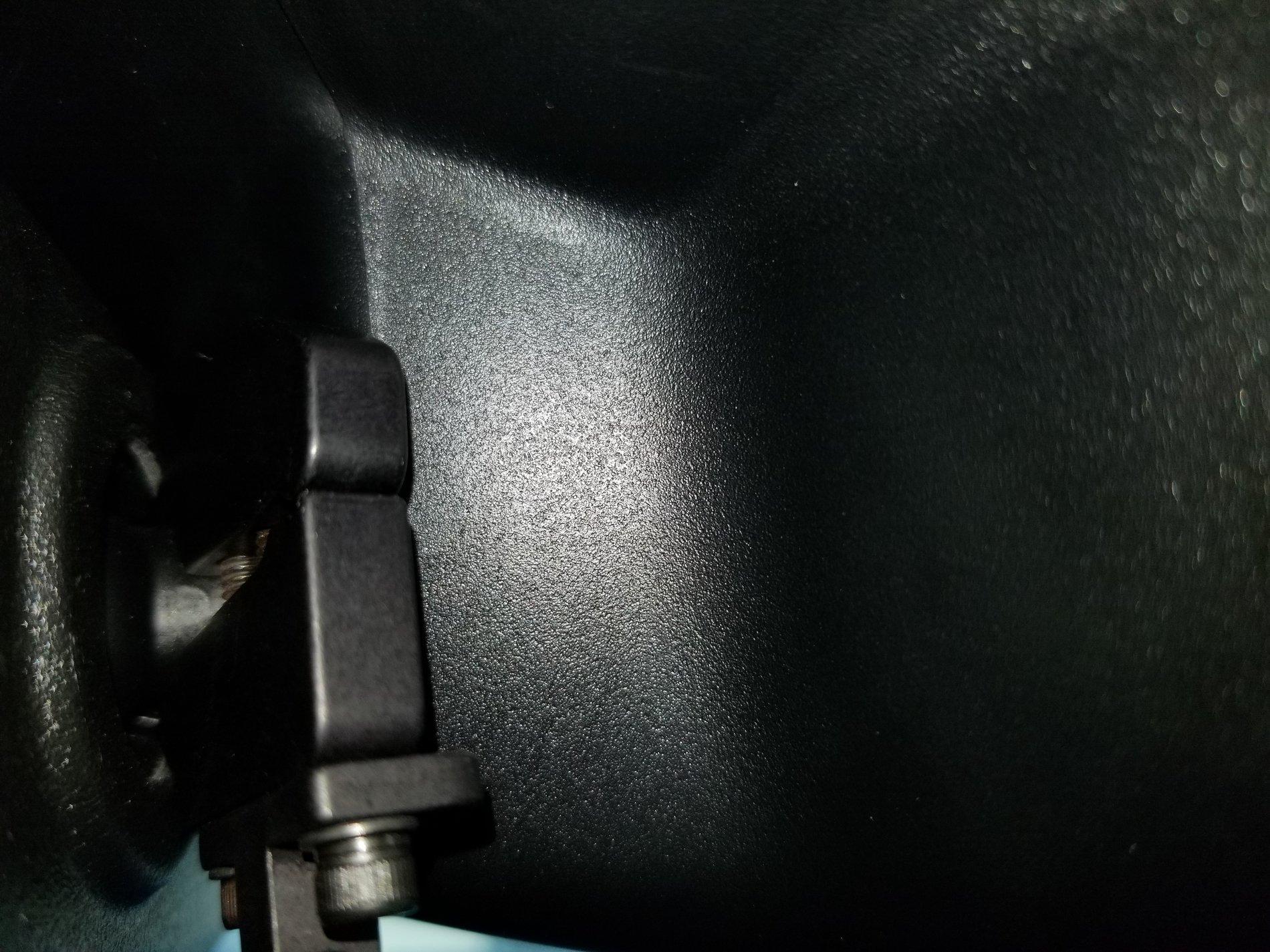

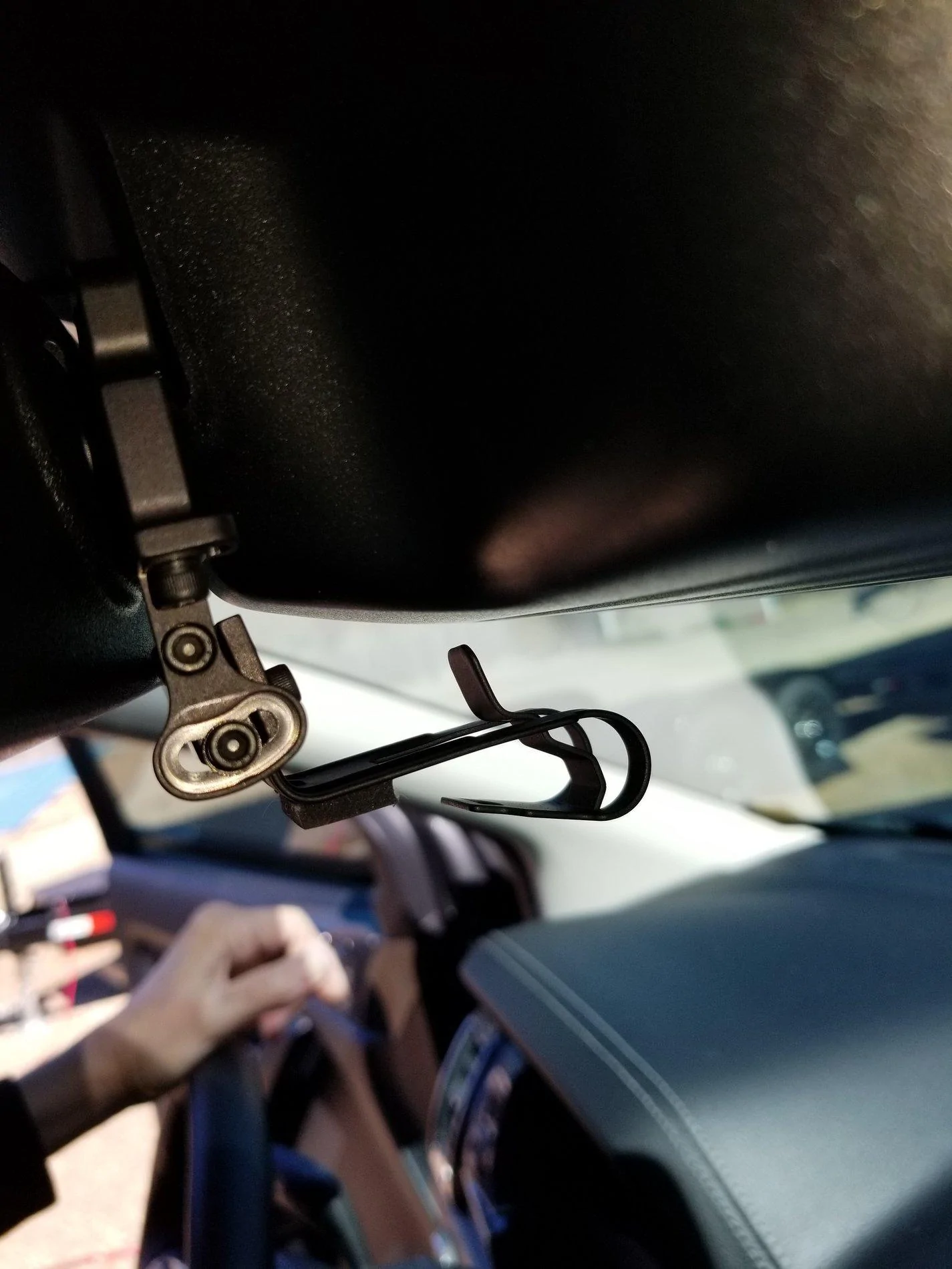

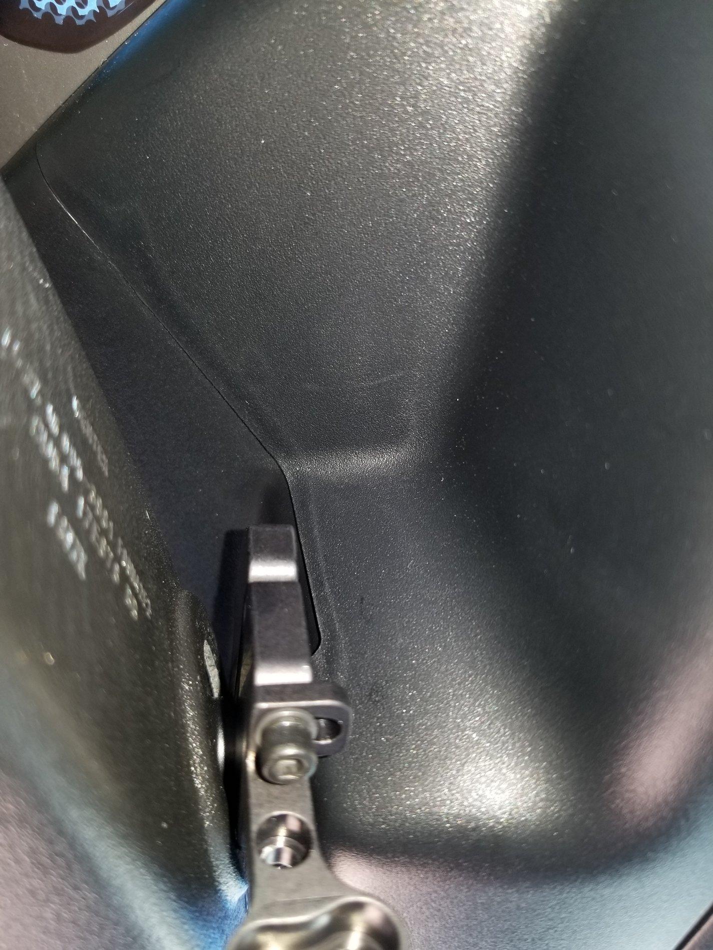

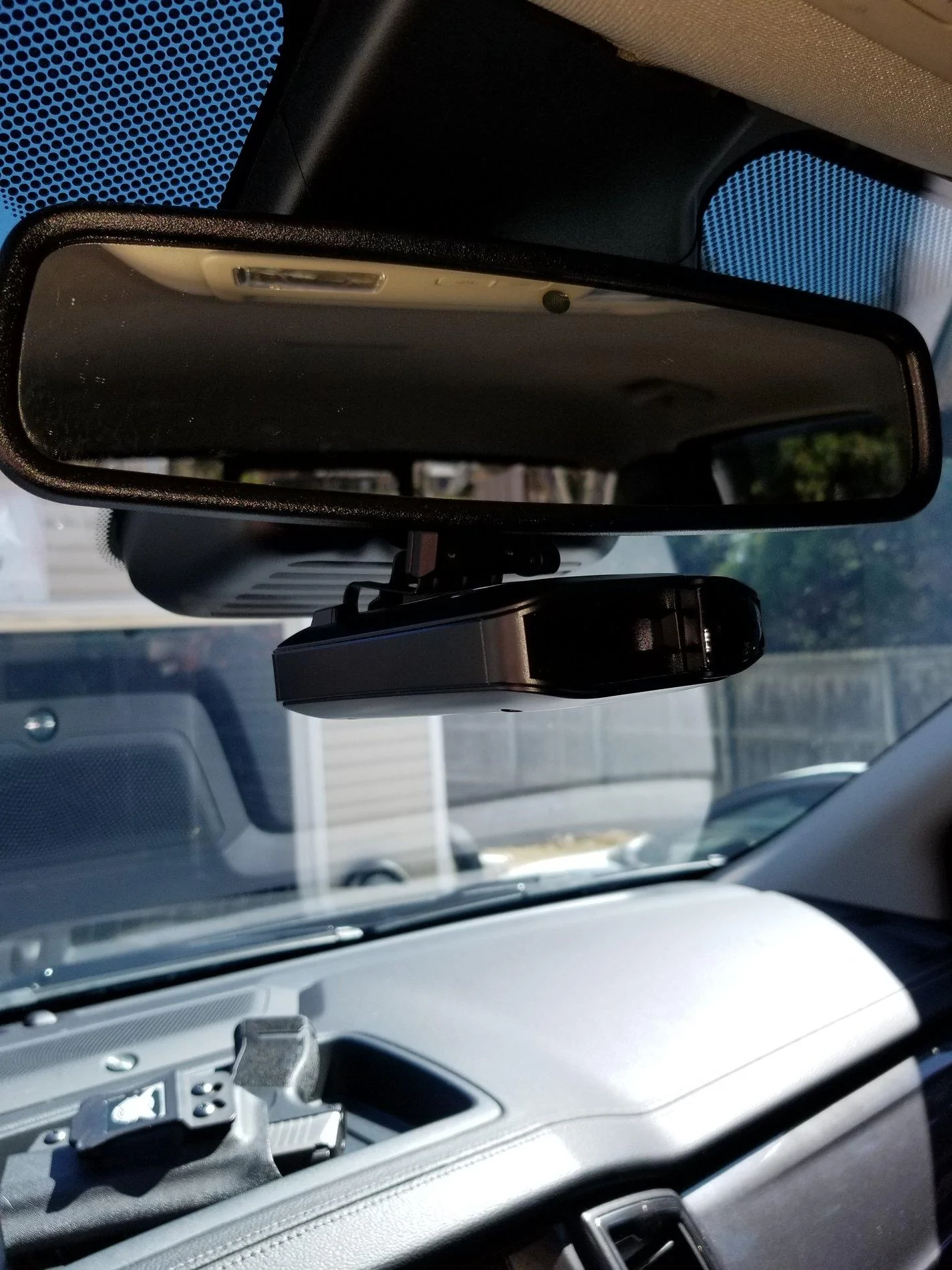

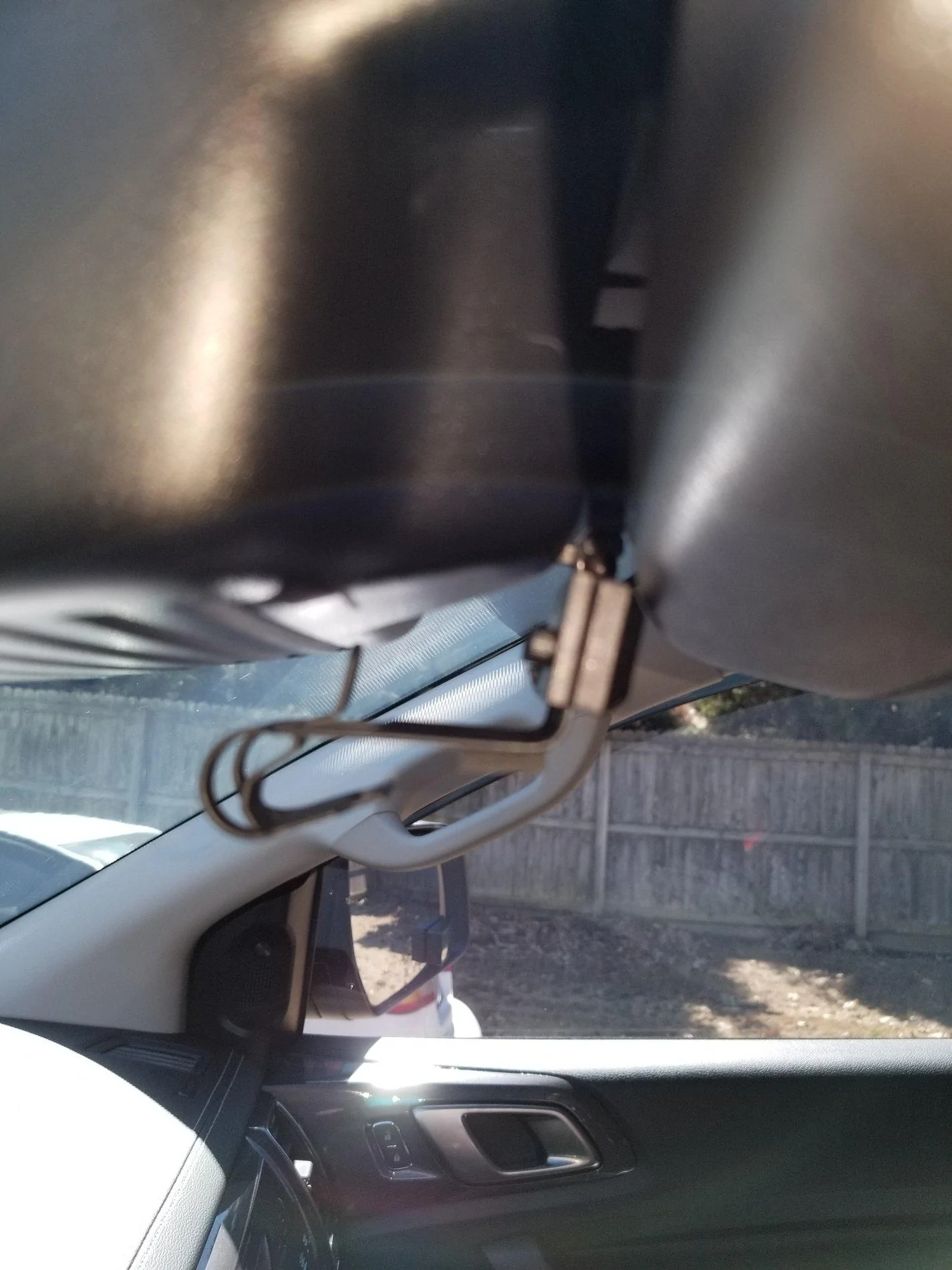

Here’s the pictures from my Blendmount Escort 360 mount and Mirrortap. The Blendmount was a beta build for the NA Ranger that was shipped to me on 3/20/2019.
It’s been working great for me with no issues after driving about 1500 miles post install and I don't see them making any changes to it. It didn’t have a part number on the one they sent me, but I'll reach out to them and see if I can get one for anyone interested.

It clips into place. When I received my beta-tester Blendmount, they sent me some spacers/extenders that I could use to add extra space to clear the plastic housing. The most important piece is the actual clamp to the stem. Blendmount had to send me a new clamp to fit the proper stem diameter.

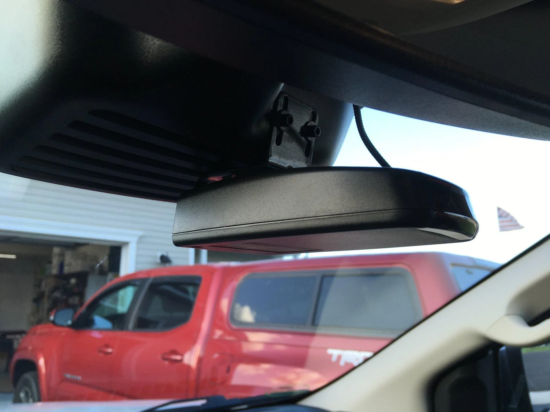

Well I guess im cheap but I couldnt spend another $150 bucks for another blend mount although they are very well made. I tried to combine the 2 blend mounts I have and they wouldnt work. I ended up using the Bel mount and drilled 2 #6 holes in plastic cover under the rear view mirror and used an 1/8 inch piece of aluminum as a backer and threaded it #6-40. Mounted it and wired and its good to go,no shaking or rattles. Total cost 0. Hardest part was removing the cover under the mirror.
