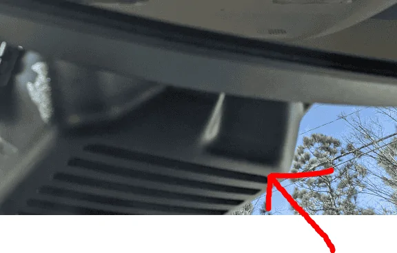

Has anyone found a easy way to gain access to the mirror wiring plug? I don't see how to get to the plug, maybe the big housing mounted to the windshield needs to come off? I don't want to break anything so I'm hoping somebody has figured out how to get to it.

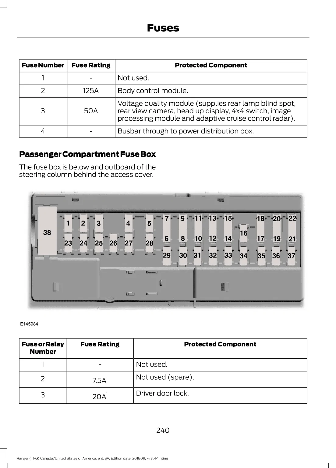

Great job but I'd be afraid I'd break the housing. lol Is the power from it constant or just when the truck is on? I ask because mine has the parking module which you need power for it to work.
The points I used are only powered when the ignition is on, but I think there are also points that are always-on as well.
137,231
Good to know, Thx! I used an OBD cable because I like that I can just unplug it if I'm going to be parked in my garage for a few days. It does go into sleep mode but sometimes I'm getting stuff in/out of the truck so it's constantly waking up and filming the wall.

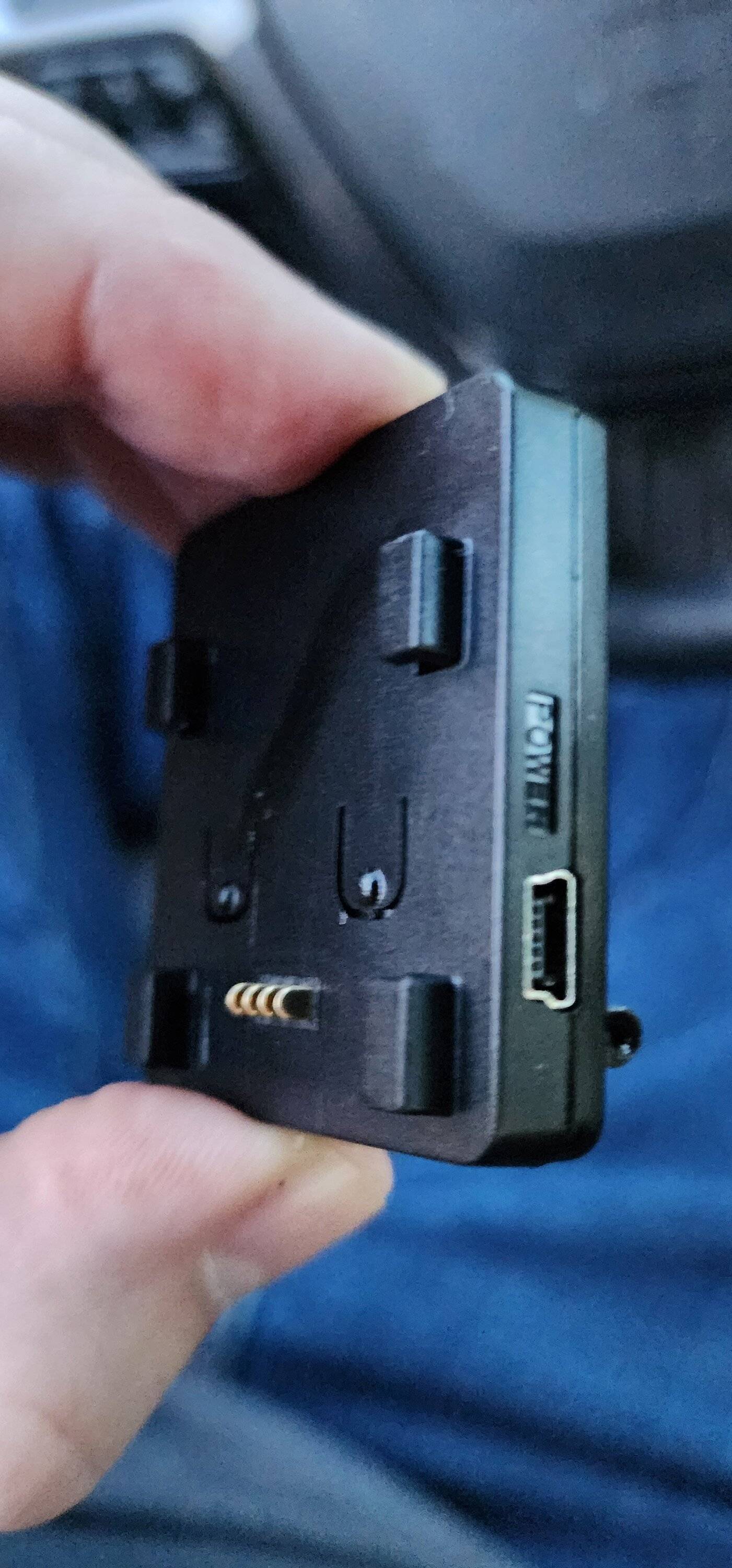

GPS module went bad, luckily all of 17 bucks on Amazon.
Took the opportunity to hide the cabling that I was kind of ghetto on first time. That rear view mirror cover over the lane assist camera ain't no joke to get off.
Viofo GPS module that went bad.
Clean cabling going through hole I made.

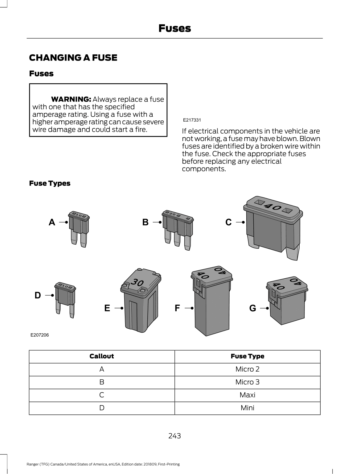

Whoever mentioned the fuse cables having to be trimmed down which I can't seem to find the comments now that I'm looking for them, thanks for saving me from insanity. Took my Dremel to mine to get them to fit.

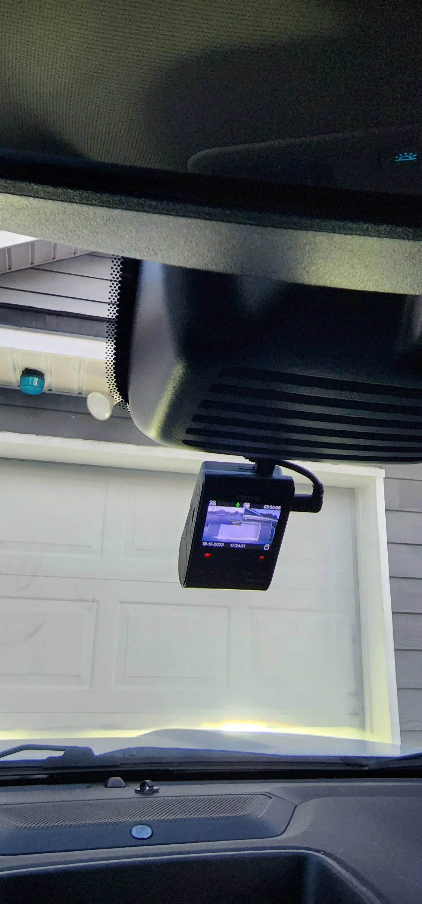

How did you get the large lower housing off? I tried when I installed my original cam but I think I gave up on it.
I just upgraded to a newer cam (Vantrue E2) this weekend and still couldn't get that lower housing off (tho I didn't really need to).

I looked last night and this am and can't find it but someone posted a picture from a document showing the removal procedure. There are two clips on the smaller top piece and it's supposed to remove top down and then there's 4 in the bottom larger piece. I used trim removal tools and just gradually pulled harder and harder. The bottom one really took some work I got the bottom two clips to release before the top two.
How neither broke, I don't know.

I tried to get mine off to no avail. I thought for sure i would going to brake something. I'm still looking at the cord going down to the power port :(
I recently got a chip in my windshield and will need to have that repaired. I was going to ask the tech if he had to remove one of these to replace a factory ranger windshield. I'm hoping they have a trick or two on how to get that thing off. I'll let y'all know if that works out.
