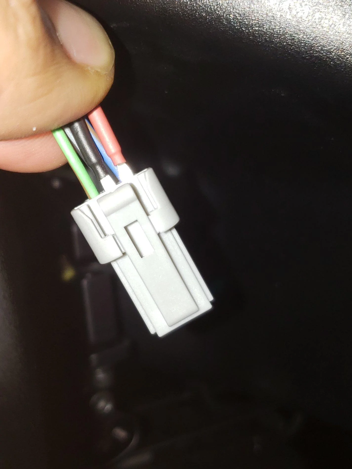

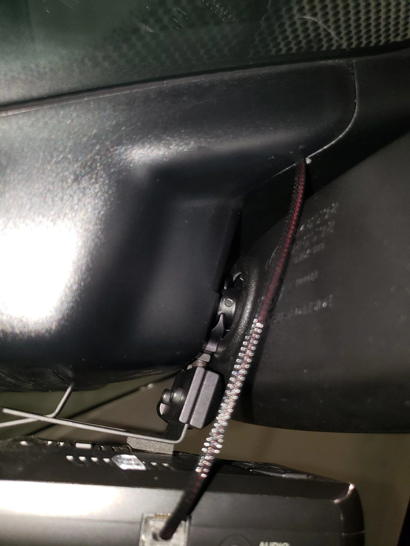

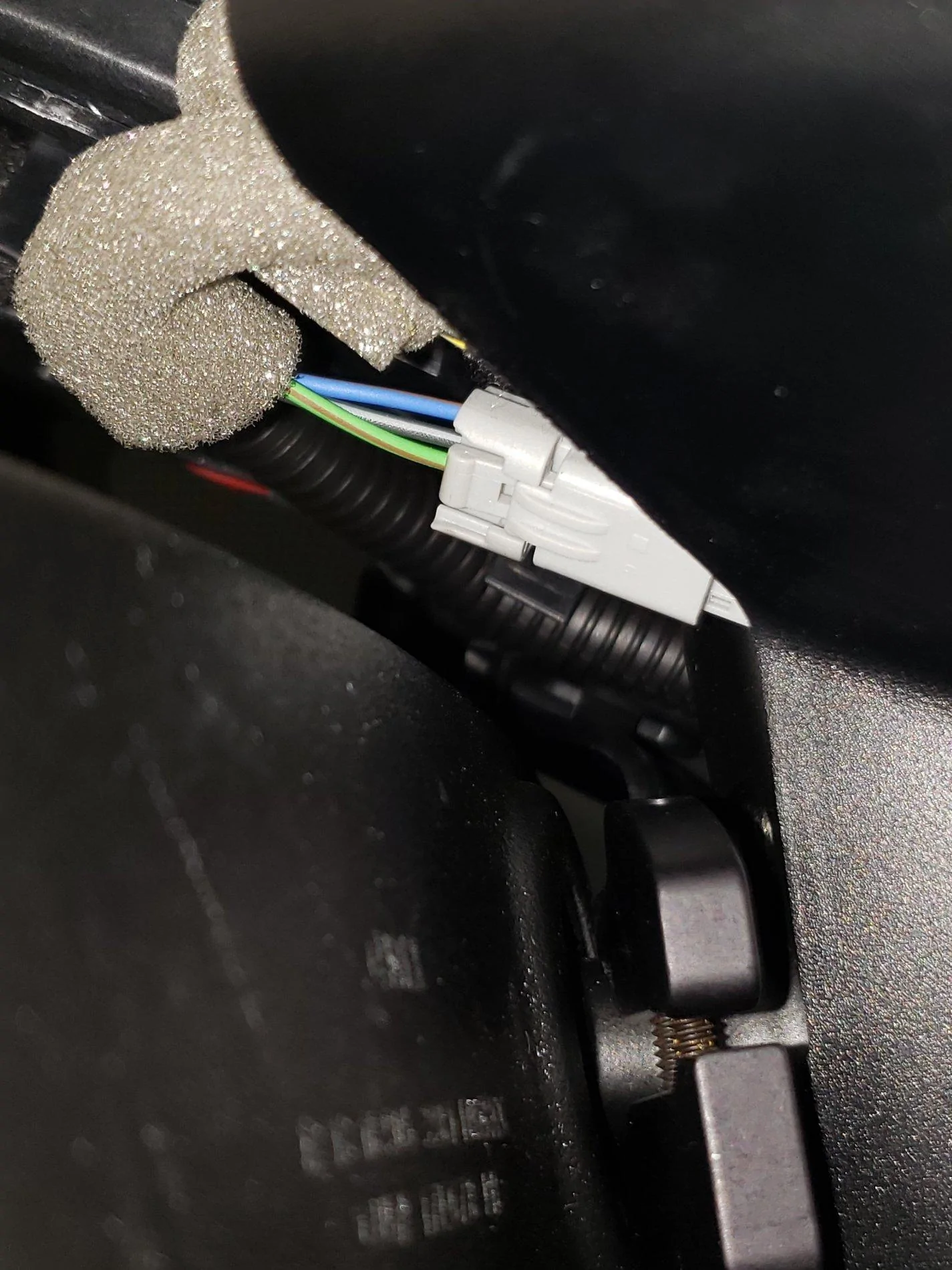

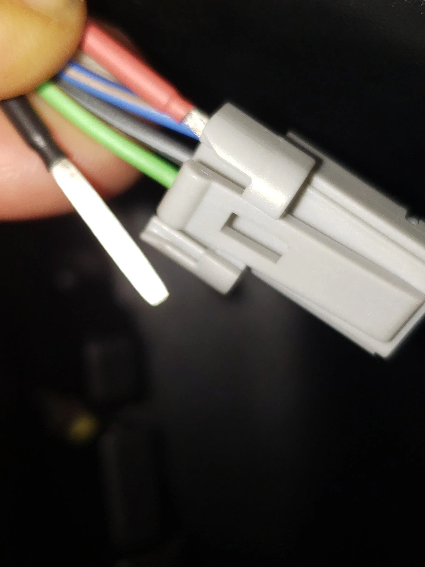

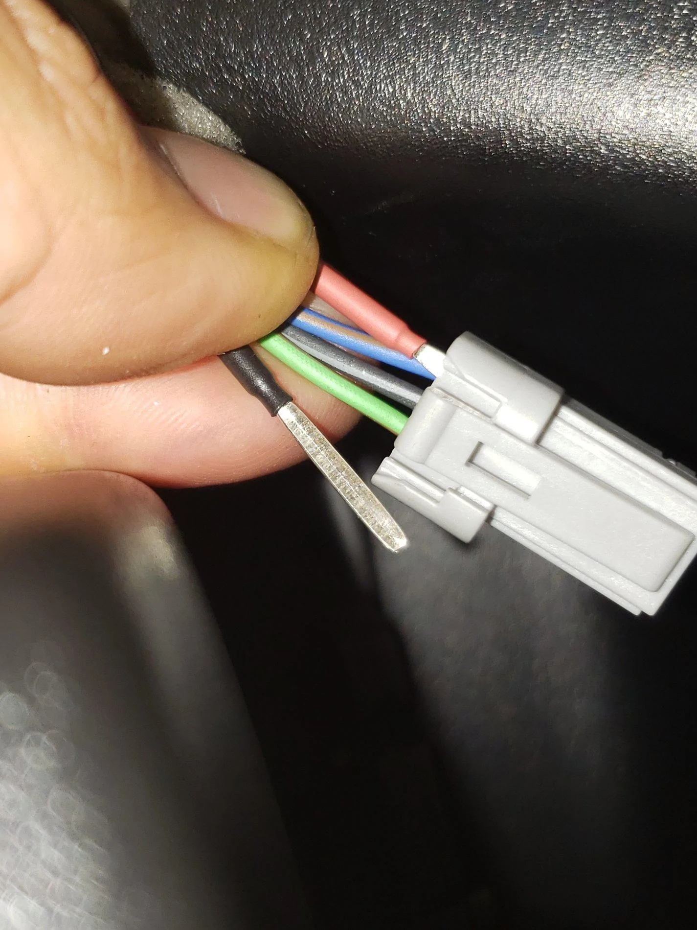

MirrorTap Installation:
  1. pull down firmly on the upper plastic housing
  2. locate the light grey connector (w/ 3 wires) and disconnect male & female (shot was taken before tightening Blendmount fully to stem. Don't flame me)
  3. Insert positive (red) wiretap below the Blue (switchable 12V) wire
  4. Insert ground (black) wiretap below the Black (ground) wire
  5. Heat shrink your connections
  6. I used a 5/32 bit to make an opening to route my cable through the plastic housing
Could I use this mirror tap to power a radar detector and a dash cam?

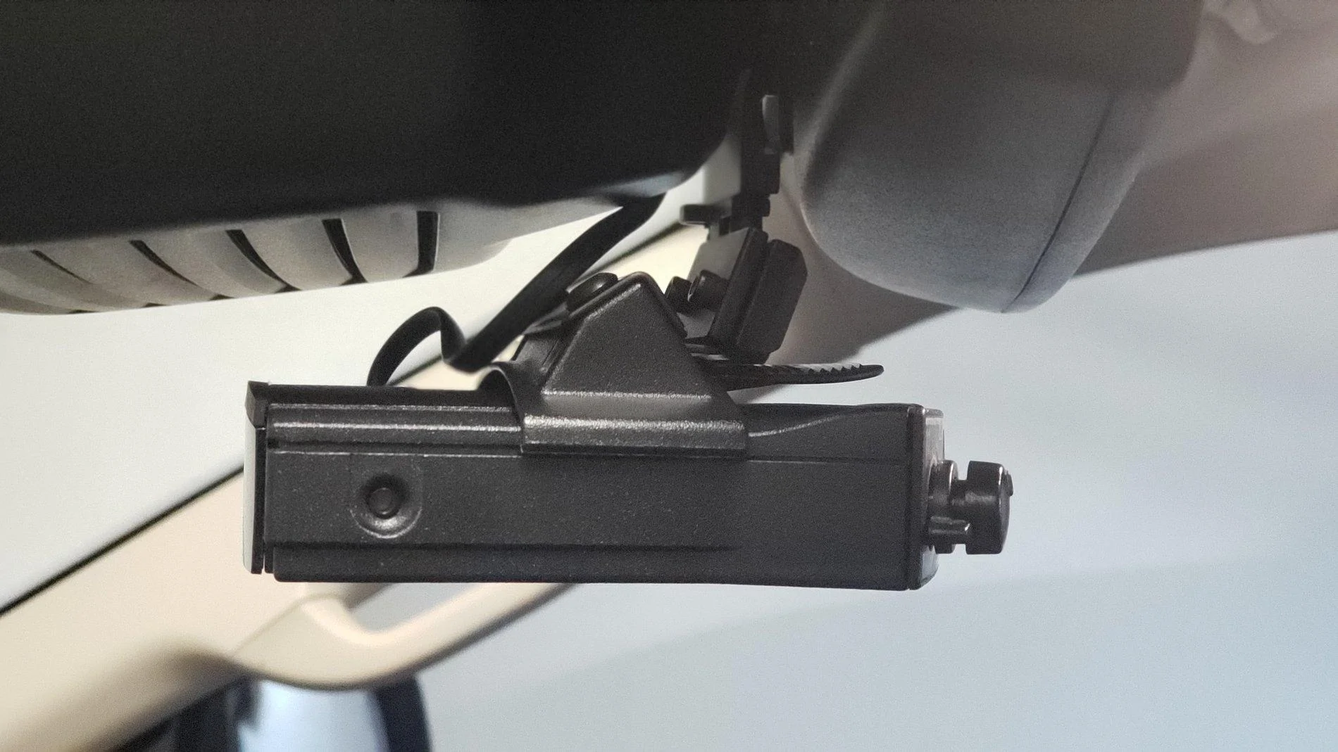

Found a Blendmount and Mirrortap in the mail tonight. Installation was pretty simple, with easy-to-follow instructions provided by the manufacturer. Everything took about an hour.

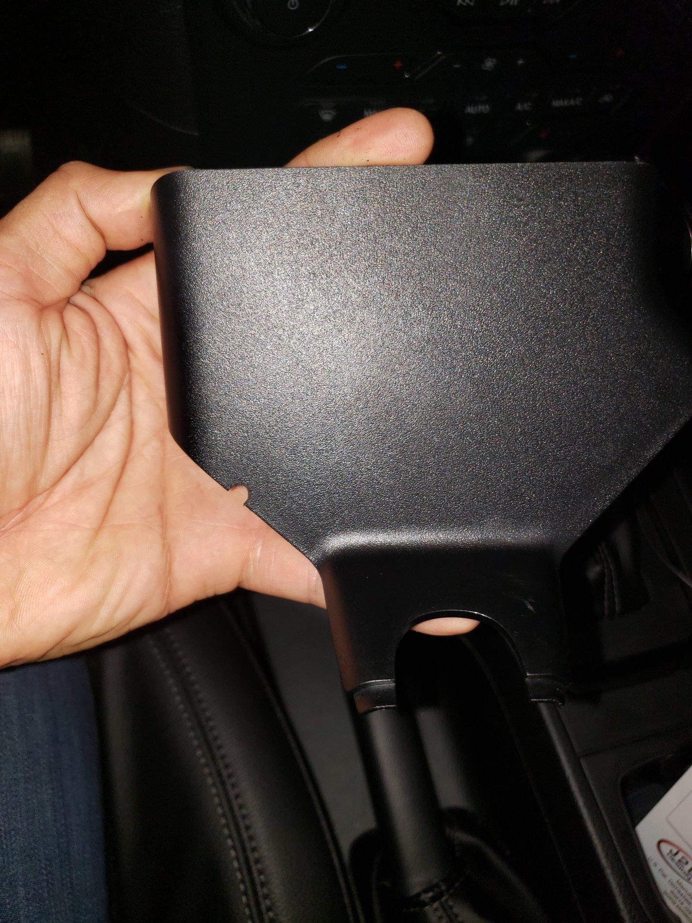

Have any of you removed the bigger plastic trim around the rearview mirror mount? Wondering how it comes off so I don't break mine.
I had mine off to install radar detector and it was very hard to remove also. I used plastic pry tools and pulled straight down very hard and it came down. I put silicone grease on it to reinstall.

Thanks for the reply. I actually got it removed before I read your response. That thing is very tight, much tighter than it needs to be. I can definitely see someone accidentally breaking the plastic attached to the windshield where that piece mounts to if they're not careful when removing.

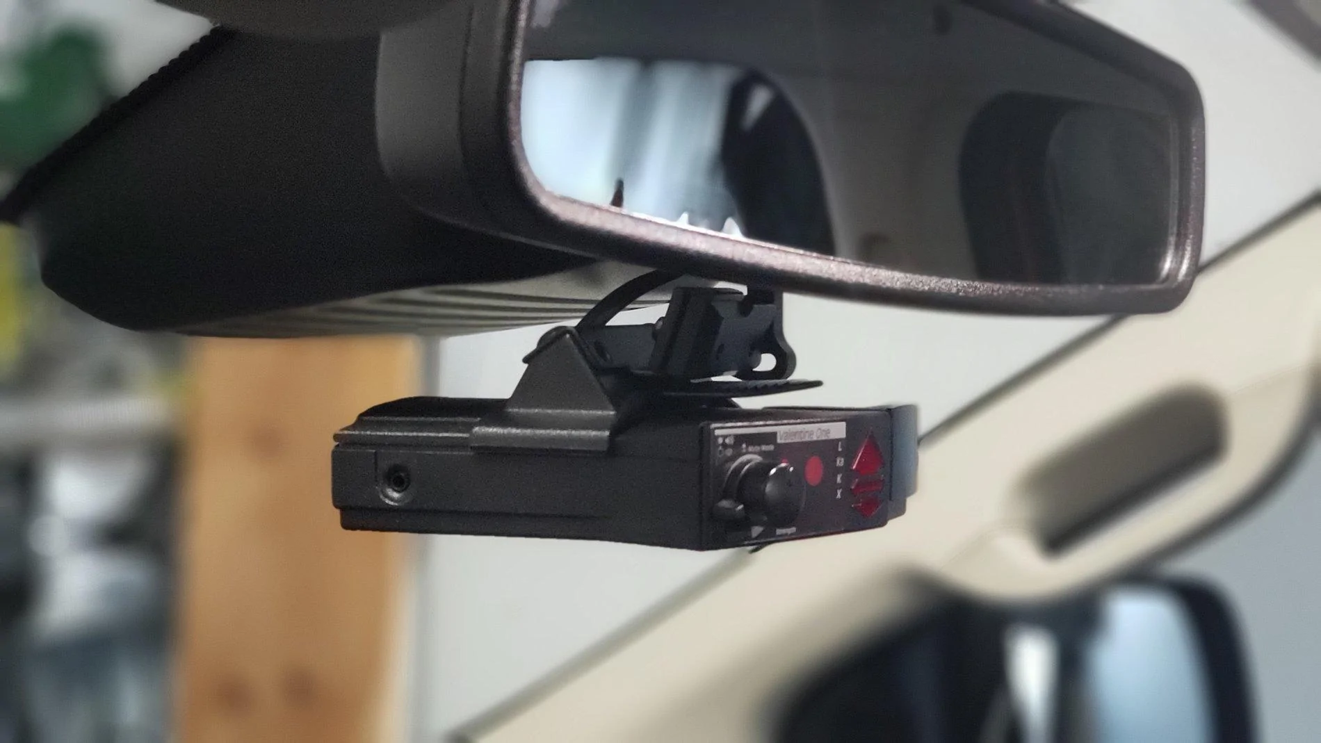

Just checked my email this morning. I'll be beta-testing a new Blendmount soon! :rockon:
Excellent write up for the mirror tap made it so easy. BTW would you please share the "blendmount part # u used for mounting ur Radar Detector as I have the same brand detector. The reason I am asking is that I do have 2 Blendmount laying around and if the part # is identical I wont have to spend $150 for another Blendmount.
TIA
BaGMaN
May 15, 2019
135
170
Arizona
2019 Ford Ranger Lariat
USAF Retired
TIA
check here: https://blendmount.com/vehicle-fit-guide/
they had to create a new mount for the ranger.

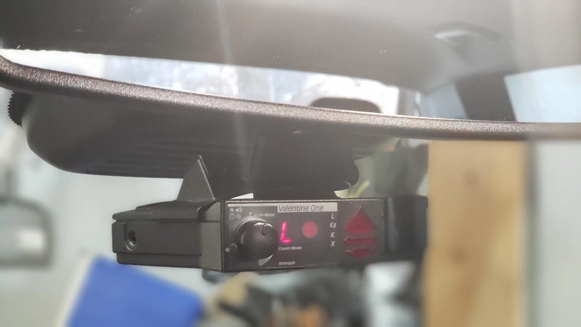

Blendmount BV1-5014 with Valentine 1 works great. Nice and close tucked up..
