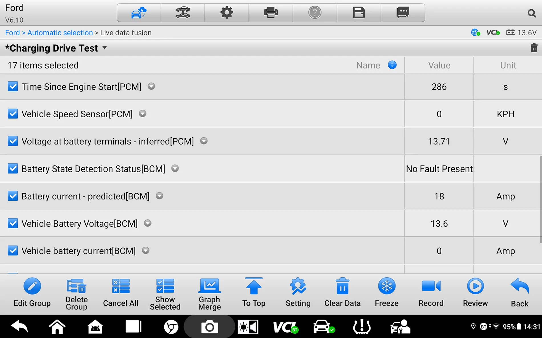

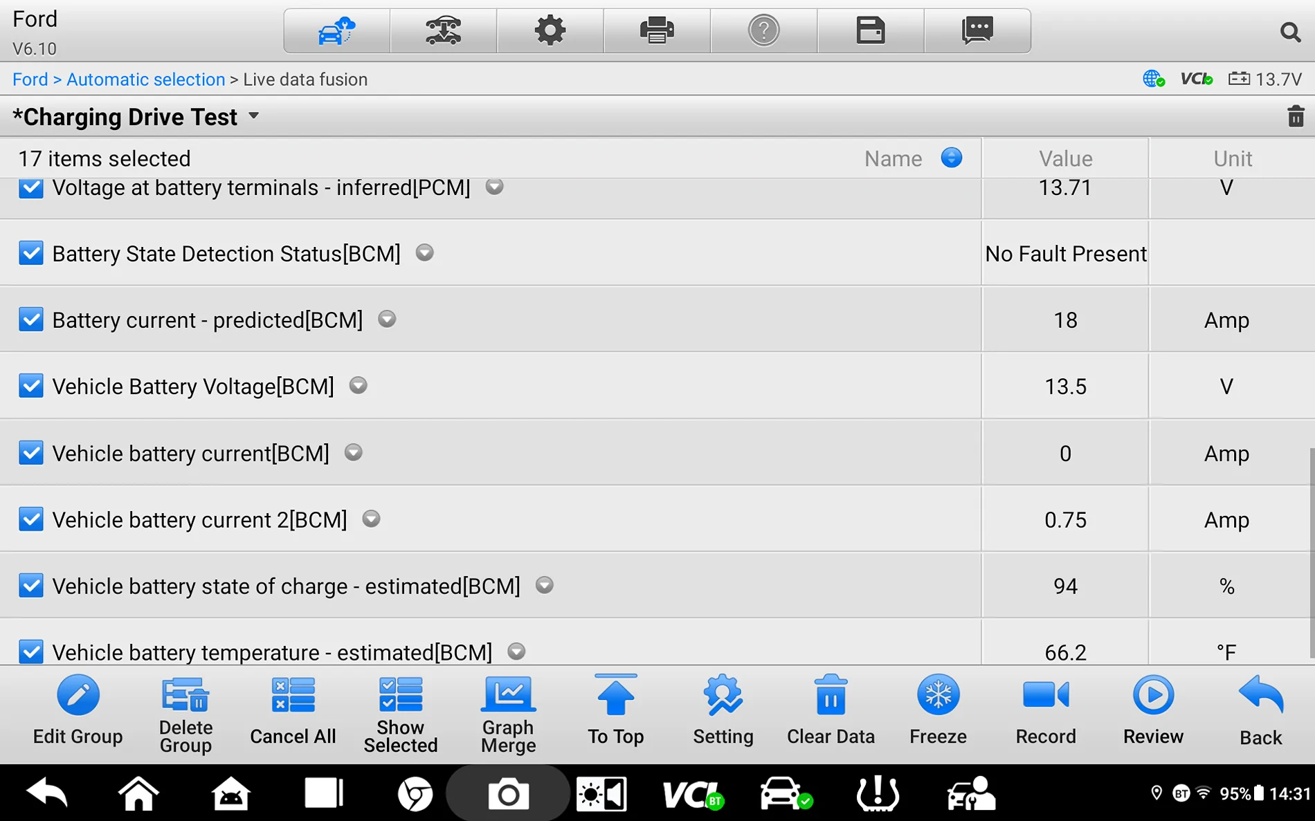

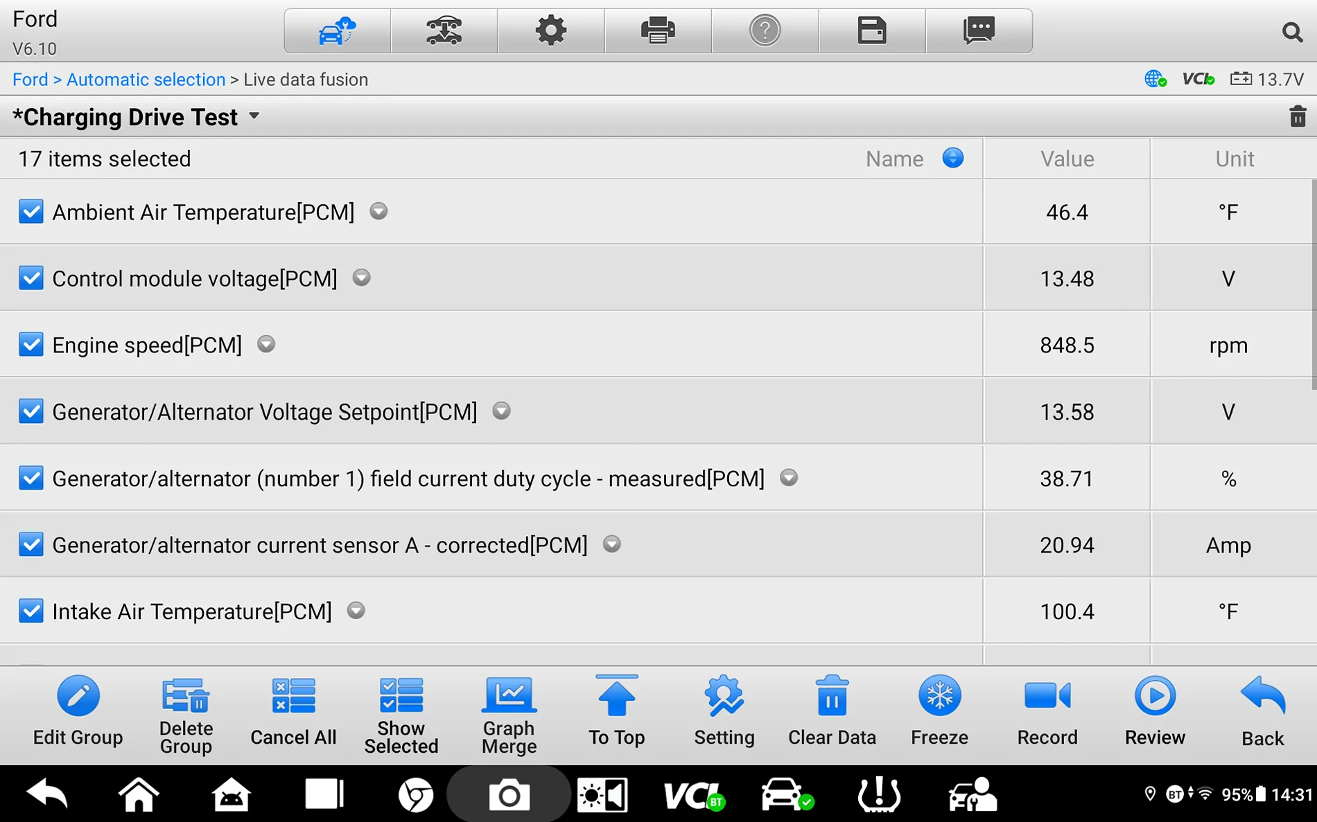

I have been monitoring my drives this past week, noted:
The lowest the SOC has dropped was 89%. and it is slow to - Rise
even though the Battey Voltage is 12.6 to 12.7 volts, the current charge shuts off - due to the voltage reading.
Plus, since I am at 90% SOC - Setting, I have noted (after my BMS Reset) that the Desired will drop sometimes to 12.7 or so - Lights Off
If I kick the lights on - It drives to the 13.5-13.7 Range - Desired and sometimes will kick in the 14.3 to 14.7 Range.
Noted it has been down in the teens (Temp) - parked in a parking garage (work) not heated but covered.
Noted that the Battery (Holds) Heat - as the Neg battery terminal - measures higher than ambient temp - even after sitting overnight in extreme cold - so the (Estimated Battery Temp - Reading is Correct - as I have verified with a - Thermometer.
Noted that the average is about 15 degrees higher than ambient, so this measurement is being taken after about 12 hours of sitting.
This shows that the battery does hold some heat (Charging - Heat) I assume.
The Following are Screen Shots of what I am monitoring on my drives - Recording Video
I snapped these while sitting Idle in the garage to show my current status as of today and after 1 week of monitoring.
Note: Before I started the engine and Idled for some time - as I was putting together some other PID Reference Data - The Ambient was 46.4 and the Estimated Battery Temp was 53.6 & Verified Correct by my (Therm)
Disregard the Speed at KPH - I forgot to change the (setting) back for my other PID References, before I took the Screenshots.
