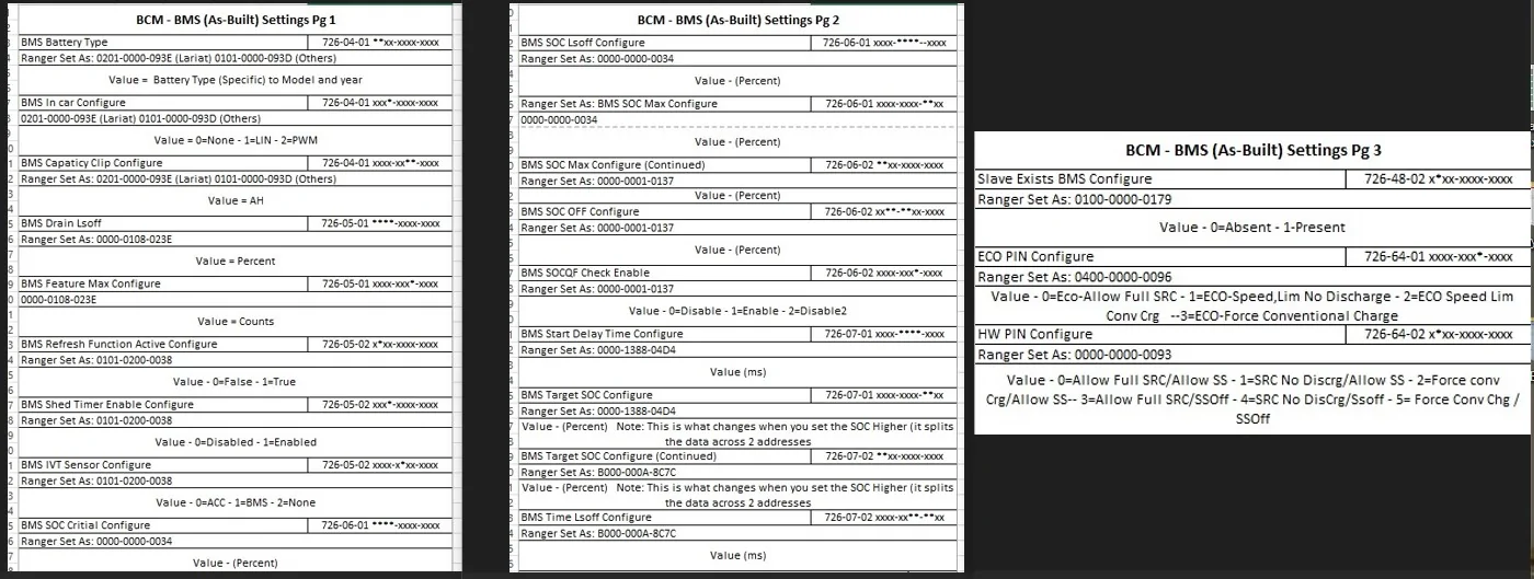

So, we need to dig into the BCM - As-Built files to find the reason the SOC is shifting even with it set to 90-100%
I know there are some other settings related to the BMS system that remain constant throughout all trims, and I will go through them and post so we can determine (what each one actually does)
This may (Highlight) what is happening (Program/Software-Wise)
Keep in mind that some of the As-Built files leave you scratching your head (What the heck Is this for?) as they are not always cut & dry explained

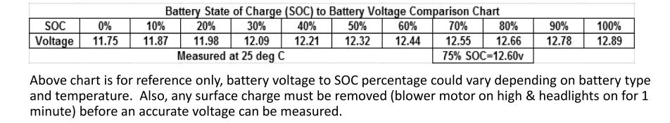

I think the SOC update is the sensor is reading (@ Rest) voltage on the battery and accounting for temp and battery age - The software (column counting) derives to an Estimated SOC
While driving you have a draw and the generator applying a charge, and how much the battery is being offset (Charge over the Draw) directly ties to what the BMS has as a (Estimated SOC)
even though you may have a fully charged battery the SOC may be reading lower as if it's under charged.

It is easy to validate this. All I need to do it change the target SOC with Forscan and see what ScanGauge reports.
I believe the "Estimated SOC" is possibly a derived target that is dynamic, based upon algos in the BMS Firmware. I can contact the ScanGauge Support folks and ask for the PID info to track it with ScanGauge. Their engineering guys are pretty good at delivering that information.
Agreed, but we may find there is not much we can do about it.

Here are the As-Built Addresses for the BMS, I only included the ones related to charging and battery.
I am curious what the ECO & Hardware PIN Config will do as well as the BMS Feature Max (Counts)
Which this is a prime example (BMS Max Configure) - Its hard-to-find specific information on what this is and there are many others like this within the databases that leave you (?) as what it is and there are a ton of abbreviations like (ex; Linsel - EXEEL and FEEL) I know the Linsel = LIN Select.
And I do not understand why we do not have (Public View) of the PCM Databases, I see some for other models but not the Ranger. Ok RANT Over:)
I should also add a FYI (Understand) that these lines are (Hex Data) and when you need to change something here - such as (Percent) you need to use a Decimal to Hex Convertor

I think what is confusing the SOC Reading (we are seeing-during the drive)
If I reflect back to my original dive into the system, I came across these 2 charts.
I suspect the SOC Reading we are seeing is relating to this chart:
This was a chart I found (Battery Under Load)
It may not be fully accurate, but I think that this MAY be what the sensor is reporting as we drive and see the SOC Climb.
Once we shut down - the SOC now has a new reading to (Calculate) @ Rest Voltage
This is the (Recalibration Cycle) to read the true voltage at the battery since it cannot provide an accurate reading during the drive (Charging)
Since: We are noting that the SOC is about 85%-88% or so @ just after start, this involves current draw on the battery (Door-Open) and (Drain from Engine Crank)
The BMS sensor reading would be (Displaying) the SOC it obtained from its last (Calculation) check which would have been during the sleep period (Rest)
I feel the above is what we are seeing, regarding the SOC, and the system is using the (Overnight) SOC as a reference to 100%.
I am trying to explain it, so it makes sense, the longer you drive the SOC will climb as its sampling the voltage periodically - so it's using the (Under Load-Chart) and may be the reason for it tapering off the charge to (0-Current)
It's not using the (Engine Off-Open Circuit Voltage) as its reference to 100% SOC
I may be incorrect here, but it would possibly explain - the SOC inconstancies and variations we are seeing - (During the Drive) and it's also about the time frame (on how often) the BCM sends a request for updated information from the (BMS Sensor) for the SOC Factor.
We know that the (Current In/out) and voltage readings are always live data.
I think the SOC factor is different.
And if we were to check the battery voltage with hood opened and latch closed - the battery voltage would match with the SOC chart 88% or so prior to opening the doors etc, and it drops to 12.1 or so.
Opinions on this welcome
