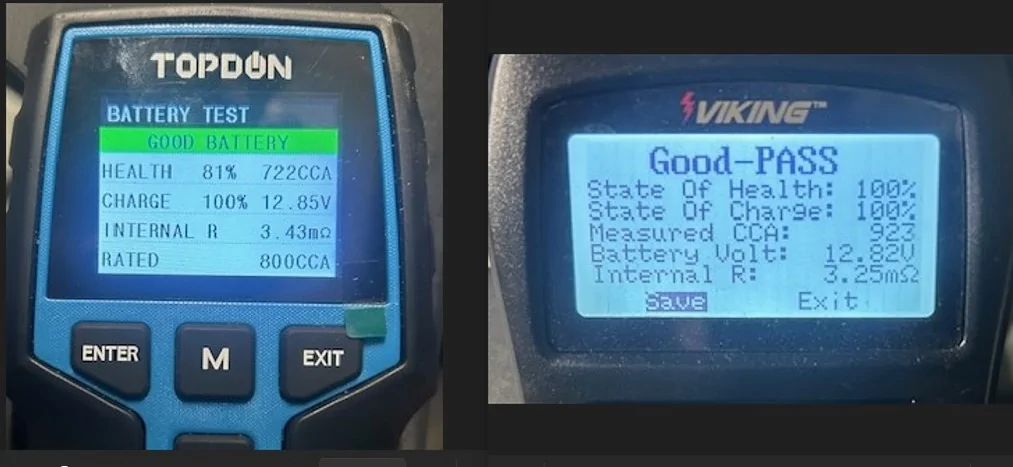

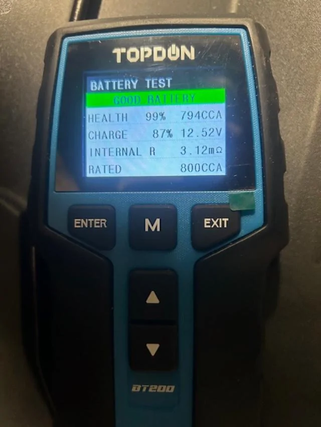

OK - I went through the PDF (Revised)
First - The Ranger does not have a SOH nor a Battery IR (PID) - at least with 3 scan tools plus Forscan. Forscan still will not display SOC, but other scan tools will.
I do not remember if FDRS displays that PID
The SOH can be displayed on the battery testers, now the Viking shows truly unobtainable numbers, but the Top-Don I believe shows the most accurate and true readings for the test.
SOH is derived from the IR of the battery.
The Lower the IR the Higher the SOH which in turn shows a higher CCA available.

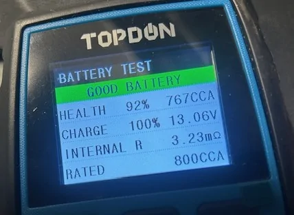

So, with the Battery Tester we can prove that a 92% SOH is obtainable on a 3 yr Plus Battery
Test Taken just after a charge and headlights (ON) surface charge removed.
For me the most accurate is the TopDon Tester.
So, we can prove that a High SOH is obtainable, but it requires (periodic) external help - I just completed a Charge plus Repair Cycle
Since we do not have a SOH (PID) as called out in the PDF, I believe that the BMS System (BCM) is using the SOC & SOH as detailed (VERY DETAILED) algorithm formula. although we cannot see the actual SOH (PID) we can see the (SOC) and charging voltage changes with the Gen Duty Cycle and Gen Output (Amperage) as well as the Battery (Current In/Out)
SOH:
So, the way I understand it and can actually see it if monitoring the Duty Cycle. I can see small bumps in the cycle - This would be what the BMS sensor is seeing - those small bumps and it's measuring how well the battery can absorb the fast current bump, though the battery voltage reading.
Noted PCM PIDs in the PDF are not correct for the Ranger

But the (SOH) amazed me
This by far the best SOH reading I have ever seen, granted this is fresh after a recent charge, need to do some drive cycles and see if it remains.

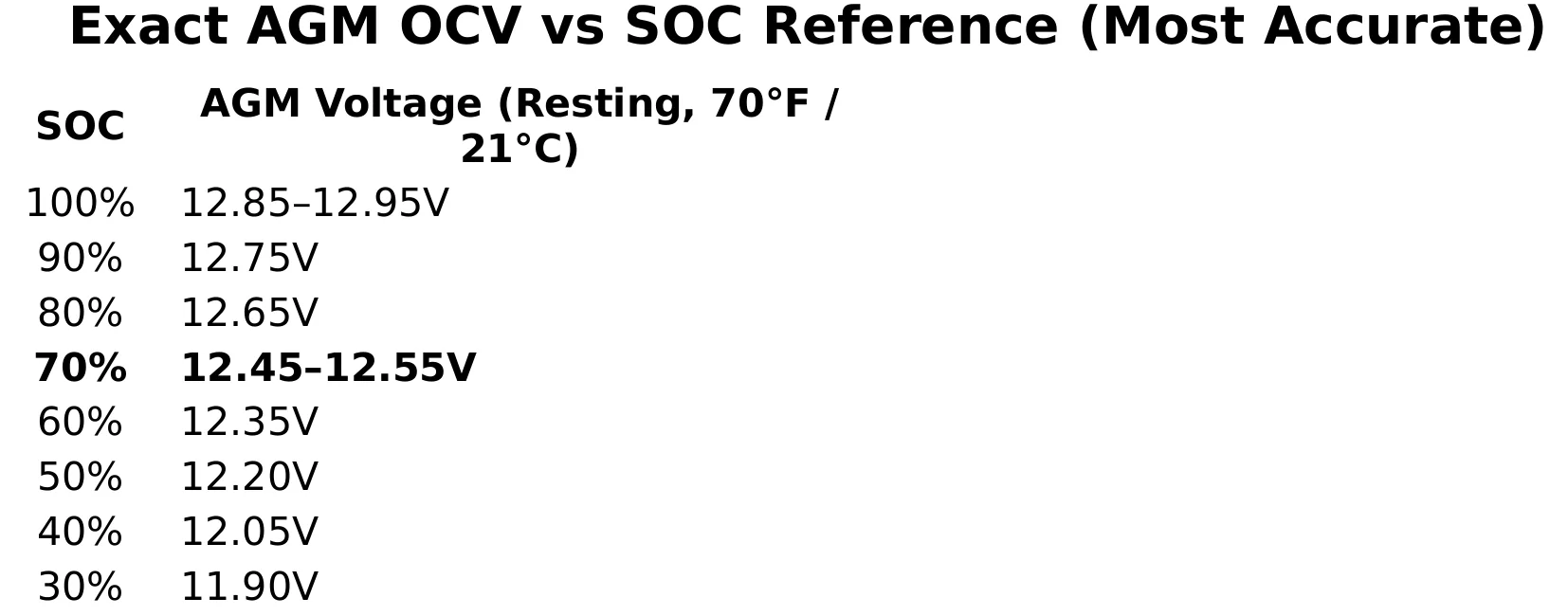

So 100% SOC = 12.6v - 12.8V (based on the table). This seems to be the perfect charge to the best of my knowledge.

So, what this tells me is that the SOC (Set) @ 90% equals 12.71 Volts the same as the charts show.
90% of the Target that we set in ForScan? So what you are saying is that Setting your SPC at 80% in Forscan actually results to 12.71V at the battery terminals when SOC = 100%. Am I understanding correctly?
BUT what we are reading (MAY) be read as 99% SOC actually equals 99% of what we have as (SET) per my test this is my conclusion as 100% SOC for my test equals 12.71 Volts which is my setting of 90% SOC.
90% is actually 12.75V, but may be close enough. due to aging , resting state, and temperature, etc.
Is this the table that you a referencing?
