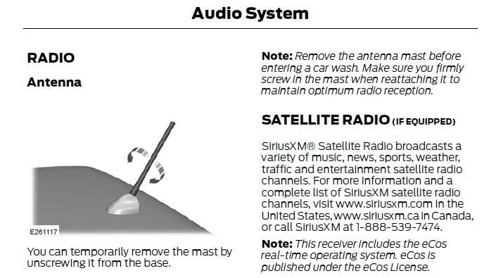

Not sure if someone post about this but I was reading the owner manual on SYNC 3 and spotted this on page 348!
"Note: Remove the antenna mast before
entering a car wash. Make sure you firmly
screw in the mast when reattaching it to
maintain optimum radio reception."
Well thanks for the warning in page 348!

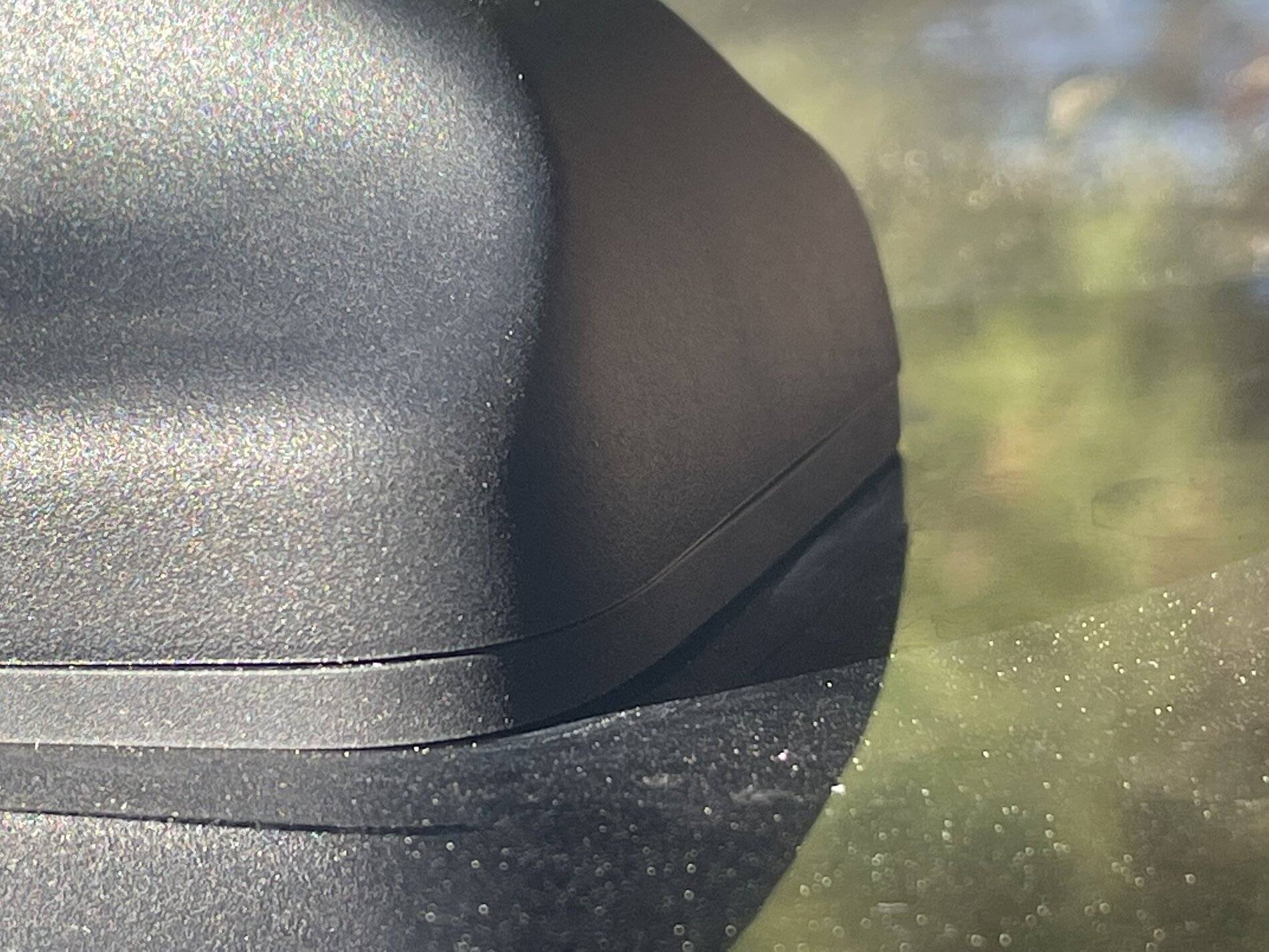

The antenna is back on, but it's not sitting flush, there is only so much you can tighten the screw. Any suggestions on how to close the gap?
AdamHarris
Adam
Feb 26, 2021
1,740
4,919
Blue Oval City, TN
Collision Repair Instructor
Roof metal is slightly distorted from antenna violently pulling out. Easily and carefully push down on dorsal fin to try to relax the metal until the gasket is touching. Push lightly several times, check, repeat as needed.
