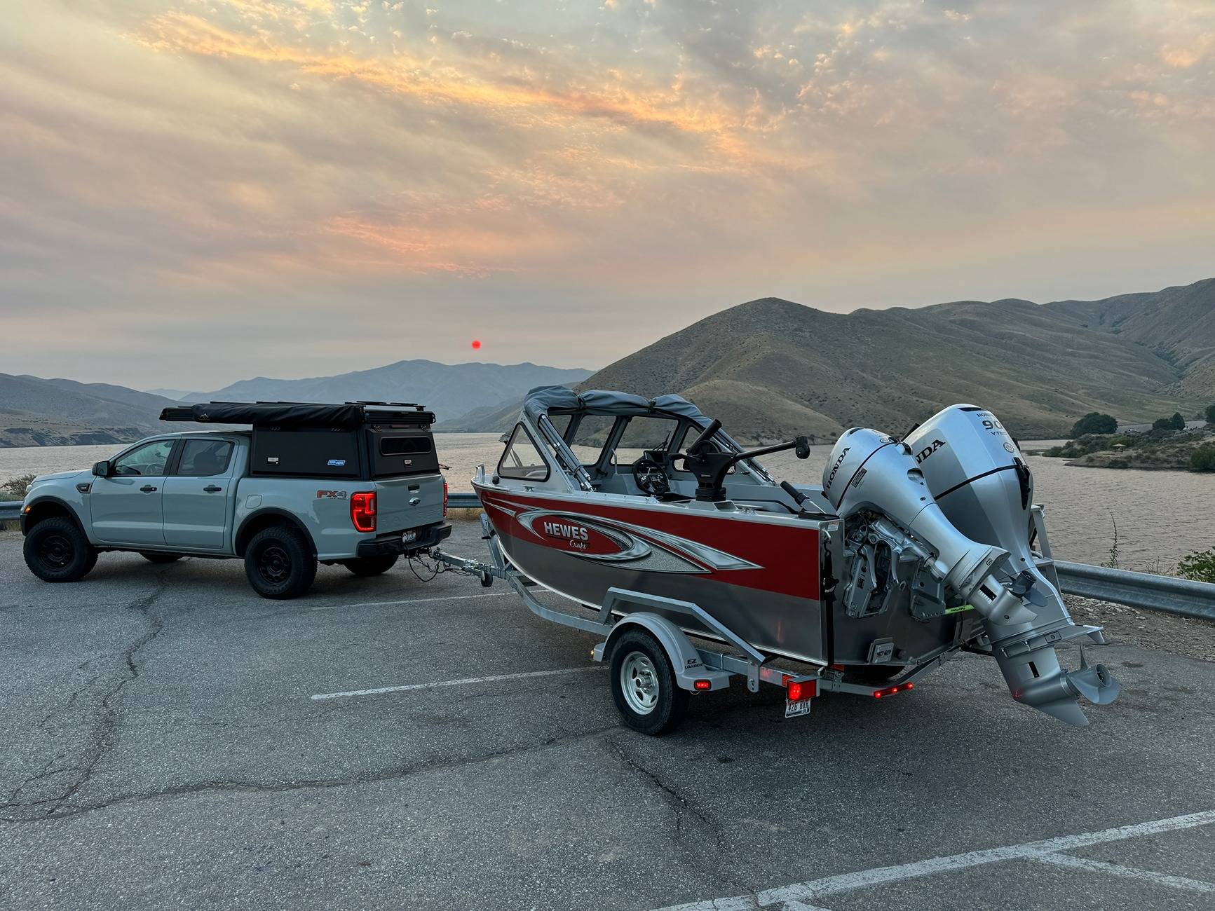

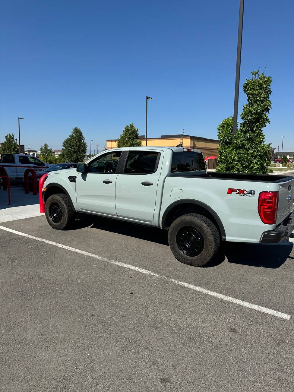

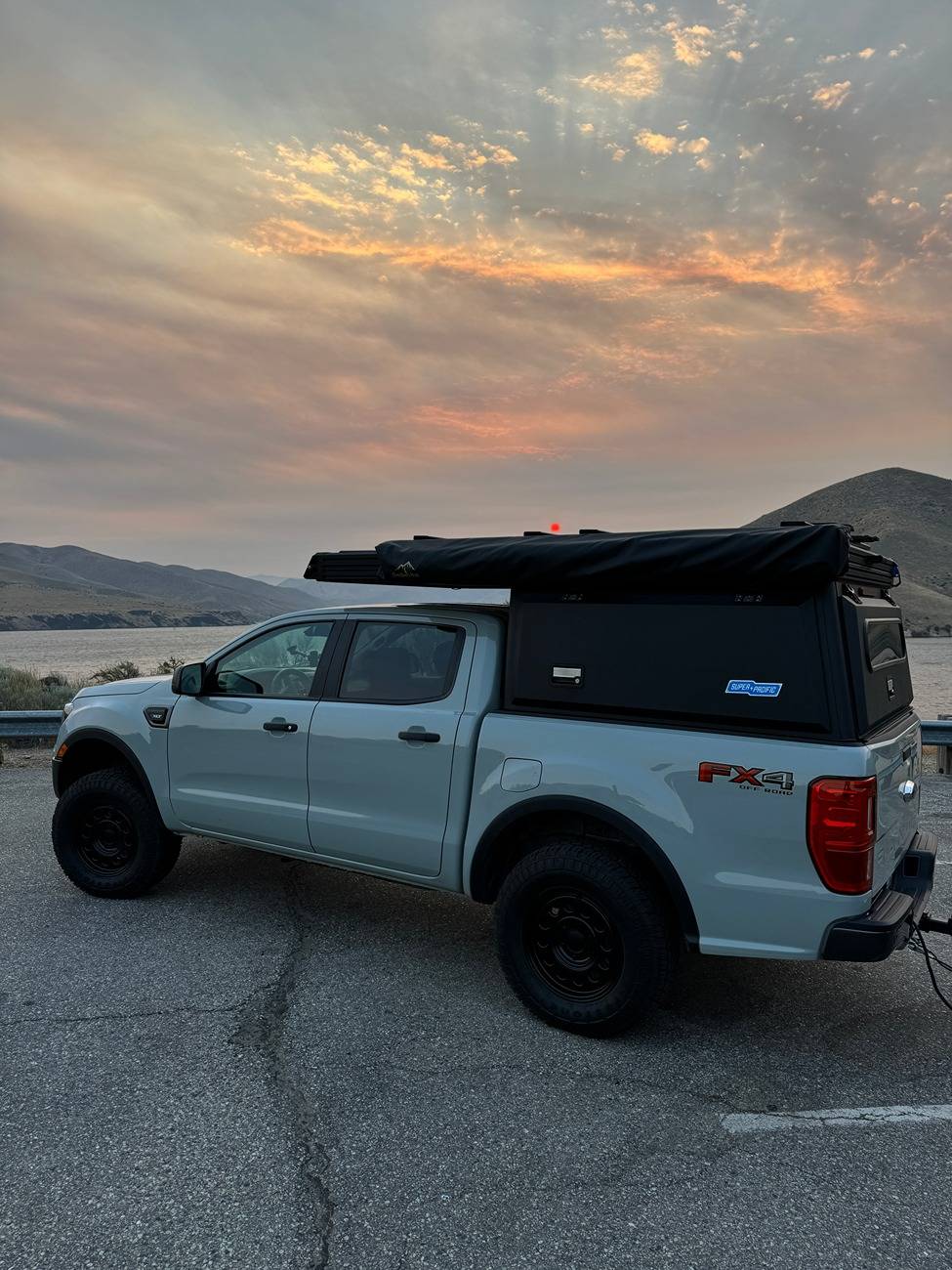

I installed the Bilstein 5100 and set them to 1.8 (slot #4) and have been extremely happy with the results. Shock Surplus has them on sale for $499.
You know the rules. We need pics!!
