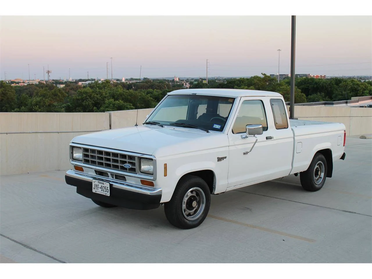

Wondering if dual fuel tanks are a factory option on current T6 Rangers in other markets? The 1983-1988 North American Rangers could be ordered with dual fuel tanks on Supercab and LWB versions. 14.5 gallon tank in the front and a 13 gallon tank in the rear. 1988 Ranger depicted.
