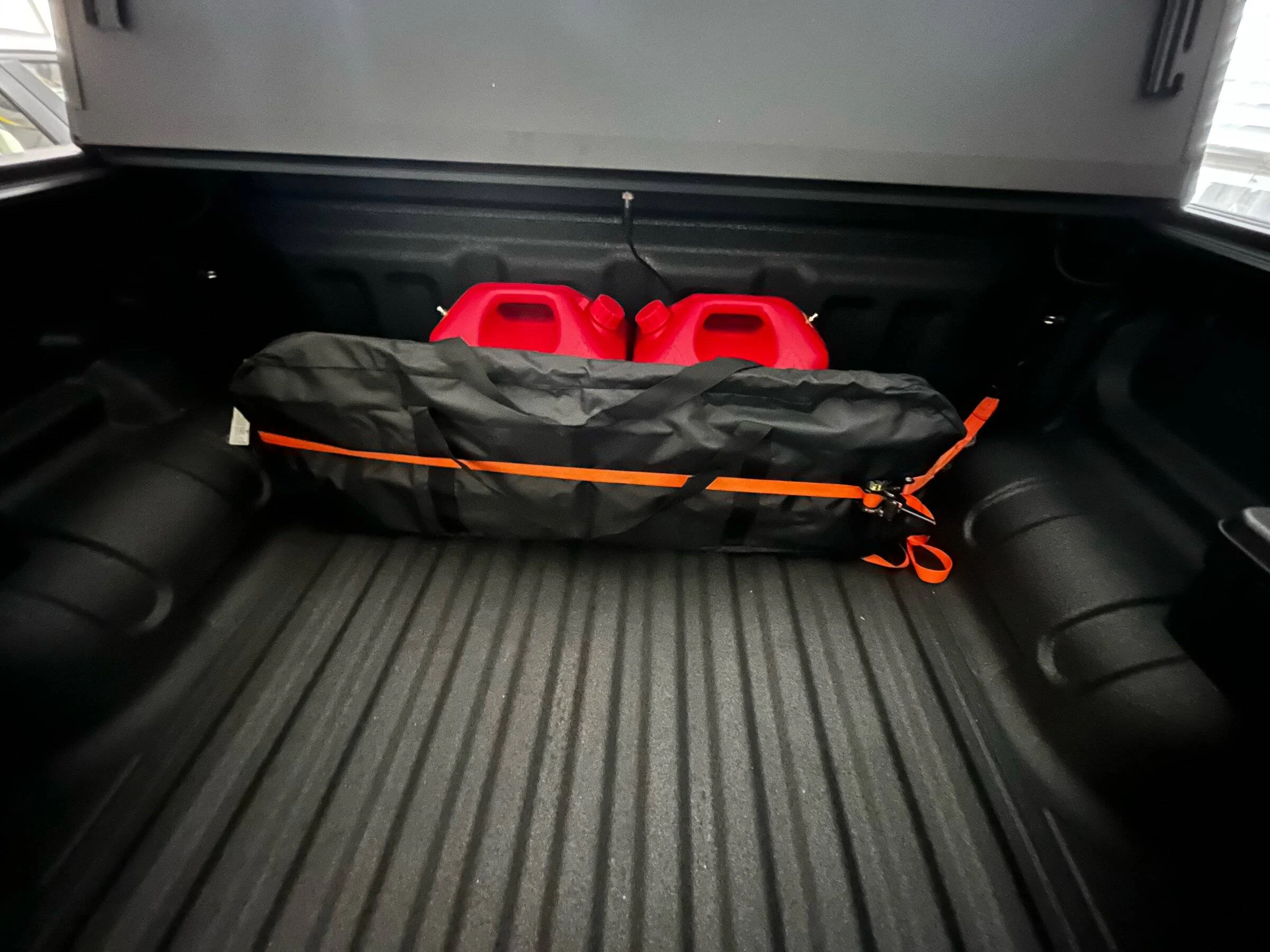

I just use 2x 5 gallon Jerry cans ratchet strapped to the bed headboard along with my tool box. I have a spout that fits the capless filler so no funnel needed, and I added metal positive lock vents to the cans. 10 gallons is plenty of emergency fuel for my needs and only needed when in the desert as my bladder can only last 4 hours at a stretch in any case.

I don't have them loaded at the moment, but here is what I have, I also added 2X eye hooks to the extra holes in the front of the bed for the ratchet strap.
Vents - https://www.amazon.com/dp/B07ZT3GPKR?psc=1&ref=ppx_yo2_dt_b_product_details
Spout that fits capless filler - https://www.amazon.com/dp/B07S42B8T9?psc=1&ref=ppx_yo2_dt_b_product_details
Can caps to replace the stupid nozzle that calif requires - https://www.amazon.com/dp/B0834F71BK?psc=1&ref=ppx_yo2_dt_b_product_details
Cans - https://www.amazon.com/dp/B0007M4VRO?psc=1&ref=ppx_yo2_dt_b_product_details
This works well, and only when I need it, and at a fraction of the cost of a built in tank. There are other options that are good, like the above deck marine tank, but it is not portable when filled, and I wanted something I could easily take out if I needed the bed space.
Here is a photo, the traction boards work well to give added protection to the cans, I didn't go with the tall military type cans as I have a bed cover.
