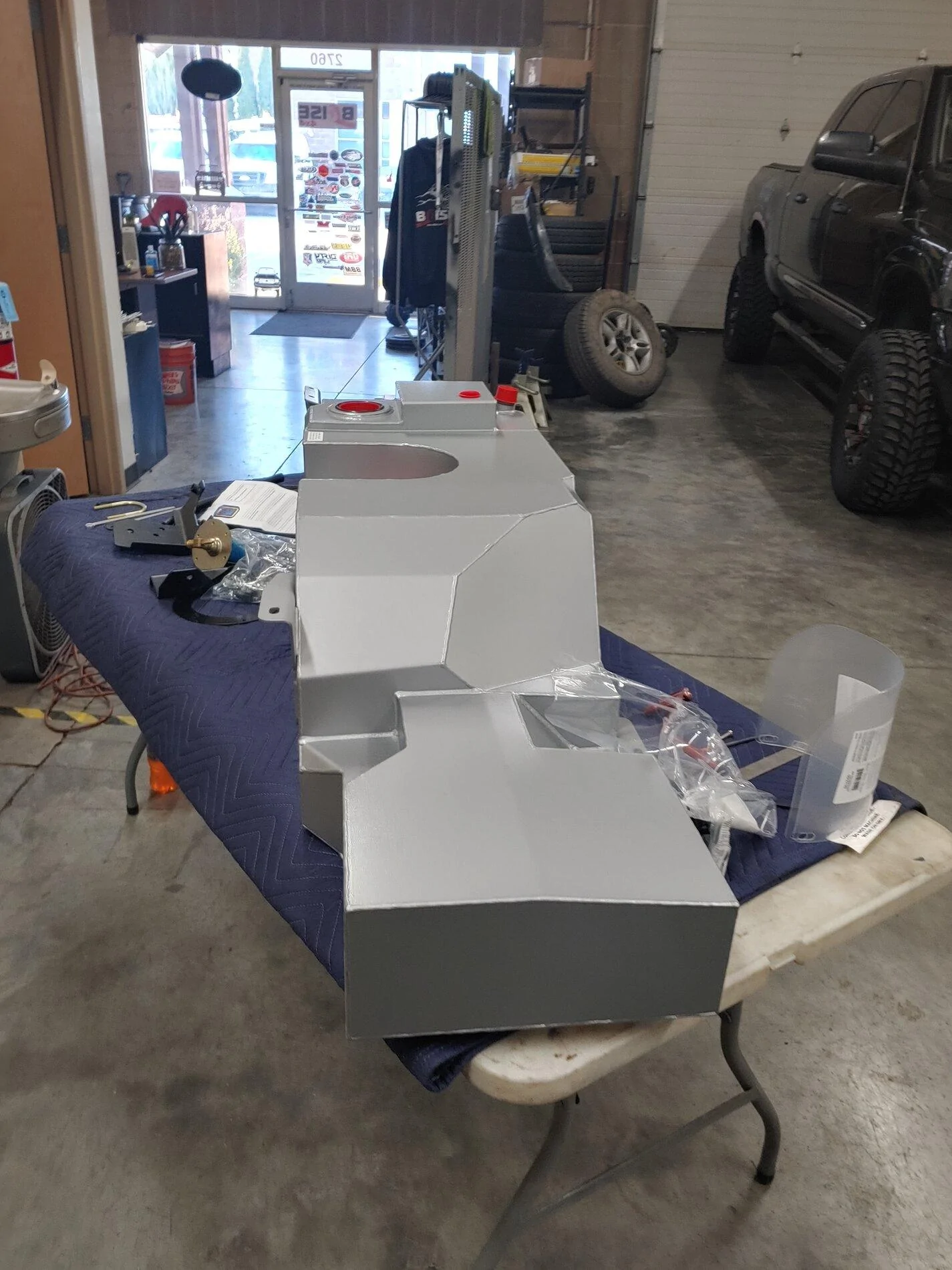

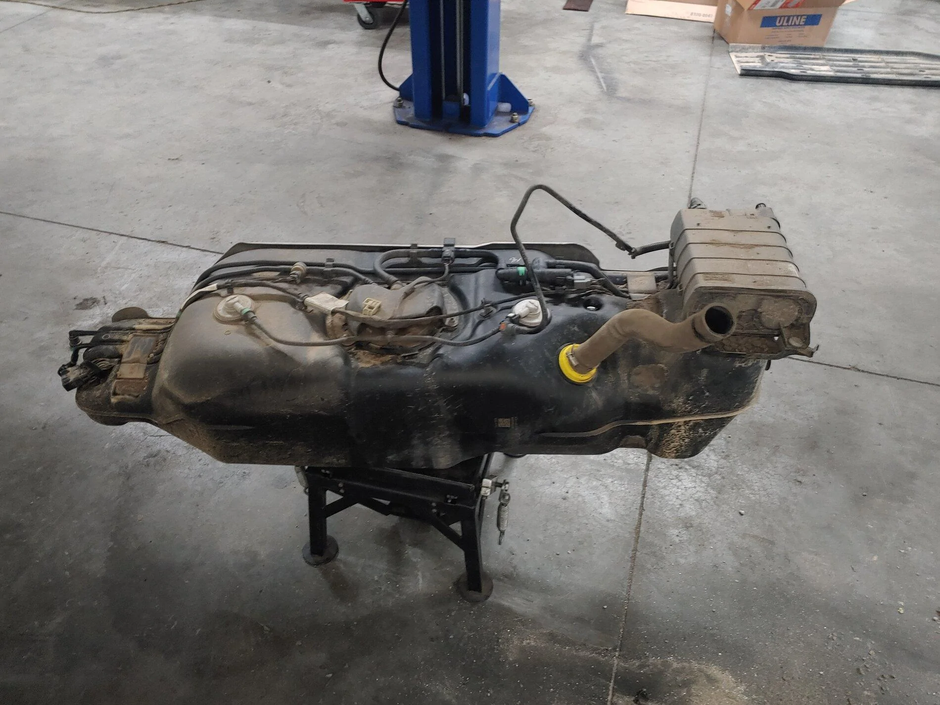

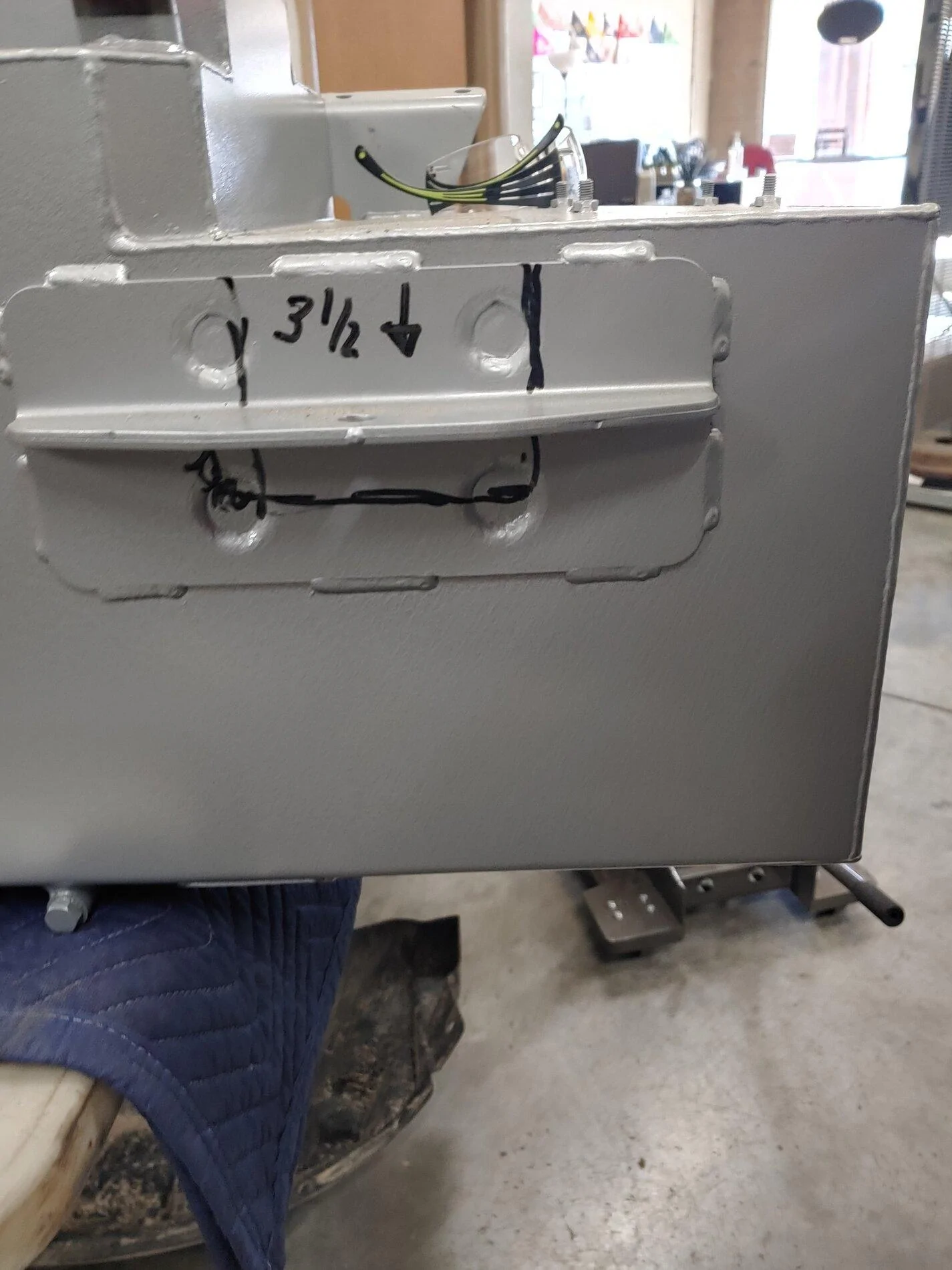

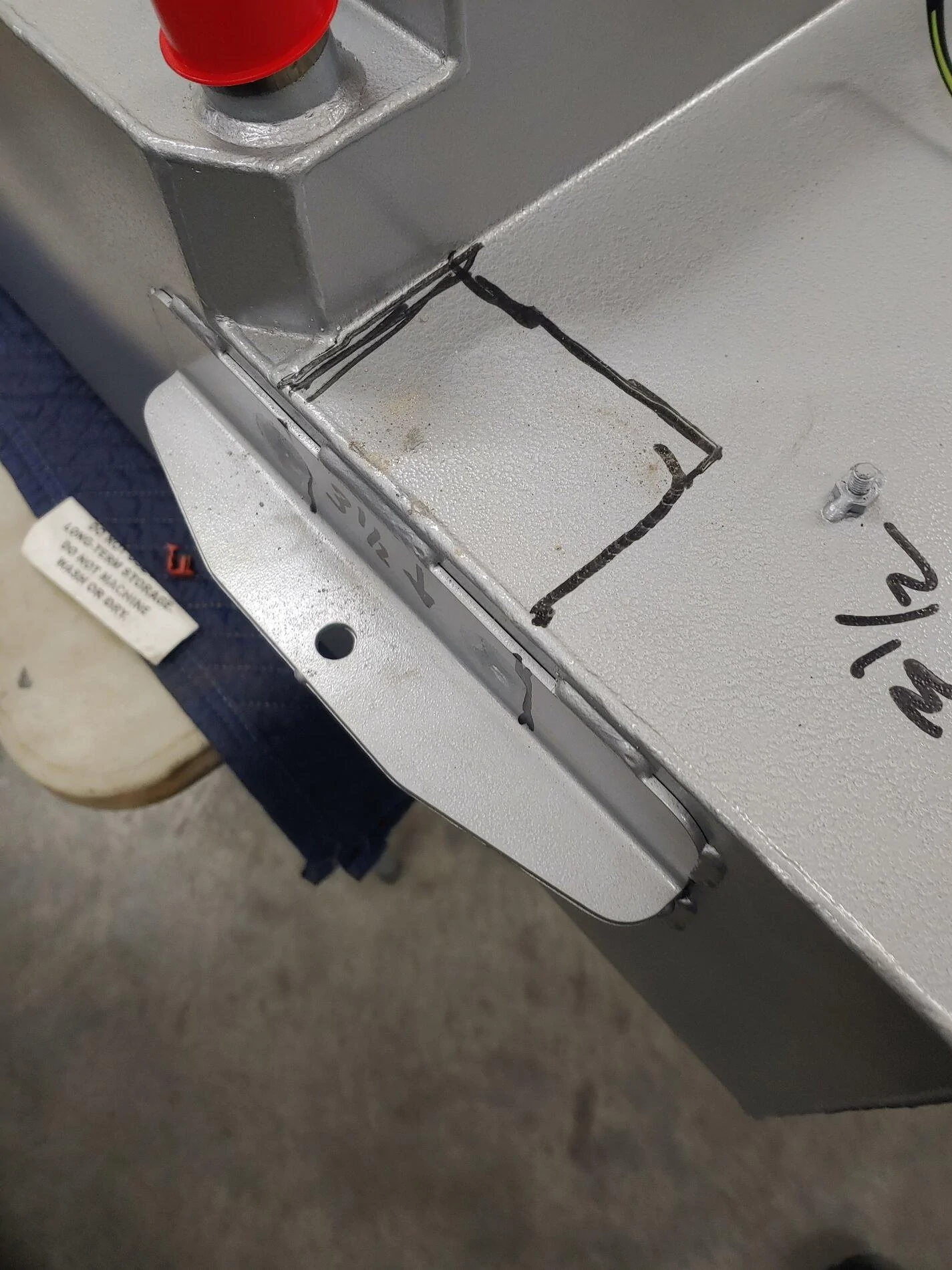

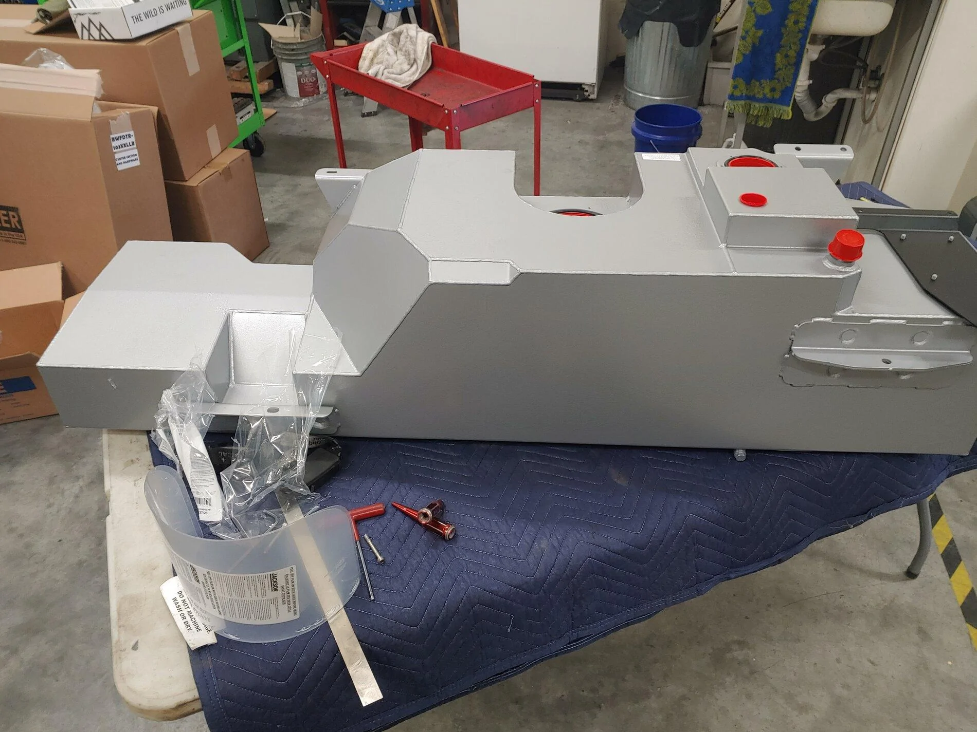

Soooooooooo..............
Good news and bad news........ The tank looks beautiful!!!! But it does not fit yet............
There are more differences between the AU to US market Rangers than predicted but it is vey close.
Two mounts need to be re configured. After that we will be in business!! How long until the corrections are made? I have no idea.
So you guys have an idea here are some pictures of the tank including one of the areas that need to be modified
