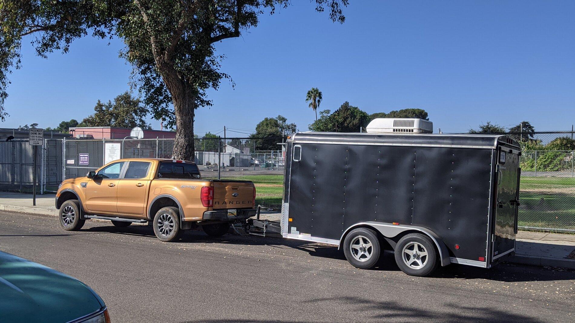

How much weight are you pulling that you get less than 10 mpg?
All in, about 4500-5000 pounds. But I do it at 70mph. My trip computer told me I averaged 11.5 out and back to California. We know how that thing lies. But MOST fuel stops were somewhere around the 20 Miles to Empty mark, and the truck normally took about 16 gallons of gas when I did. This thing has a LOT of spare fuel below Empty.
18ish gal tank taking 16 gal to fill. 11.5 mpg. 2 ish gal at 11.5 is not much past the 20 mile to empty calc. I wouldn't call this a LOT of spare fuel.
