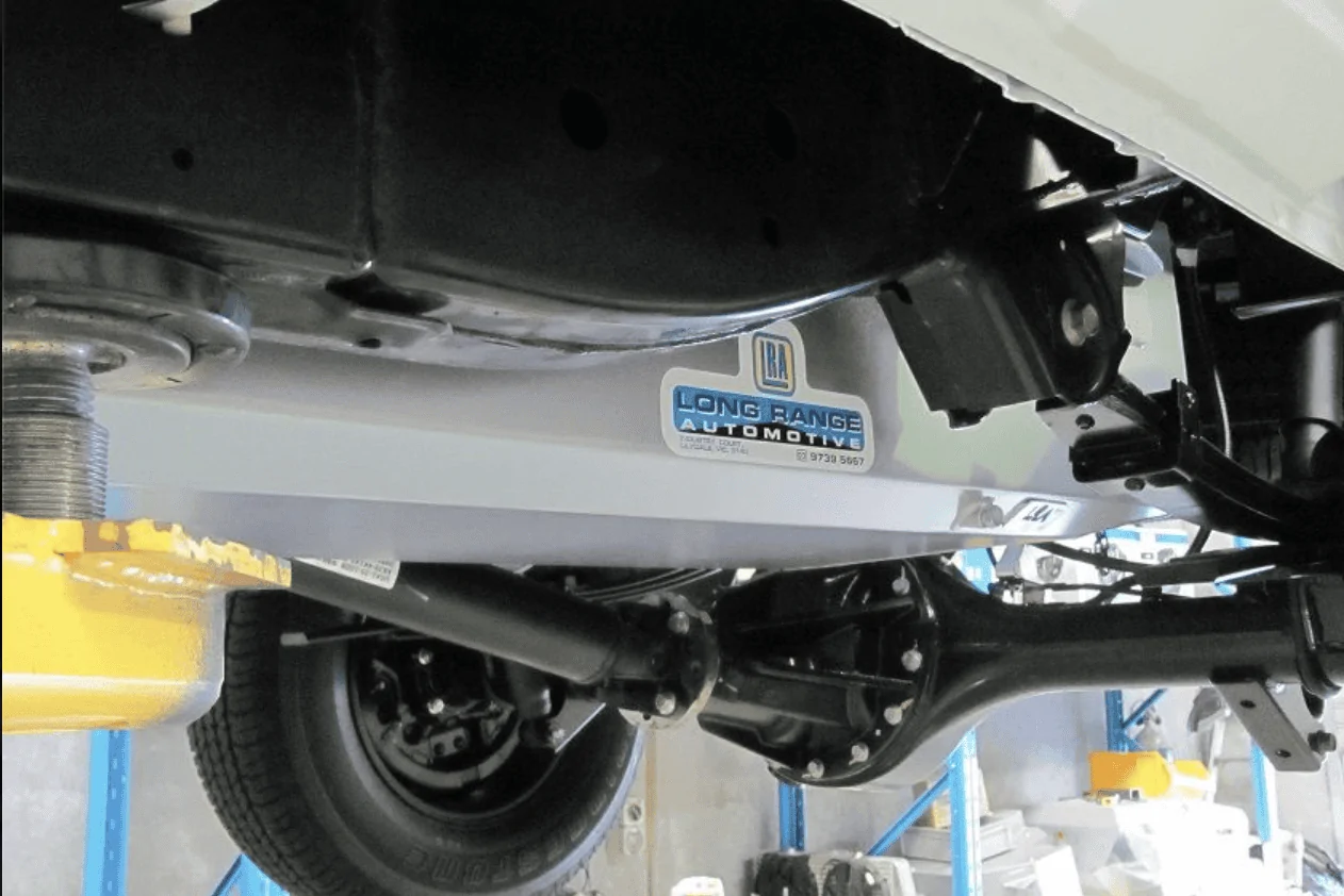

North American Distributor of Steel Fuel Tanks and Rear Bumper Systems from Australia

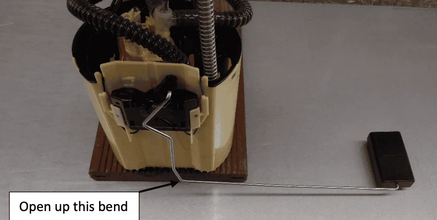

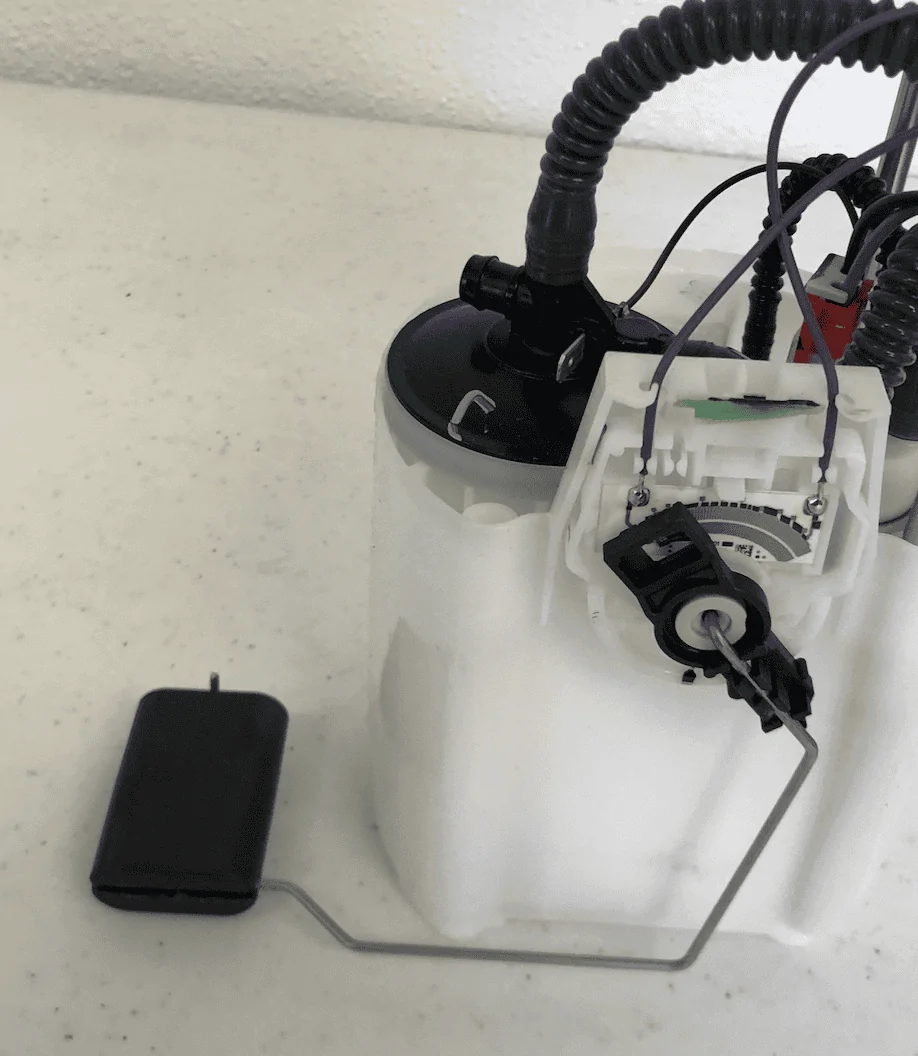

Hi Ward,
First let me state I am not interested in a longer range tank but I am a bit confused on the fuel pick up point. How do you take advantage of a deeper tank unless the fuel pickup point with its associated filtering is extended?
best,
Phil Schilke
Ranger Vehicle Engineering
Ford Motor Co.. Retired
Phil -
Thank you for your courteous and professional post on the thread's primary topic.
As you know, the diesel and petrol Rangers vary in a number of ways. One of those is the charcoal canister (none on diesel), fuel pump, sending unit, fuel feed point, etc.
Now that we have factory fuel pump/sending unit and charcoal canister on the ground in Australia, our partners will figure out how to accommodate the emission filter, fuel pump, sending unit and fuel pick-up point.
Installation of the Long Range Automotive diesel replacement tank requires that the sending unit float arm be bent slightly to accommodate greater arc resulting from increased depth of the new tank. See Image A below. The US fuel pump assembly is seen in Image B.
Apart from DTE, the fuel pick up, sending unit and dash gauge will all work correctly.
Our partners have been doing this work for 30 years and its all they do, so they have gotten quite good at it.
Thanks for your interest. More to follow.
Ward Harris
PS - Lest a reader ask, we have no decisions made on capacity, clearance, etc. but you can see the AU spec diesel tank in Image C.
