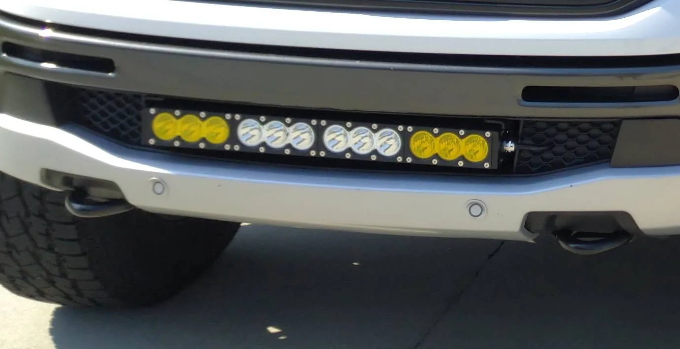

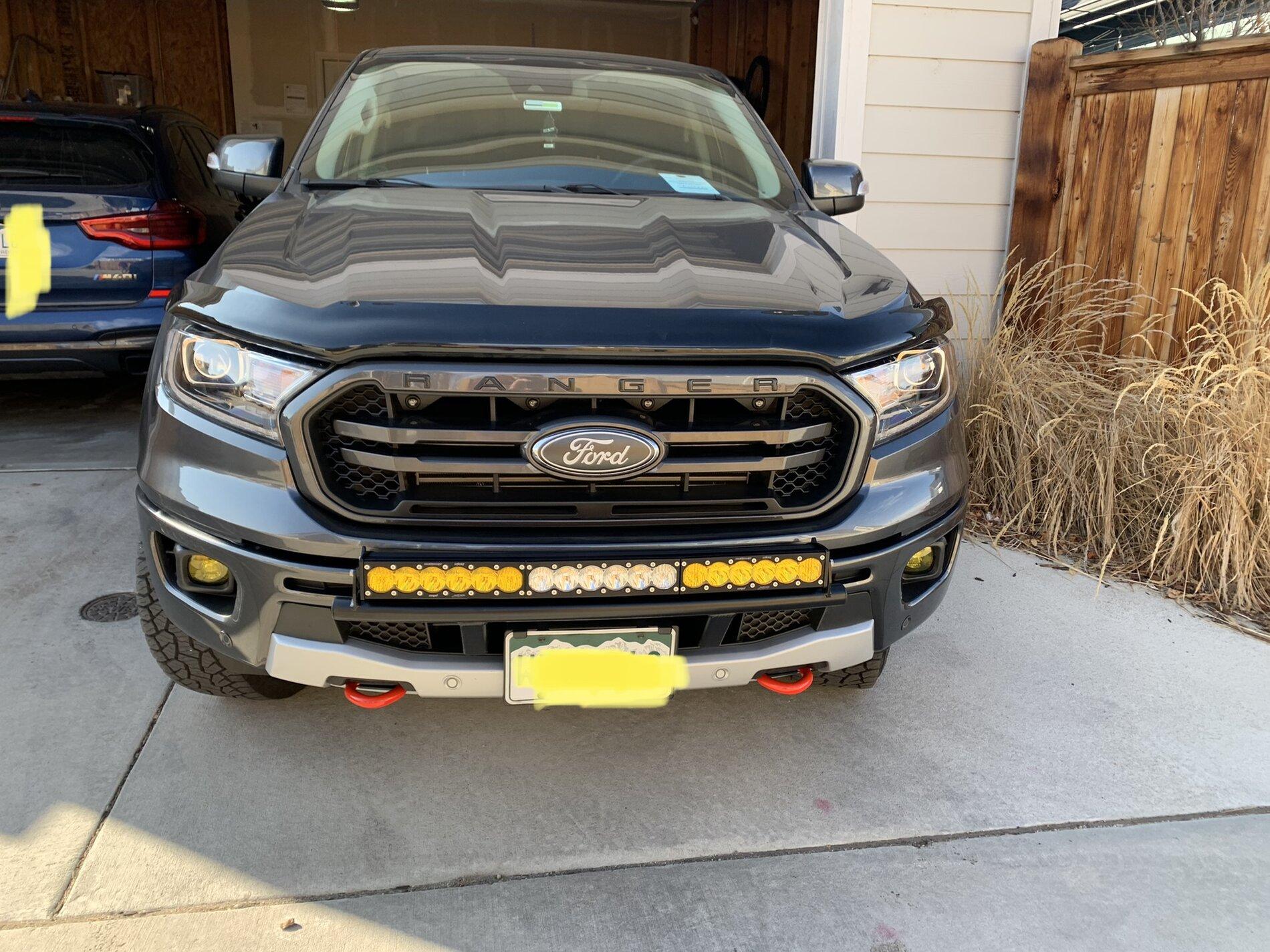

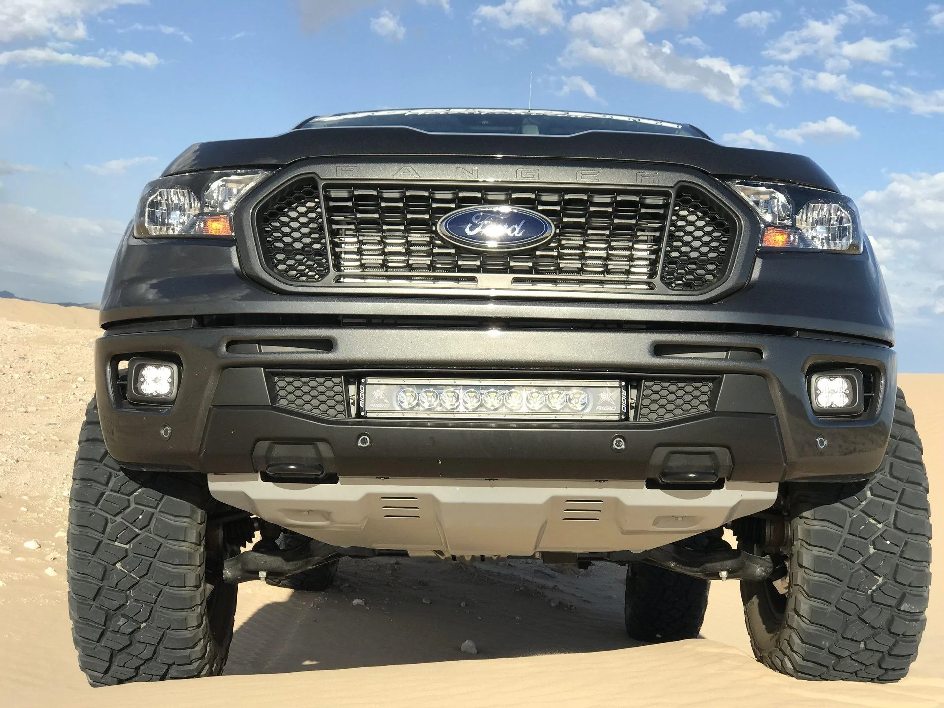

Finally got the set up installed. Svc off-road bar and Baja design combo.
I like how large the reflectors are on that. Larger reflectors = better light!

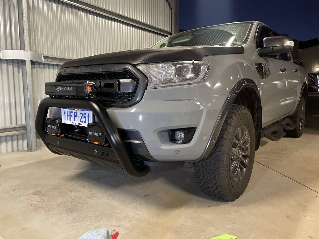

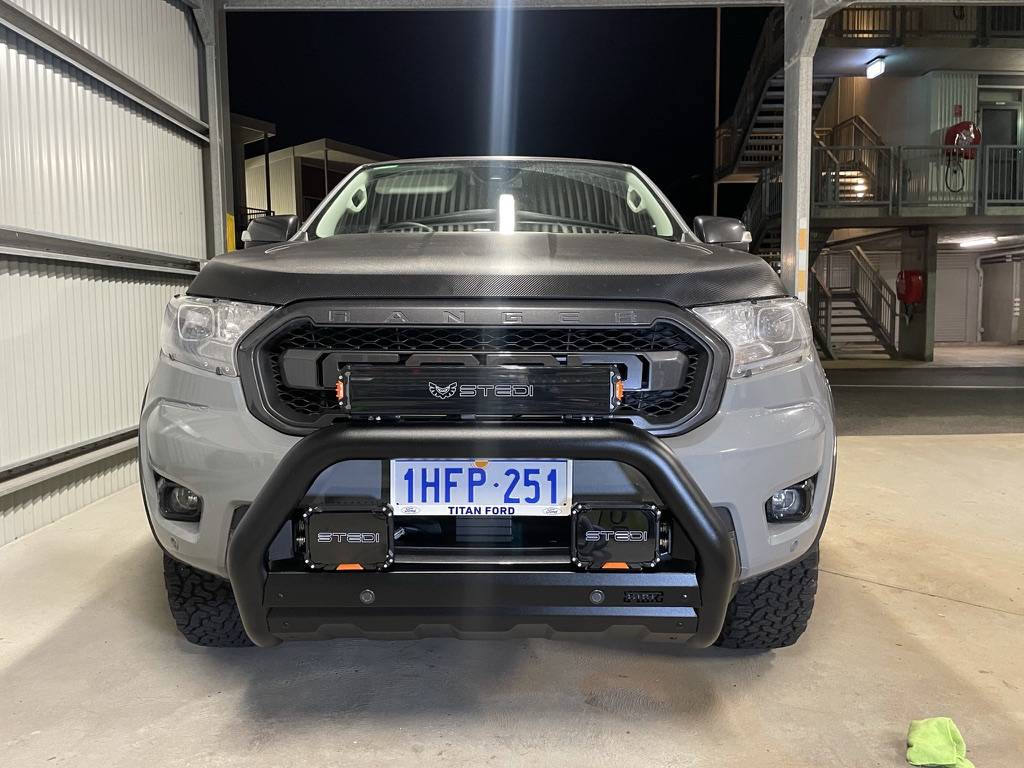

Hey All
A little plug for an Australian light company "STEDI". - https://www.stedi.com.au
I ended up going way overboard on My ranger with a 23.3" all flood light and twin Quad spots. I think it looks pretty cool with the nudge bar that provides a solid mounting point.
The combination of flood and spot provides an epic amount of near and far field light. Certainly enough to dazzle the wildlife.

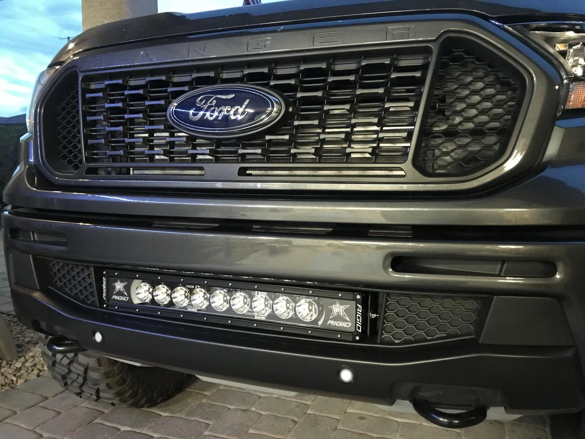

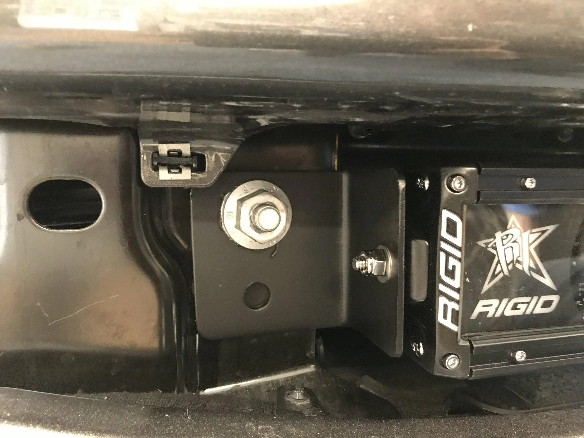

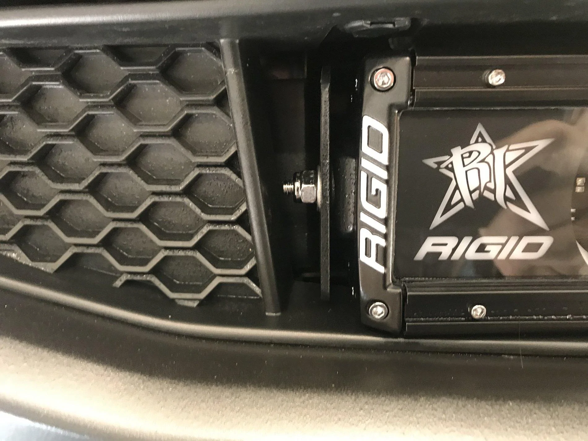

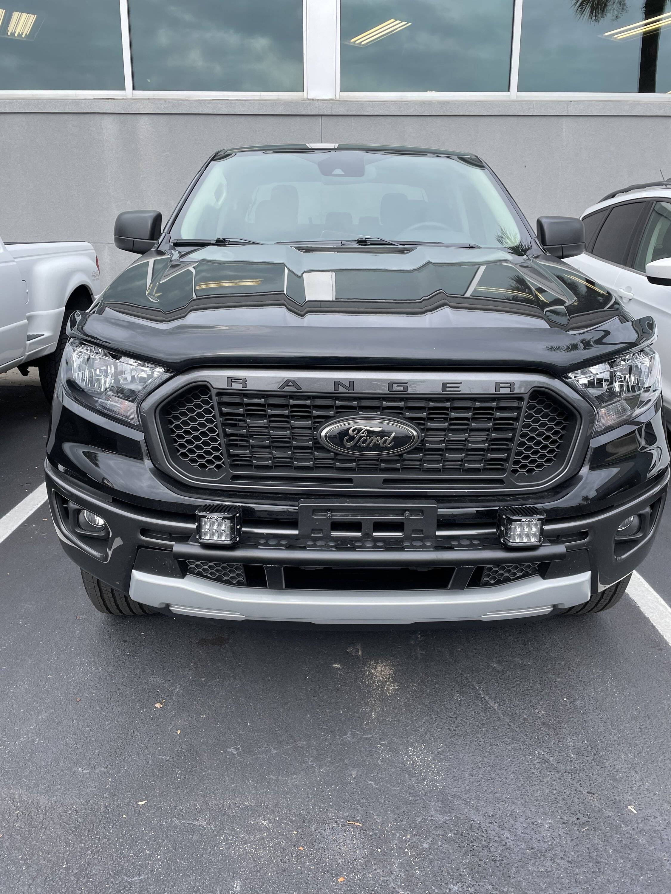

Just FYI to all, I believe all this is are light pods installed using the factory trim screw holes. Really any light pod with a single point bracket will work here, there are four of these trim screws in this location.
I actually used two to install a 22" light bar. Just more a PITA with a bar than a pod, have to install it from inside the engine bay area (remove the two front shrouds) to be able to tighten it down properly. I also drilled a small hole in the non-functional honeycomb for the wire cause I didn't want to kink it.
I also highly suggest you lay a heavy coat of wax on your lenses in this area as its going to get hit with all sorts of crap from bugs to grime. Also helps delay onset of yellowing. Really I apply wax to all my lights, but down here especially.

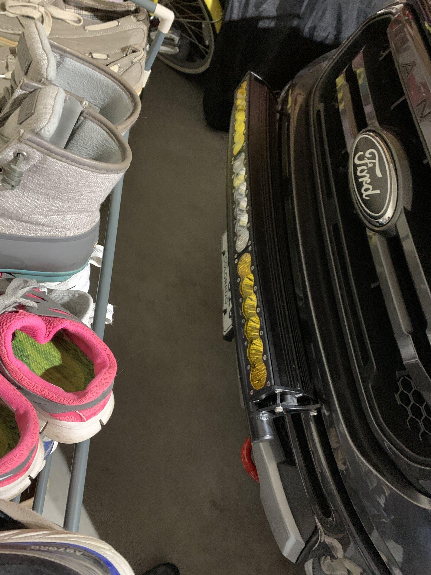

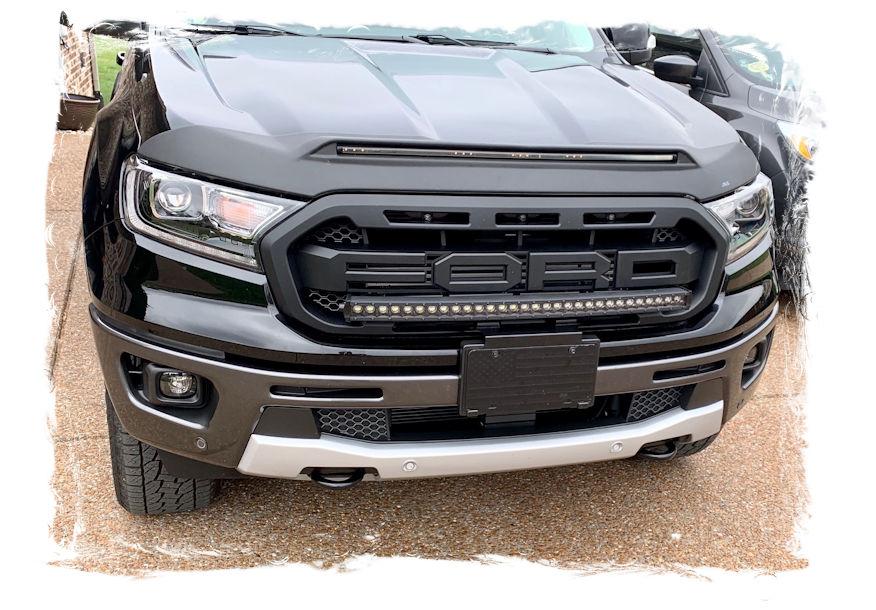

For the folks still struggling with light bar brackets in the front that cannot block the radar unit. I've had this on for quite some time with no issues. It's sturdy, comes in different sizes and multiple holes for different types of lights. I have a 30" curved light bar on mine from Rough Country.
https://www.ebay.com/itm/162694156475
from what I can tell on the RC website, It looks like the mounts for this lightbar are on the ends. How did you mount this lightbar to the license plate mounting plate?

I used the bar from svc. It has so many mounting holes that now it almost makes me feel like I need to get more lights.

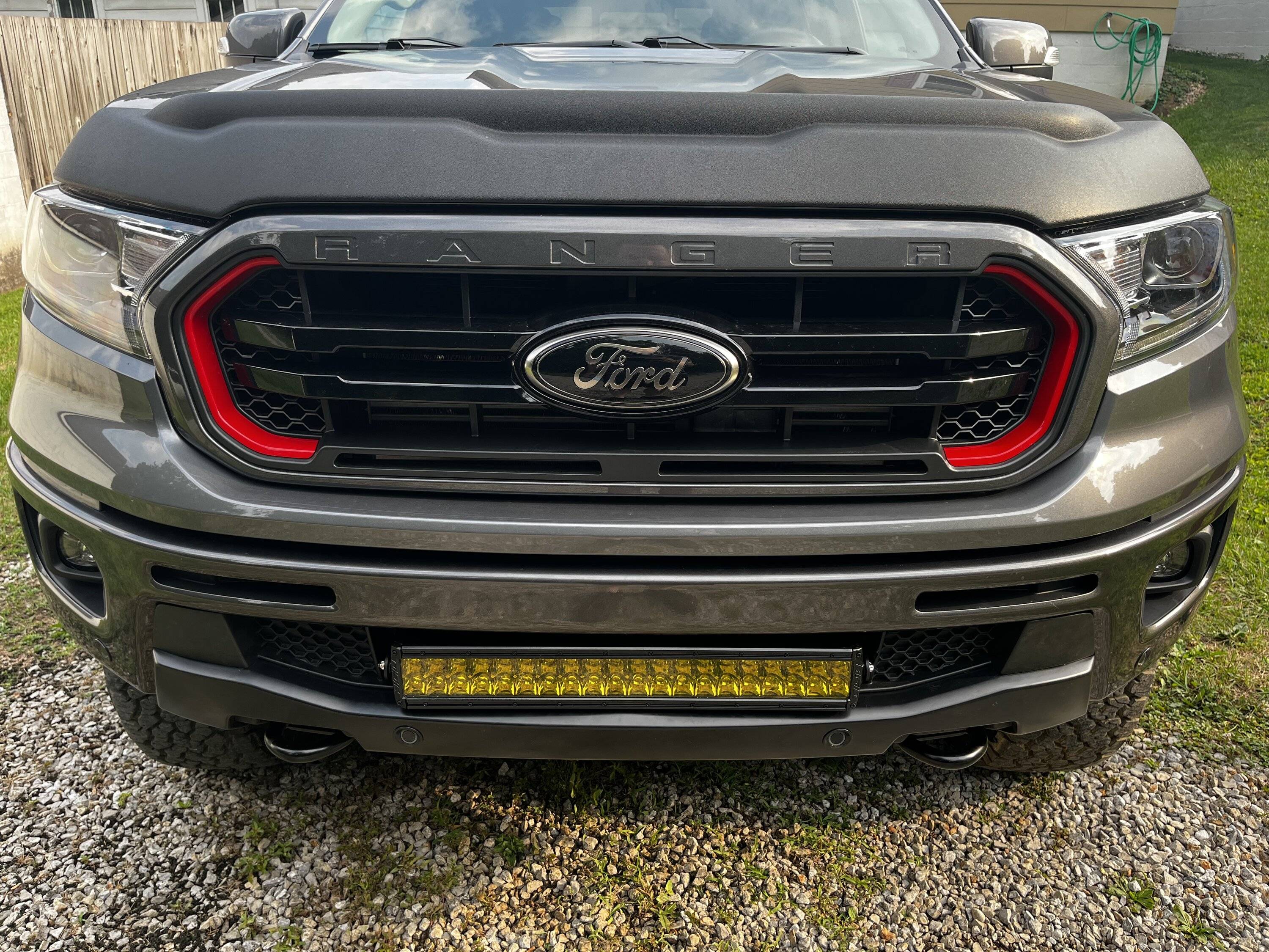

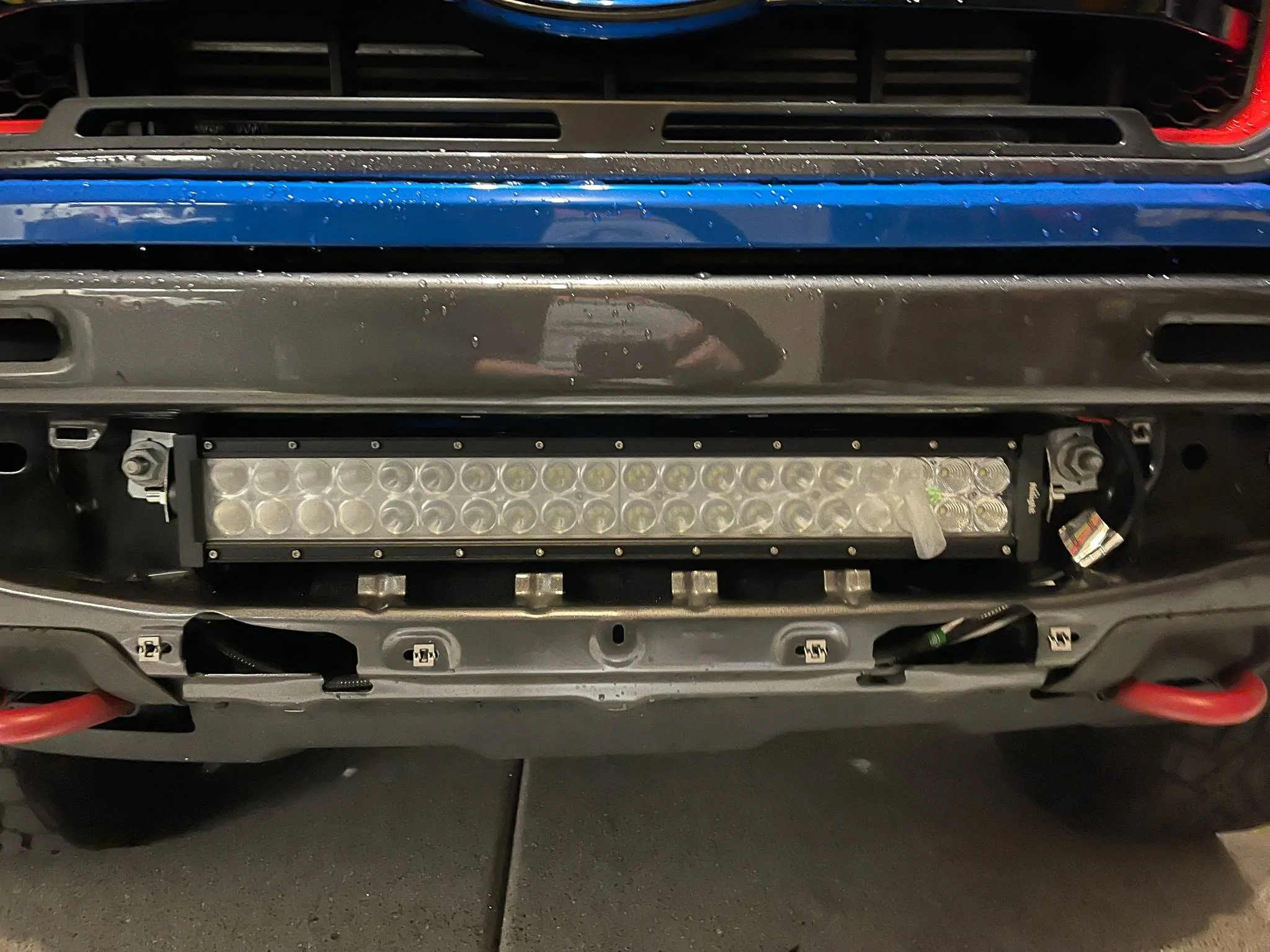

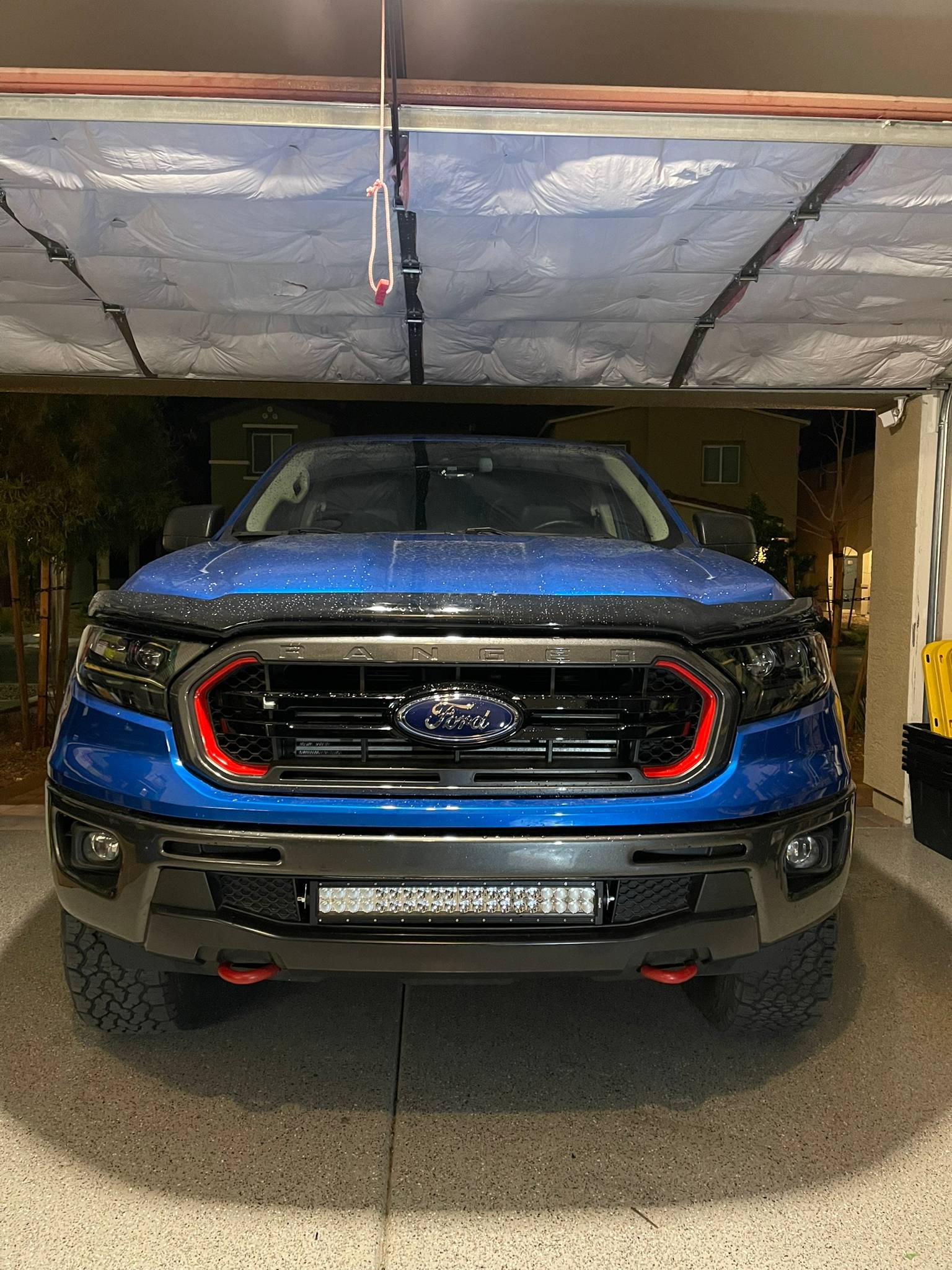

Just finished adding this 22” light bar from NiLight https://www.amazon.com/gp/product/B019Q0WEPS/ref=ppx_yo_dt_b_asin_title_o08_s01?ie=UTF8&psc=1

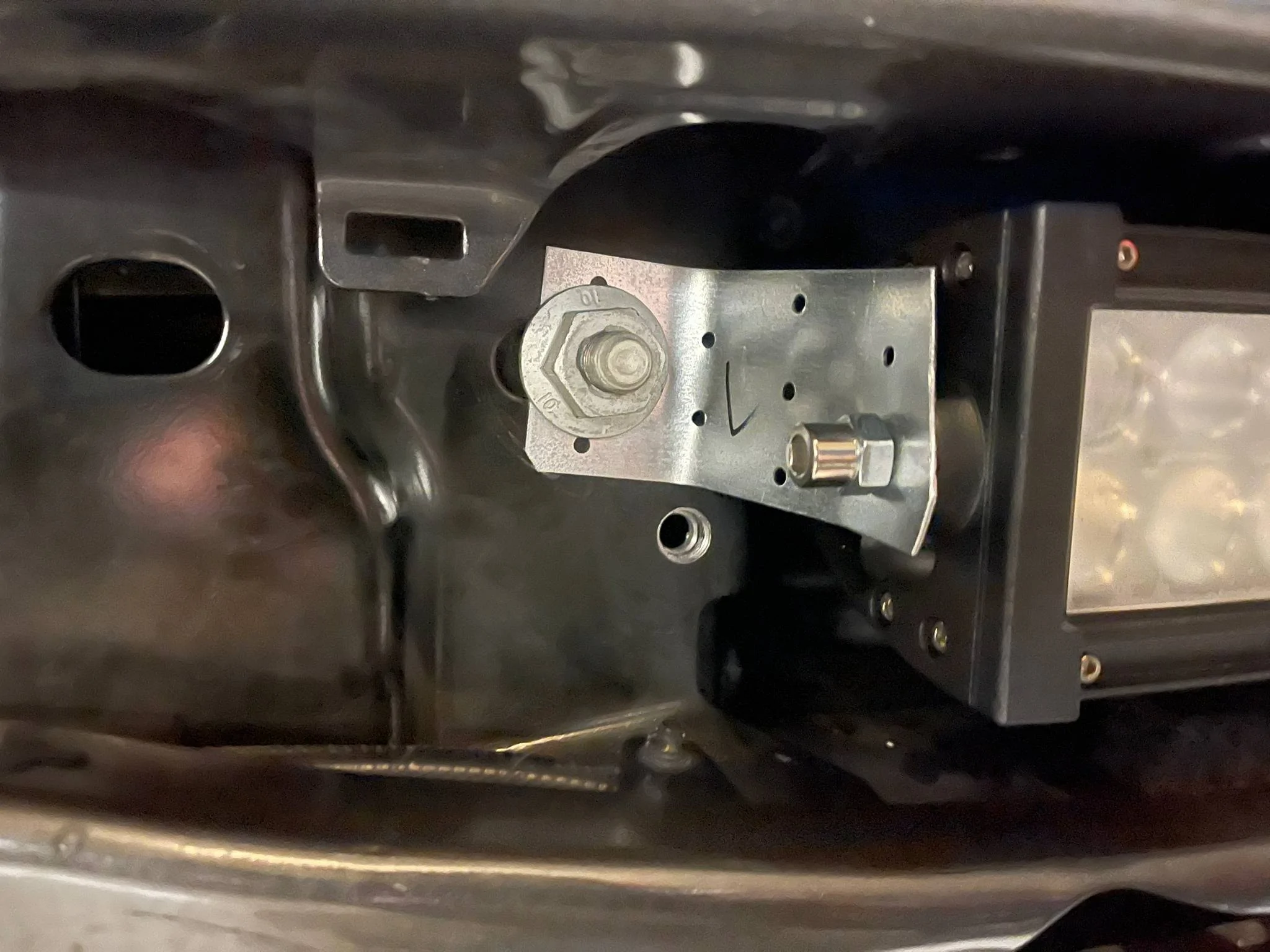

Had to make my own L brackets as included ones were not a good fit for this location.
I also wired using this remote wiring kit https://www.amazon.com/gp/product/B07B3Y2D1X/ref=ppx_yo_dt_b_asin_title_o01_s00?ie=UTF8&psc=1
Im very pleased with the look and light output and it was super easy to install and wire up.
Angle on the final pic is bad because any further straight on made the pic unusable ha.
Just wanted to thank you for this! I bought the same light bar as you. Ended up making my own brackets by using steel tie plates (bent/flexed and trimmed as needed). https://www.homedepot.com/p/Simpson...-20-Gauge-Galvanized-Tie-Plate-TP15/100375260
Here's some pics
