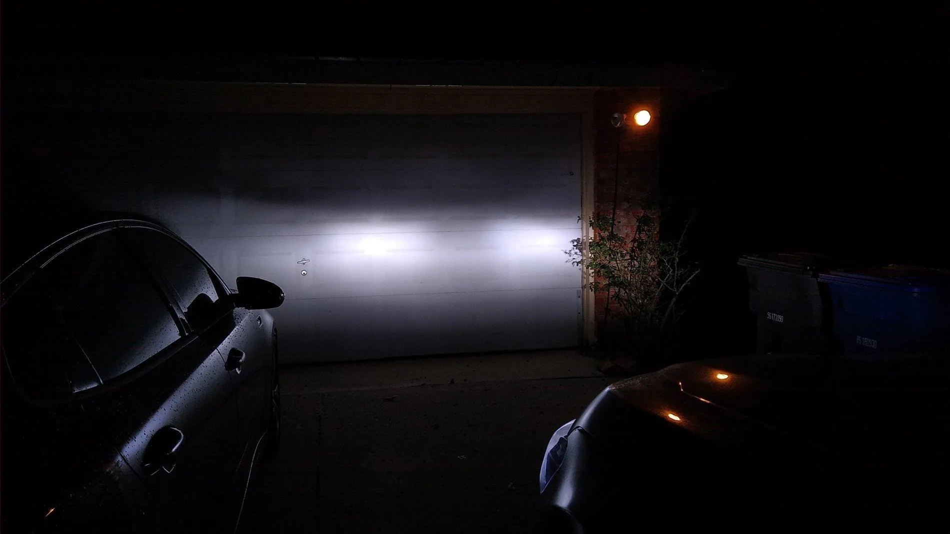

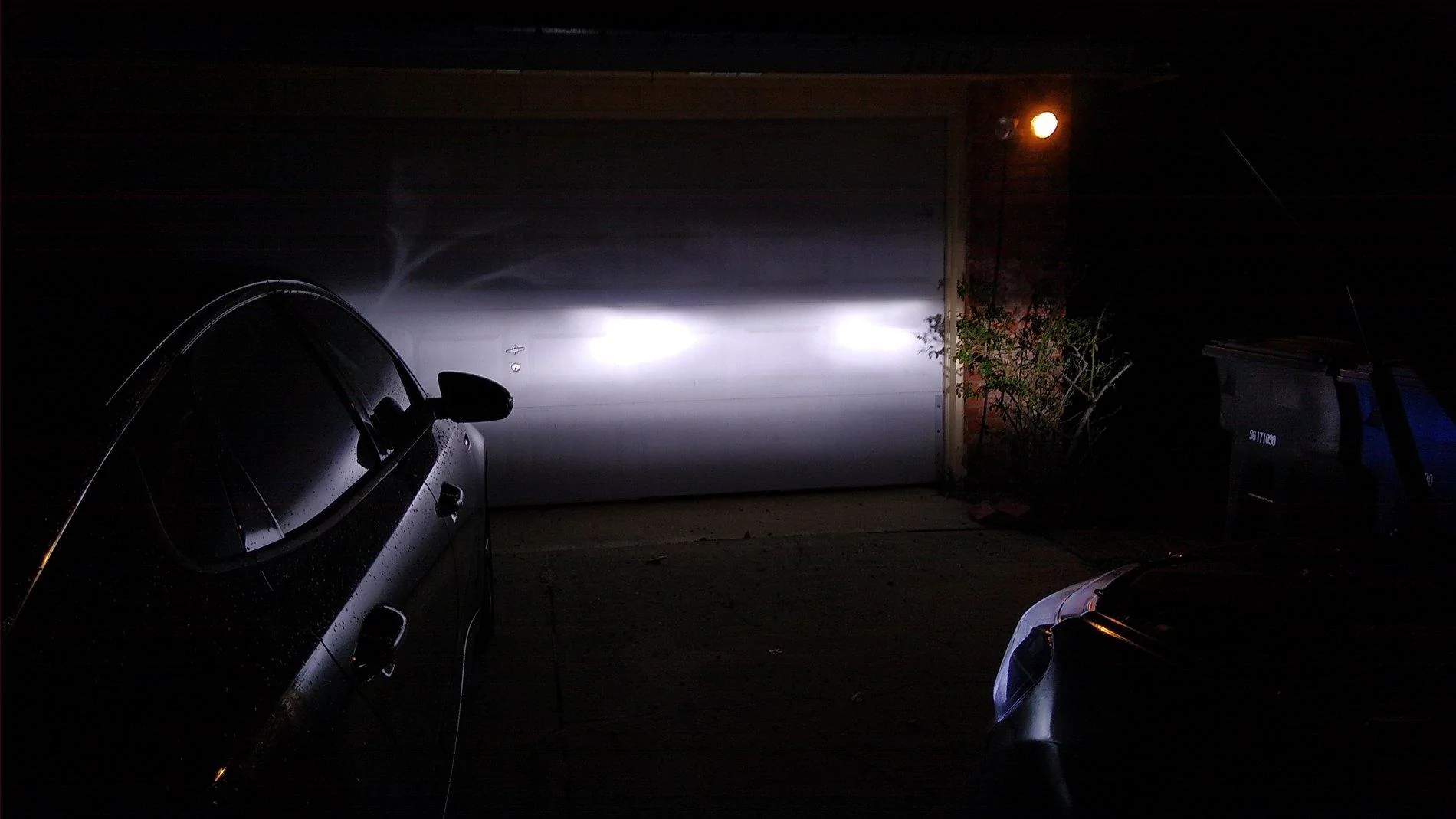

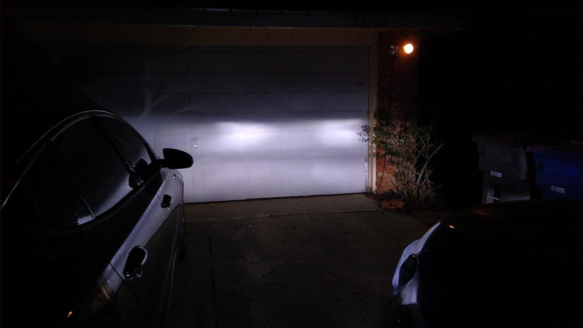

Installed the JDM Astar LED tonight.
Here are the 16k lumen Auxito as reference:
And here are the 12k lumen JDM Astar:
And the JDM with Hikari 12k lumen fog lamp:
As you can see, and what reiterates my previous conclusion, the cut off is much better with 12k than it is with 16k.

The problem work talking pictures of bright things in the dark is you never know how the camera adjusted for the brightness. One would have to go full manual on the camera to make a fair comparison.
Which is why I did that with my stock/LED comparison. If it wasn't so much work to get and send these back, I'd be happy to take a set of each of the brands and do some comparison photos for everyone, just as a thought :)
Could be...but in this case, (comparing the images) the other light sources appear to be consistent in brightness:)
