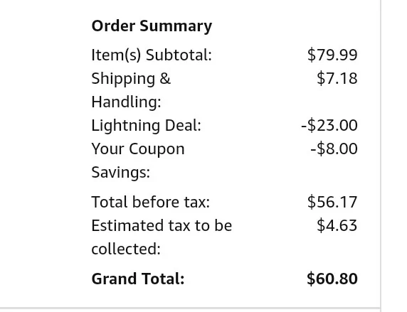

Just FYI, I put a bunch of led bulbs in my wish list, and a few pop up with lightning deals. I had the JDM come up with $23 off. Total to my door was $61.

The lightning deals are only items you're watching or have viewed. If it makes you feel any better, the JDM were 79.99 when I got the lightning deal. $23 off for the lightning deal and another $8 off with a coupon.

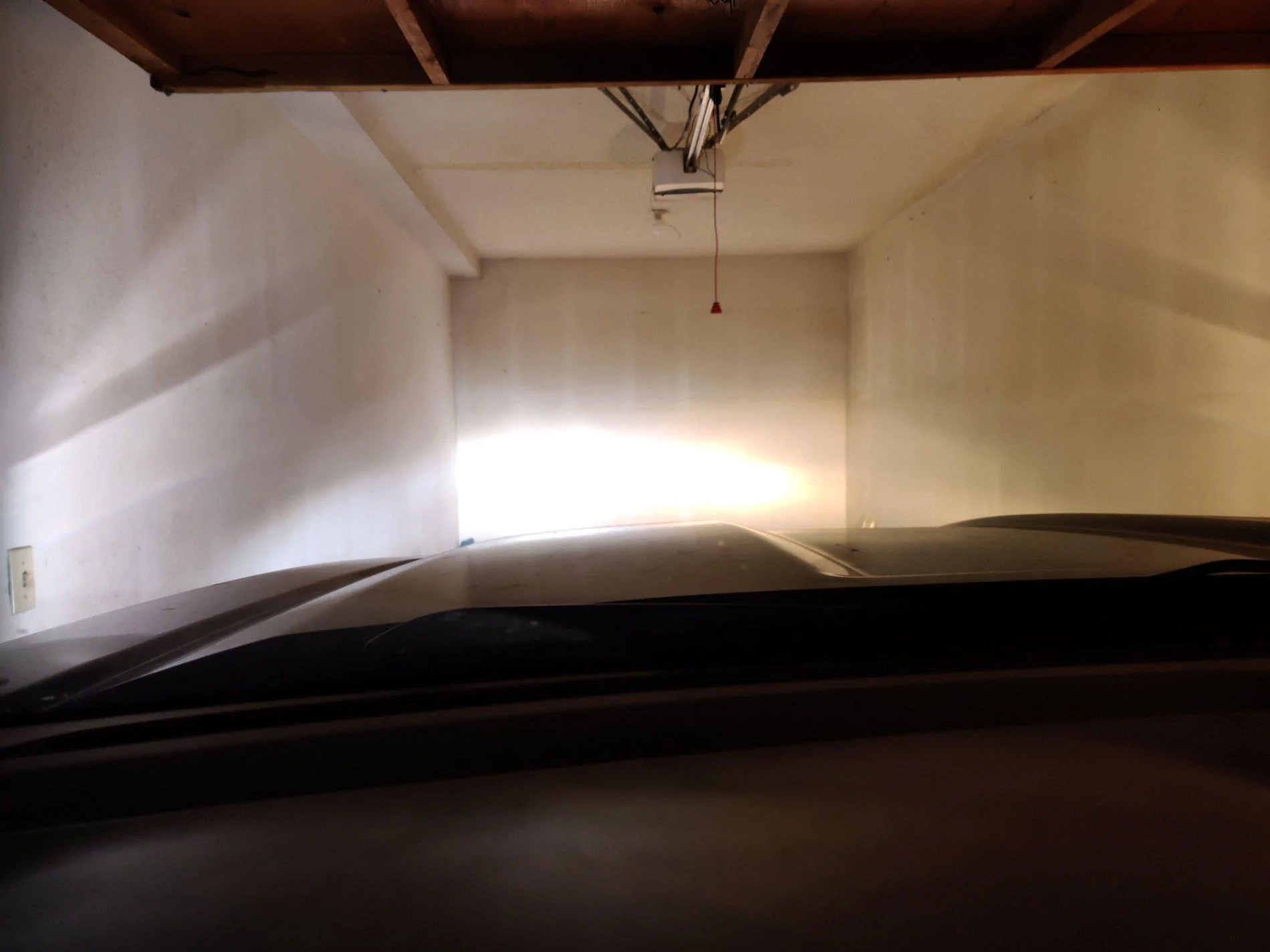

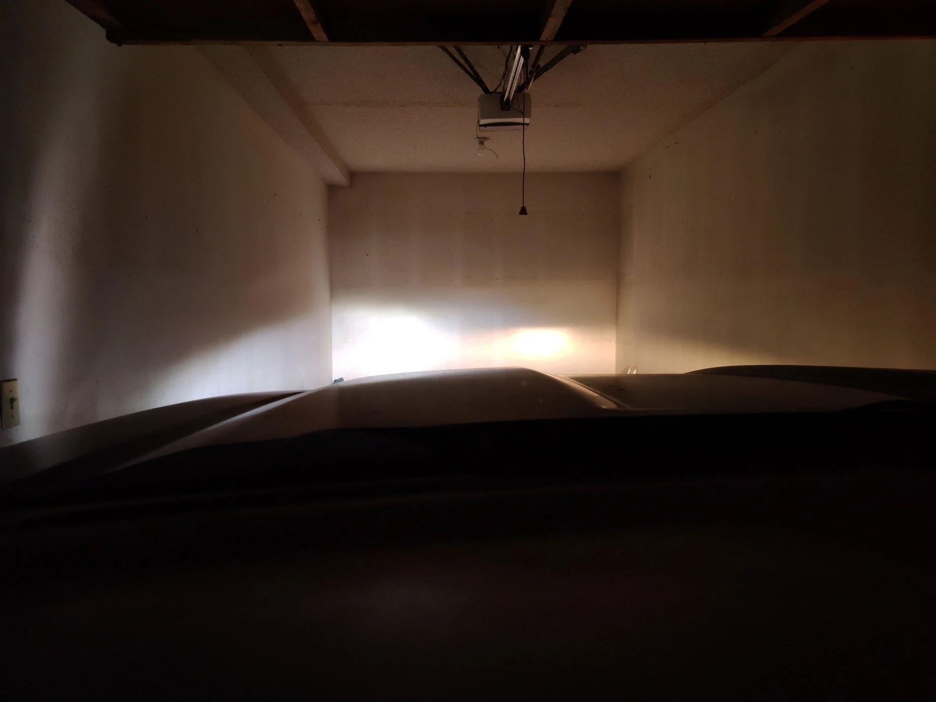

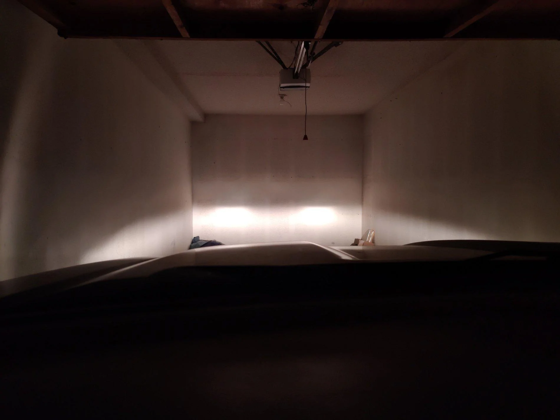

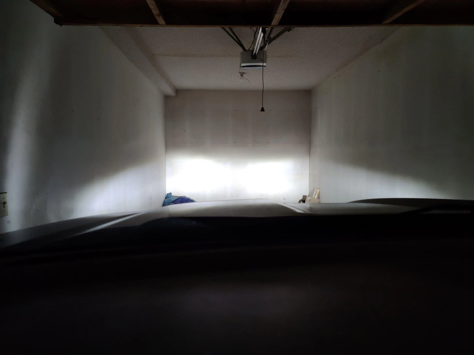

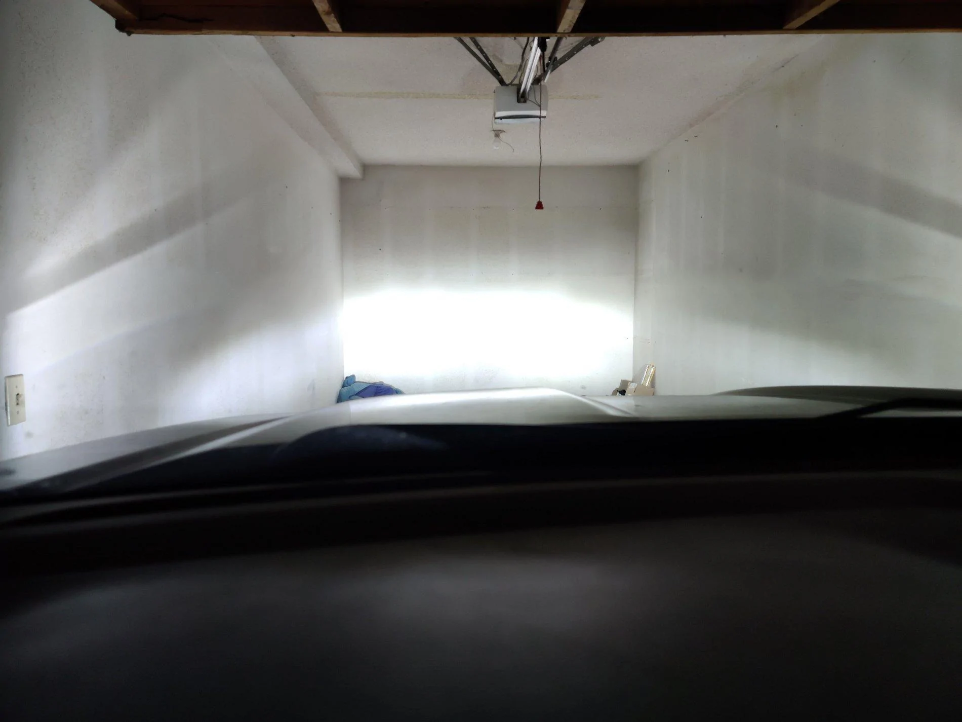

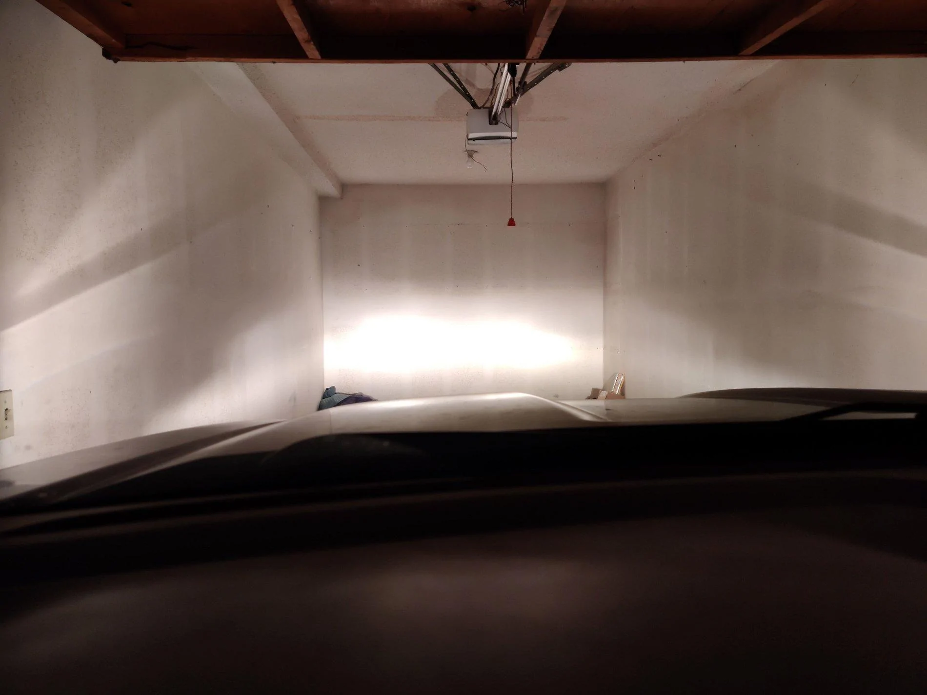

Alright, so I got the Sealight S1s yesterday and got them installed tonight. These pics are with the truck parked just enough to get the front mostly level in the garage, and shining into the back wall. Living in the city means there's not really any dark places I can actually do a better comparison.
I can confirm they fit just perfectly fine with no issues whatsoever, so you can add these to the "they fit" list @weasel1.
Link to the bulb kit (low and high): https://smile.amazon.com/gp/product/B07LGJ2Q6T/
I'm a bit worried about the spillover on the low-beams. The cutoff doesn't really exist anymore and there's a fair bit of spillover upwards where I wouldn't otherwise want it. The bulbs don't appear to be clockable, so the low beams are in at a bit of an angle (the LEDs sit around 10 and 4), but the high beams are a perfect 9/3 fit. I'm not sure if I'll wind up keeping these or returning them and trying something else, fitment is perfect but ultimately I'm a little worried about the bleed on lowbeams.
Here are some pictures of the bulbs so you can see for yourself. I tried to do the same color modes for both sets of lights, but in doing the same settings for the new bulbs they looked extremely blue which they're not. These are running the same ISO and shutter speeds, the old bulbs are taken at ~3500k white balance and the LEDs are at ~4800k white balance.
Here's the old lowbeams:
And the new lowbeams:
The old highbeams:
And the new highbeams:
Here's a side-by-side comparison (lowbeams):
And a side-by-side comparison (highbeams):

I'll add the S1's to the list, but I agree about the spillover. I think you'll get flashed a lot if you use those ...
Same. I took an hour drive last night to get out of all the lights in Long Beach and didn't get flashed once. That doesn't mean much though, I swear at least a quarter of the people here either don't have their lights on or use their brights all the time. I'll be sure to post an update on how things go.
In the meantime I'm going to keep my eyes here and see what comes up in the likely event I replace them and return them.

Well, to follow up. There's either something wrong with the drivers or the bulbs, because the low beams have had at least one bulb go out multiple times after being driven for a while. So they're getting returned and I've ordered a full set of the new Car Rovers which I should have tonight and will get installed at that time.

I suspect it's just a defective bulb/driver in this one bulb, but given the bleed on them already, it's not worth getting replacements for these directly, but rather going for something with slightly better quality. Everything is stock, just plugged the lights directly into the stock harness, no relays.
