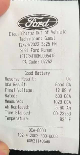

12/27/22 - I was having unrelated issues with my exterior door handle 'smart' locks not functioning in the start of my day. Later in the day the electronic locks cycled 100+ times on a 45 min drive home on the freeway. Took it immediately into Ford and they tested the battery and said it was good but low on charge. Booked an appointment for 12/29.
12/28/22 - I had no issues with the locks but in reverse the rear detection sonar noise was coming out of the front left pod. Not the rear speakers like normal.
12/29/22 - I took it into the dealer and they could not replicate any issues from above. Asked them to load test the battery and they said they needed it overnight.
12/30/22 - Got a call from the dealer and they said the 'battery warranty tester' showed a "really good battery". Receipt from the 'warranty tester' is below. Took the truck home and no issues until today.
1/1/23 - I played with forscan and upped the BCM from 75% to 90% and enabled bambi mode among other things. No symptoms from above after 12/29 dealer visit and battery was tested. *see note below regarding my experience so far with bambi mode*
Today 1/6/23 - Leaving home on my way into work the front left headlight was flickering VIOLENTLY. Like strobe light effect. Only did it leaving my driveway and the first 300 feet out of the alley. Once I got on the main drag it was working fine as far as I could tell. I wish I was able to get a video but I was super late to work. (*Weather condition for this morning was wet but not raining*)
On a side note, does anyone else hear a relay click or activation thump sound when they activate their highbeams? I noticed it when playing with forscan after enabling bambi mode. I panicked and turned bambi back off to see if the relay noise went away but it didnt so I turned it back on. Idk if its relevant to my issues or not. I have not used by highbeams since I have enabled bambi on Sunday.
