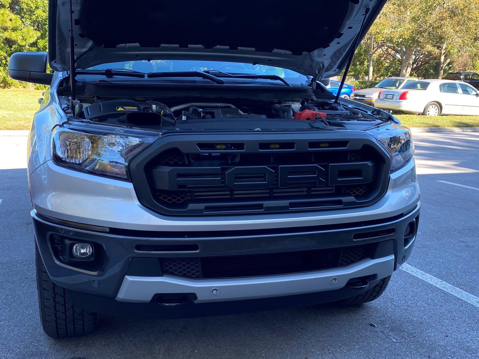

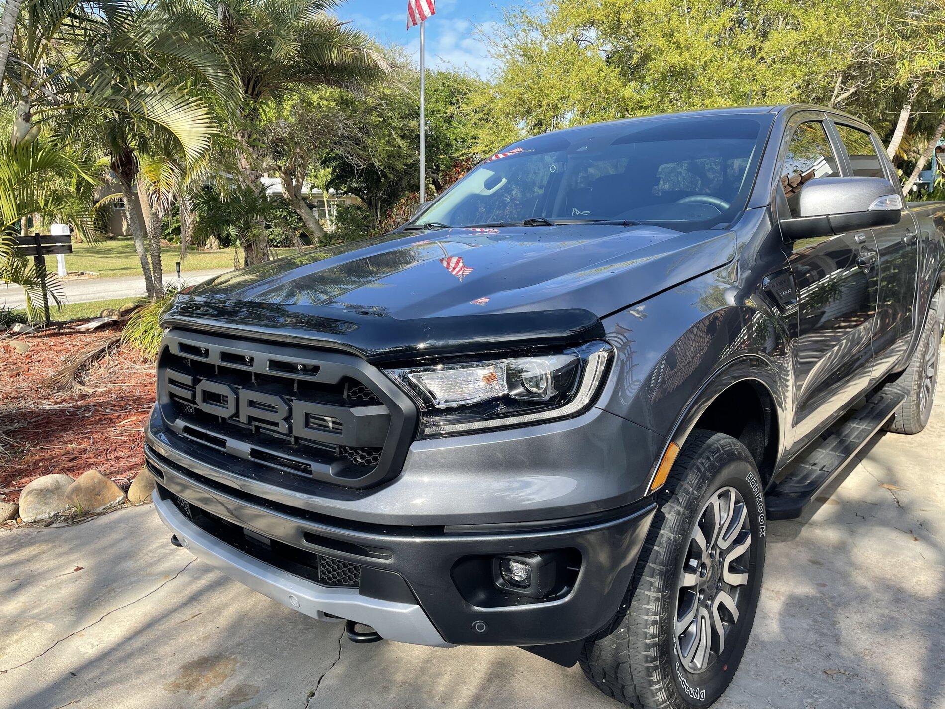

Looks better than I thought it would,
After fighting with bottom clips i figured out you push down from the top and i had them all released within a minute, managed to not break any.
About 30 min to remove and install. Hardest part is bottom clips on removal. New one snaps on super easy. Also added the orange LEDs, can’t see in pix though. They are awesome and also super easy!
got my grill here for $177
https://www.truck-accessories-guy.com/products/ford-ranger-raptor-style-grille-us-ranger
and lights here for $90
https://www.stage3motorsports.com/1...orks-Raptor-Style-3-LED-Grille-Light-Kit.html
Lights were plug and play, no wiring. Disconnect side light and put in new harness
