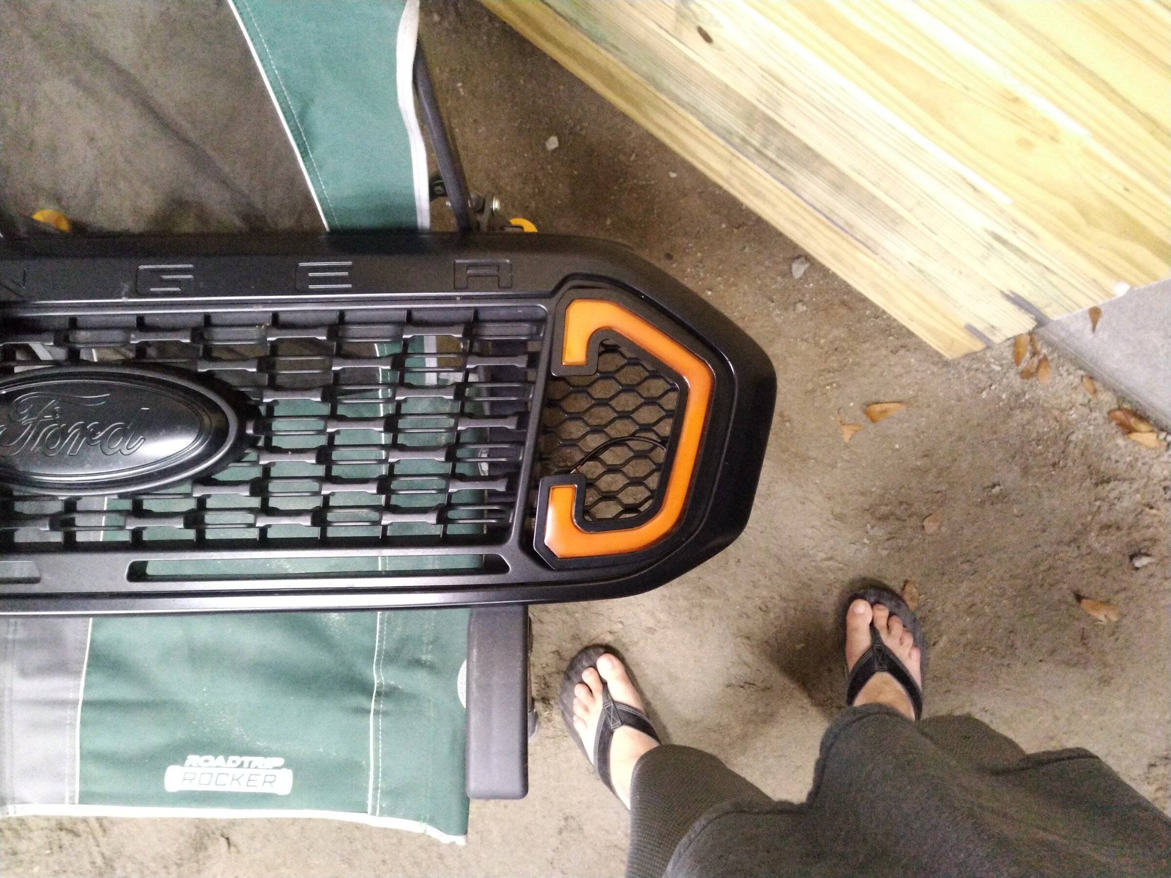

Well, it works!
I hooked up double connectors for the normal sequence, so if I want to I can pop the hood and move over the other connection. Figured why I had everything apart might as well leave access to quick connect/disconnect.

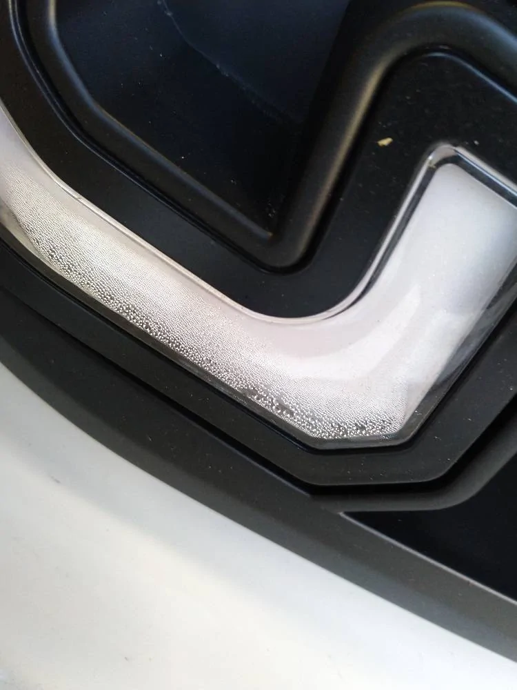

Okay so in the fairness of keeping people advised on this grill I've encountered two problems both of which I'm communicating with the seller to see what their response is.
1. I encountered some pretty heavy rain and some steady light rain on the trip to Atlanta on Sunday to meet up with @Glocker before he bugs out of the state and runs away to old peopleville. Notice this afternoon I've got some slight condensation in both LED housings towards the bottom. Normally every light that I purchased on Amazon I seal with gasket maker to prevent this. I had completely forgotten to do this when I installed it. So yes at the end of the day a manufacturer's defect they need to address but I also forgot my usual routine so that's kind of on me as well.
2. The Amber function works fine on both units and the startup sequence and constant white on the right unit works fine but on the left unit everything works fine but on the steady white there is a dead spot in the LEDs at the end where it hooks up into the c shape.
Luckily both the LED housings are inserts that bolt on to the rear of the grill so I'm going to see what the seller's response is if he's going to send replacement housings or whatever. If their response or resolution isn't going to make me whole in some form or fashion where the grill is usable I'll simply return it to Amazon and get the afn style which I was planning to do anyhow before I discovered these.

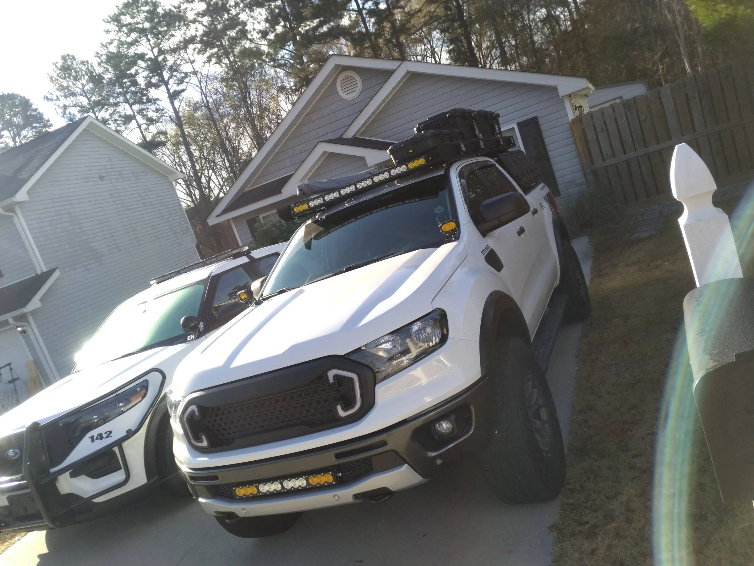

It was good meeting up with ya, even if it was just briefly! That rack is a BEAST!

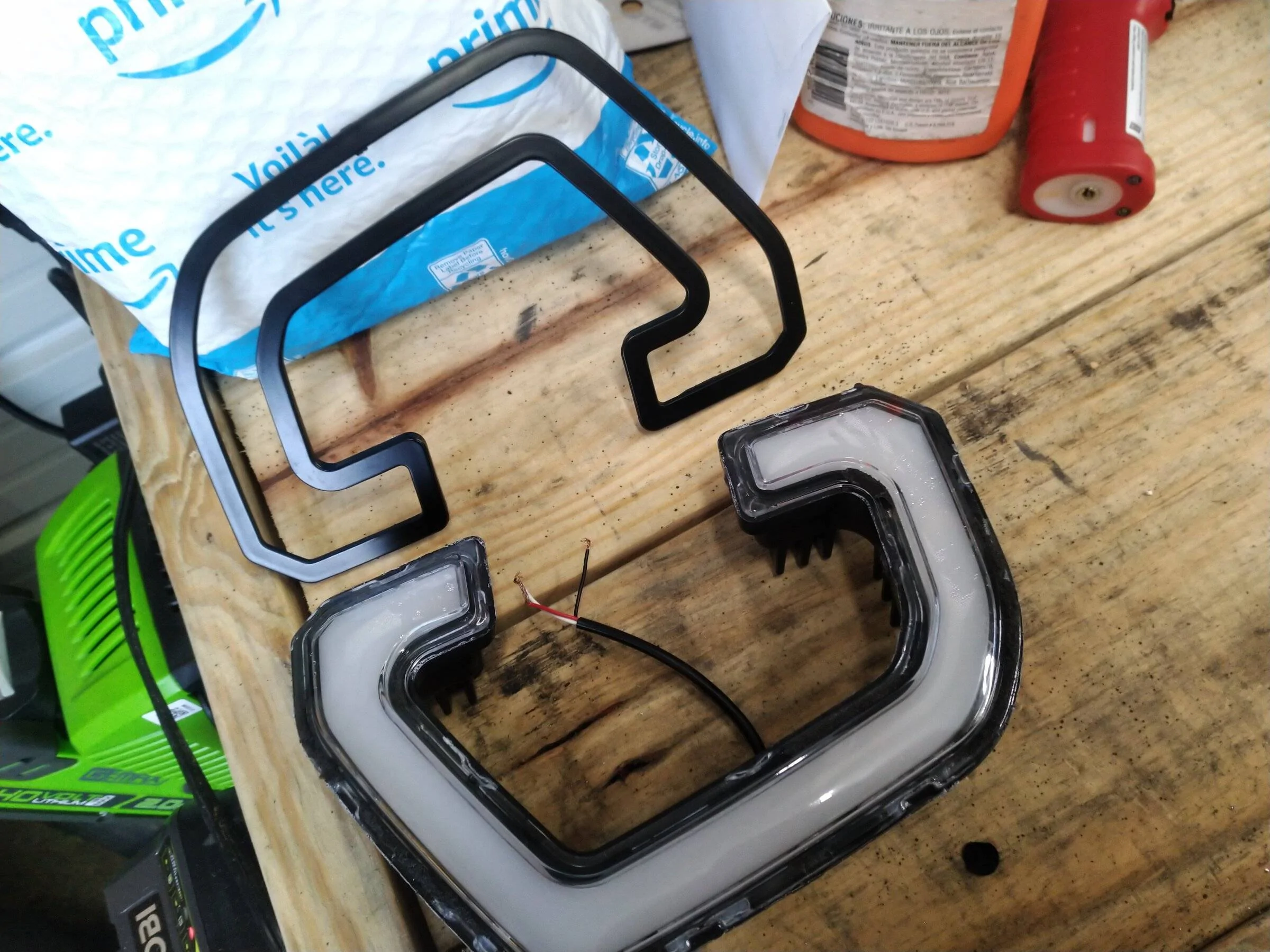

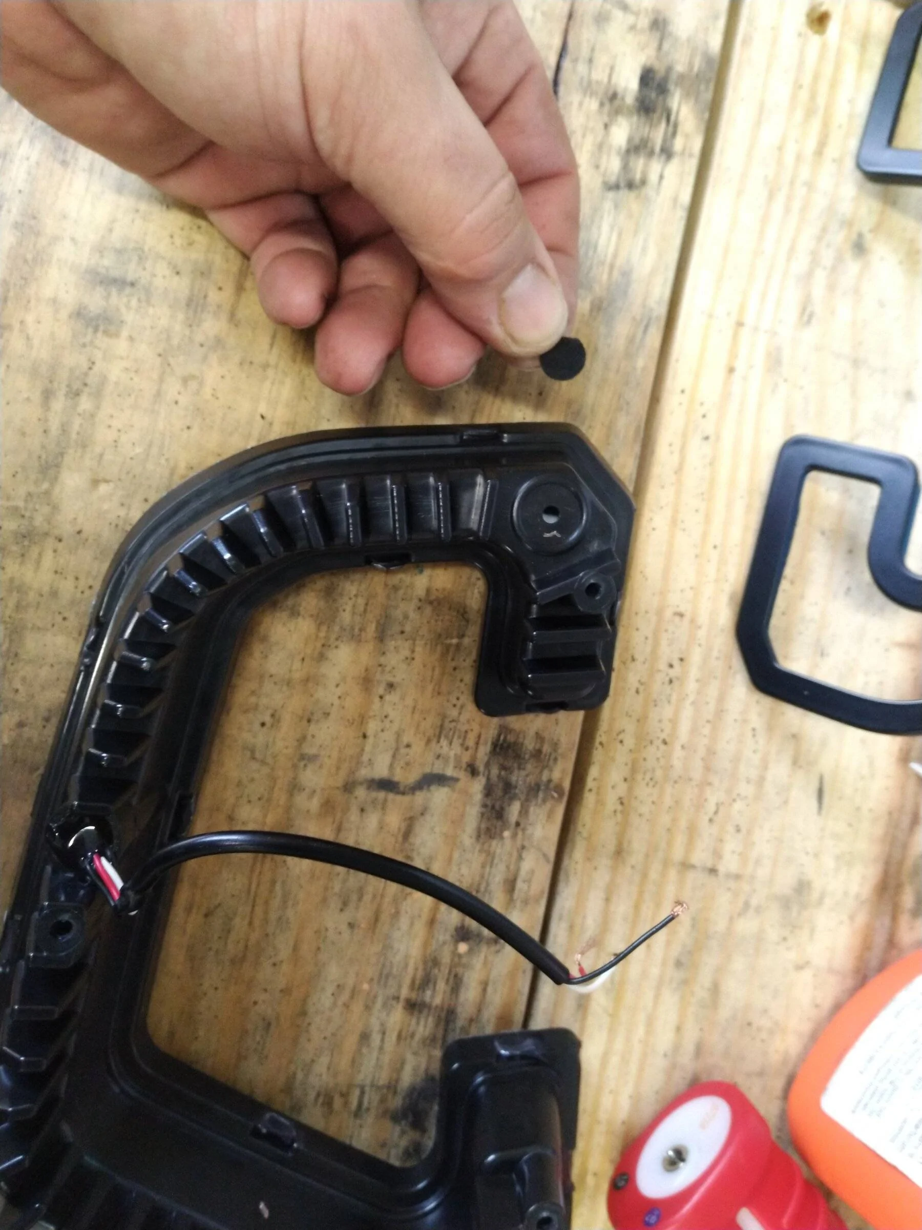

Took this time to pull out the old grille and start taking it apart to see if I could discover the source of the leaks. So first thing, the trim on the LEDs are held in place by some trim tape. You can remove them if you slowly and carefully use a small flat head. This will come in handy when I go to "amberize" the new ones. Second of all it seems the lens and body of the LEDs are sealed pretty damn good. Whatever they used I couldn't find a gentle way to bring them apart without worry of cracking something. Its either a perma-gasket of some sort, or they do the old plastic fuse method.
So the only source of the moisture ingress I could locate is each LED has 2 holes, or what I assume is their idea of a "breather". Thing is the holes are covered by a small "filter" sticker. The picture doesn't show it, but is is literally a tiny mesh sticker. Yea well the new units are getting these holes plugged with sealer.

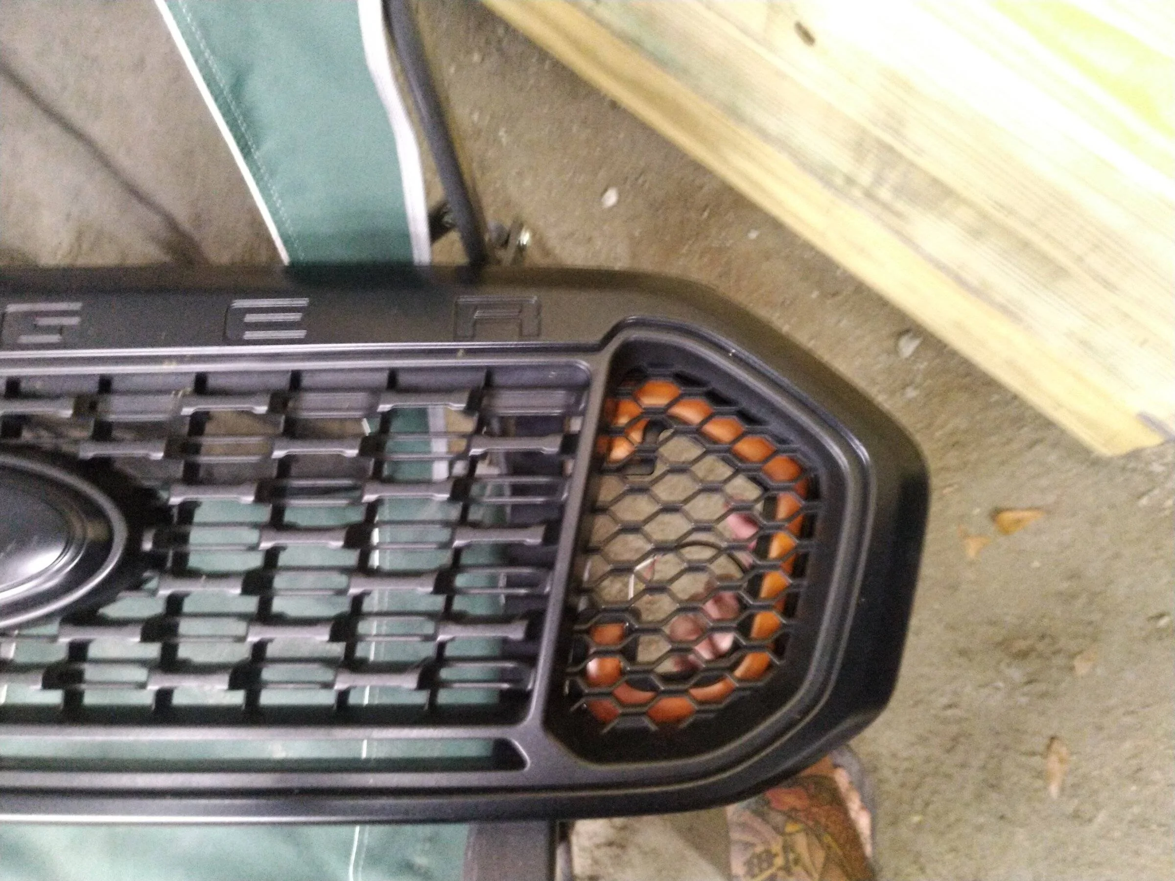

I took one to screw around with starting to paint and see how they would come out. I've been using a 2,2,2,2 coat sequence between yellow and orange to get the classic dark amber look. In this case the LEDs are so bright I probably need to finish with 4 coats of orange instead of 2.
