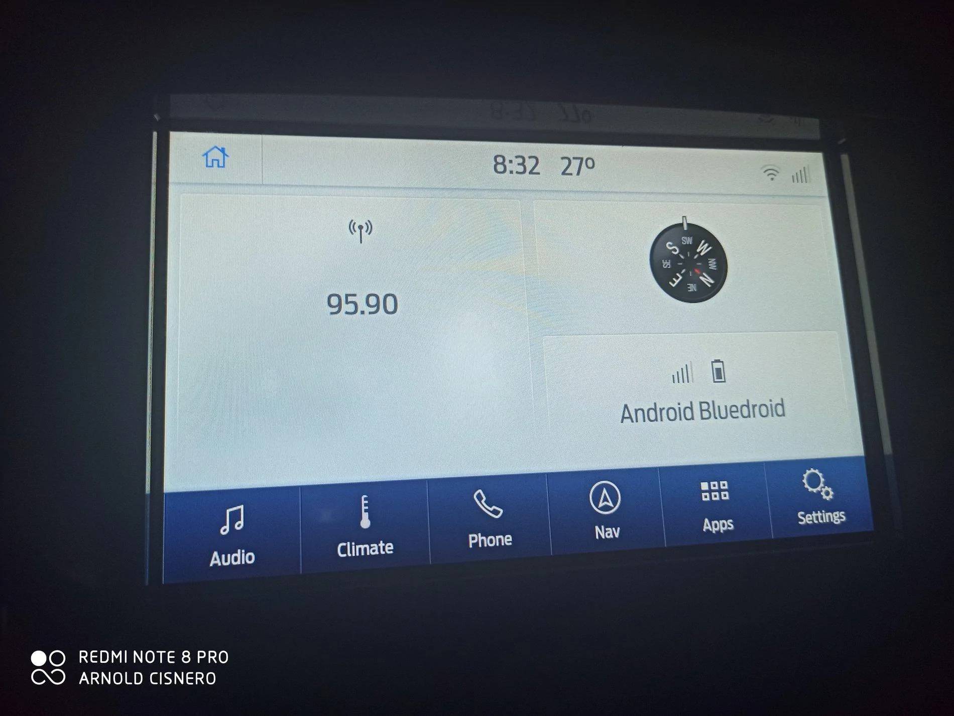

21 minutes and < 1/4 through.....30 minutes total. I noticed no climate
In this version. I won't miss it because I've always done climate through voice
SUCCESS! Thank You all.
Also solved my original problem with the NAV which led me here. I'm liking the dark blue BG better than this one

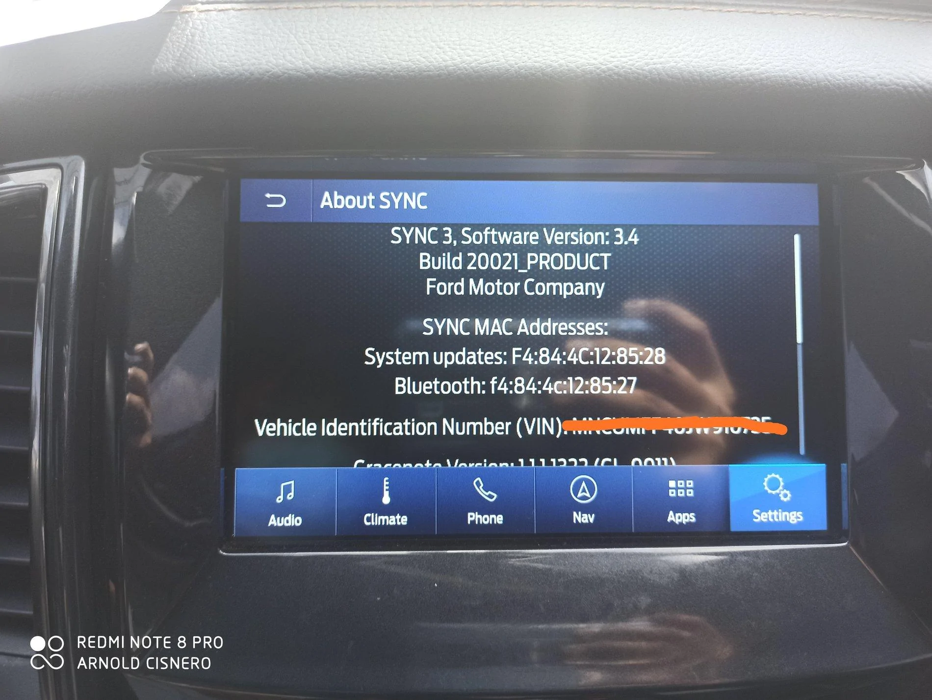

My 20021 still isnt showing the climate button either, but when i realized its easier to use the physical buttons i didnt care to much. Tried master reset and it didnt change anything.
RedlandRanger
Nov 14, 2018
35
4,592
8,826
For those who have updated and don't have the climate menu option (and want it), there is a fix using FORScan starting at this post:
https://www.ranger5g.com/forum/threads/is-sync-3-version-3-3-the-newest-available.5068/post-97298
I had the same exact issue and this fixed it for me.
What's even easier is just using voice to change the temperature. I never use the climate app in sync 3. I just said it with my voice. If I want to turn the air conditioner off I just reach down to the panel and turn it off. Next time I go to Ford, I'll ask them to install that file that gives me climate back
How do you load the apt file? Should I put forescan on the laptop and hook it up to Bluetooth, through the OBD port?
What value is changed in Forescan for the climate control? If this turns out to be easy I'll go ahead and do it otherwise I can live without climate control icons on the screen
Its very simple
Go to APIM and dont worry about the asbuilt stuff, The asbuilt you have to enter certain numbers but the other is just a simple enable/disable. You can also enable nav there and it will give you a simple compass on your cluster screen.
While your er in there, you can change your splash screen to say say Raptor or anything in the list. You can also change your layout for the GT style which was popular for 3.3. However, I dont think you can have a different splash screen from your stock layout. YOu will keep the splash screen but the layout will go back to stock. EX: if you have the GT style layout you will need the gt splash screen. Im not 100% sure about that though, I just saw people talking about it. Someone will correct my if Im wrong.

Thank you, Alex, I hooked up my laptop via Bluetooth and connected but I could never get that long list of items you choose from and I think it's because I am on forscan light and they won't let you change anything. So I just paid them to ten bucks so I can do what I need to do.I'll see what happens when I get the full version. I did download the beta version for the Windows 10 and installed it but I never get those long list Al items that can be changed. I'm going to have to get the activation key
I use the free W10 version(extended License) on my laptop, you should be able to do everything as far as I know.
