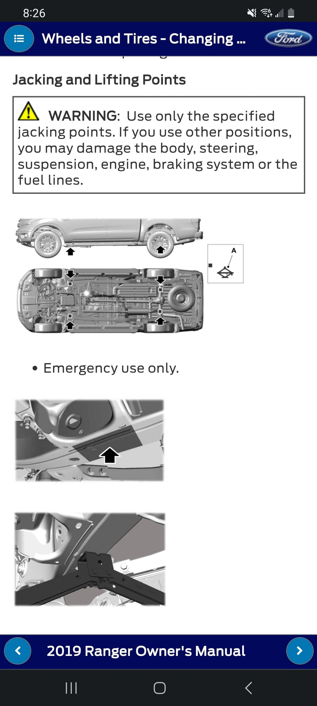

Not sure about in front of the front axle, but the rear axle is the recommended jack point in the owners manual I believe.
https://www.ford.com/support/owner-manuals/

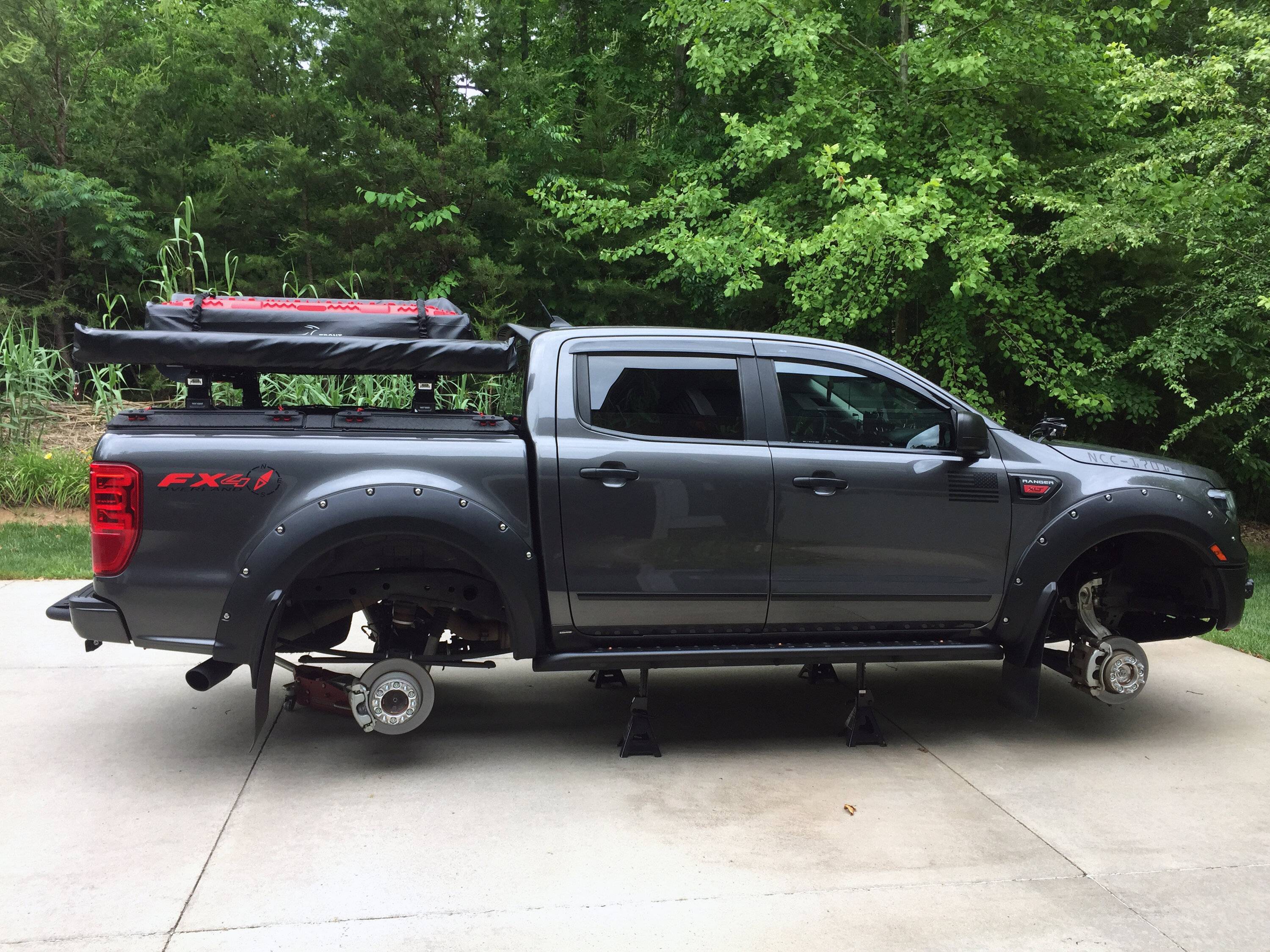

I just did this yesterday...jacked up one corner until tire is off ground to remove then lower down onto one jack...go to the other side and repeat...then go to the back and lift the axle/tires from the center diff until both tires off the ground...remove wheels/tires then lower onto two rear jack stands...

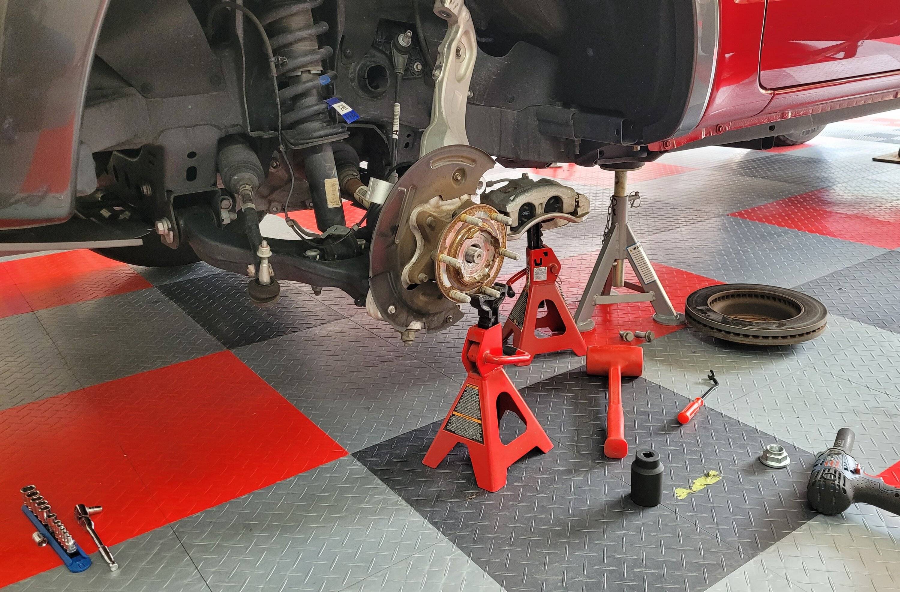

I've done similar to Sid, but a slightly different approach because I went much higher, with 3" clearance under the tires.
I do the rear first to take advantage of the free rolling front wheels, which reduces lateral load on the jack. The axle sits in the concave section of the jack stand, and allows for easier pivot when I lift the front, without torquing the stands.
The front I lift from the front most cross member (at the rear of the front skid plate). My preferred jack stand placement is under the lower control arms, unless I am working near the wheels, which I will use the front cross member, the second cross member, or the frame rails, depending on the job.
The method I use is recommended to use wheeled floor jack, not the factory jack, and keep it inline with the truck, so it has the ability to roll and stay centered under the load.
Short answer, yes the cross members should be fine to support the vehicle, but try to keep them near the outside as much as practical.
