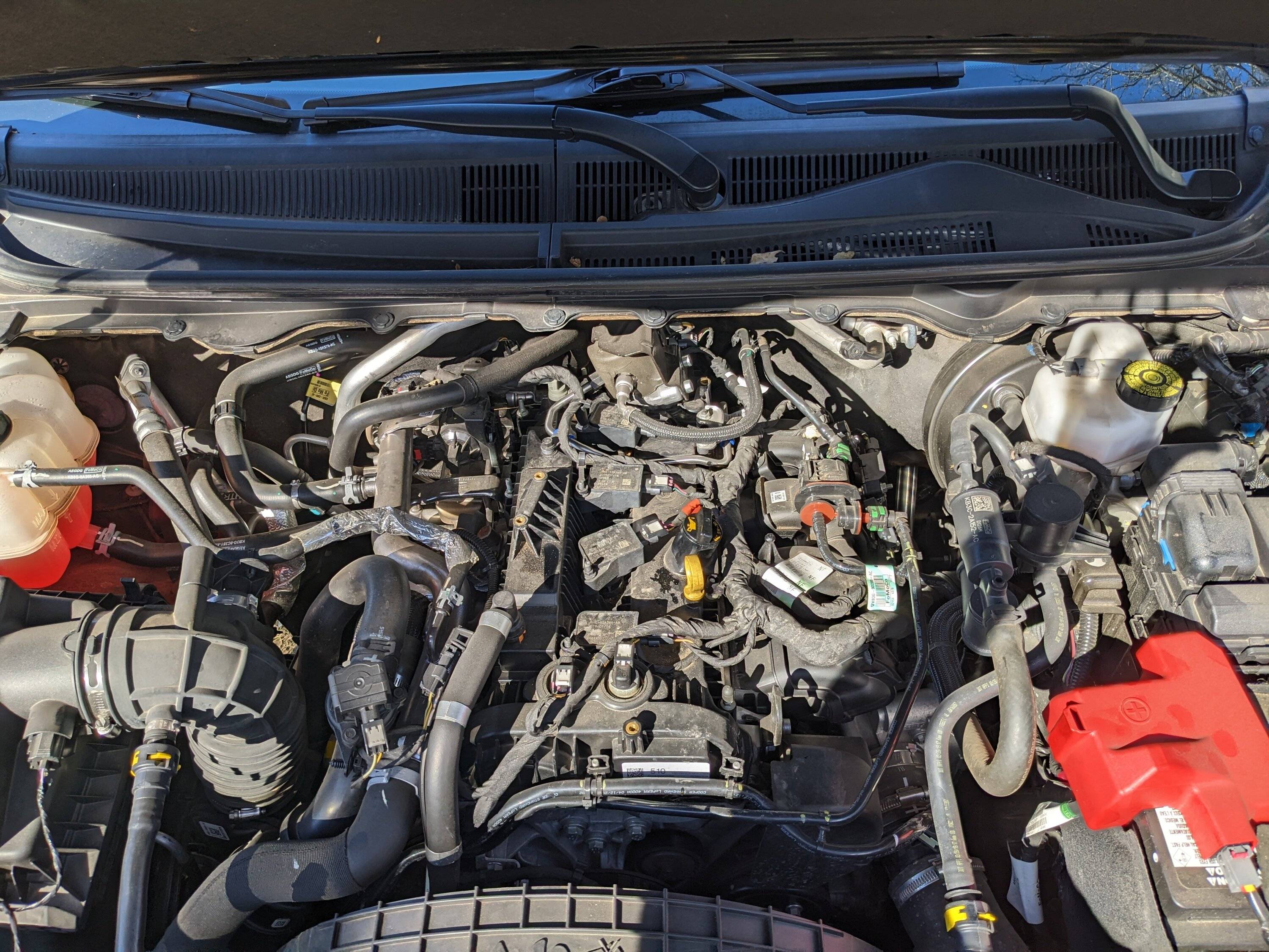

Here's a picture of the engine. Not sure what to check on a spark plug? Air Filter& oil just done. Would it be worth putting premium gas in our does that not matter?
Looks pretty normal under there. Could still have a tune loaded on it.
