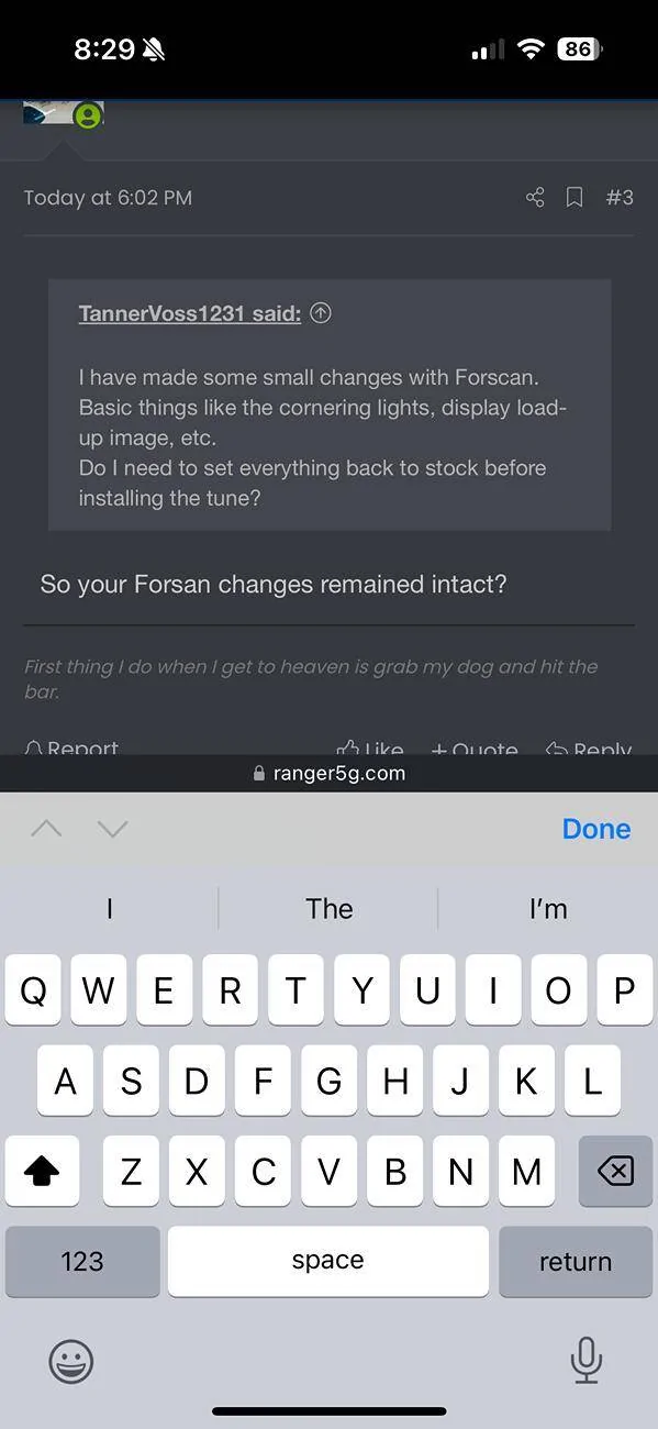

So your Forsan changes remained intact?

did you mean to ask me? If so, yes. All my changes have stayed. Fogs are DRLs, tire size change, fuel tank size change, etc.
Yes, that's why I replied to your post. And thanks! Good to know.
