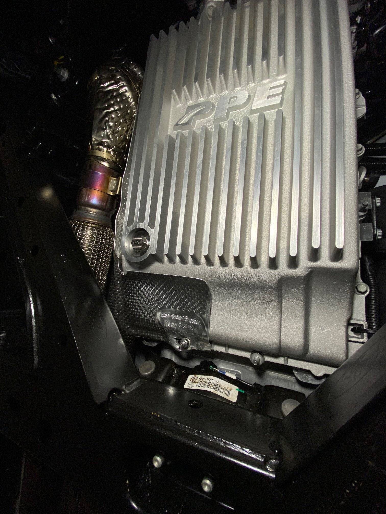

I added the PPE pan to mine as well and installed a "Glowshift" brang temp gauge in the threaded side port. It seems to have dropped my trans temps about 8 to 10 degrees, and in the Texas summer you need all the help you can get lol.

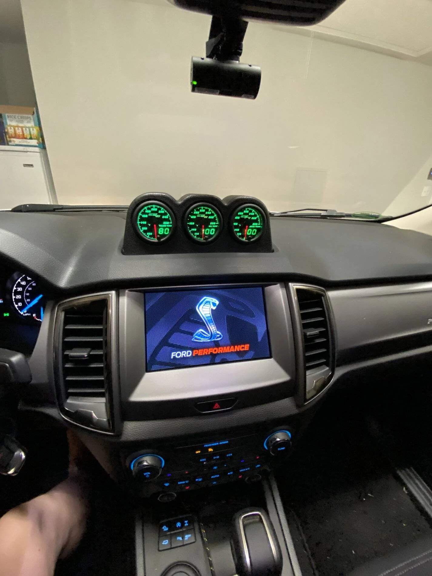

Thank you Glowshift has amazing tracking and order follow up.
I have everything now( pan, fluid, 12 V transfer pump, filter)
ordered pan gasket and filter O seal just in case, were you able to
reuse yours.
Located micro 2 switched for gauge, taping headlight feed wire,
Whoever put that dipstick cover plug there and loosely fit
19 mm size really don’t want us to do this upgrade.
thanks again.

Where did you mount the glowshift gauge?

Got the pod to put it on dash left side,
Have not done it yet.
Finding micro 2 fuse tap, ignition controlled fuse, 35-37 small ones in dash fuse panel left side bottom.
thelight for it is disposed to be self dimming and needs switched control,
Headlights are on relay, going to run wire
From bulb feed?

Those are pretty tall.
Are they hard to see over?
They look taller than they are, they are really about 3 1/2 in tall
