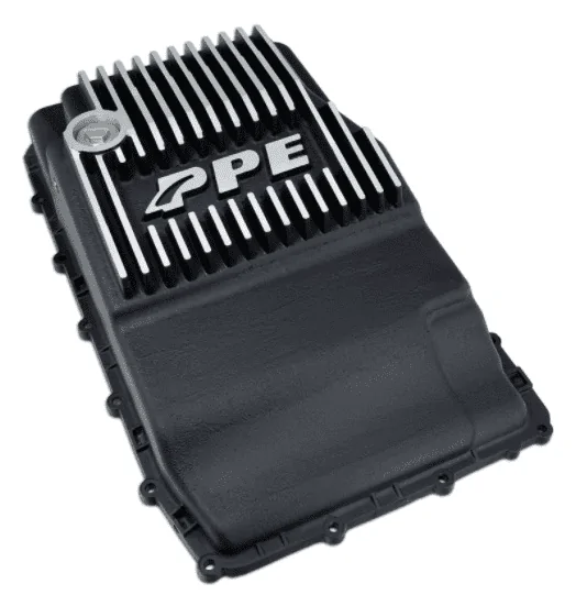

Installed PPE transmission pan

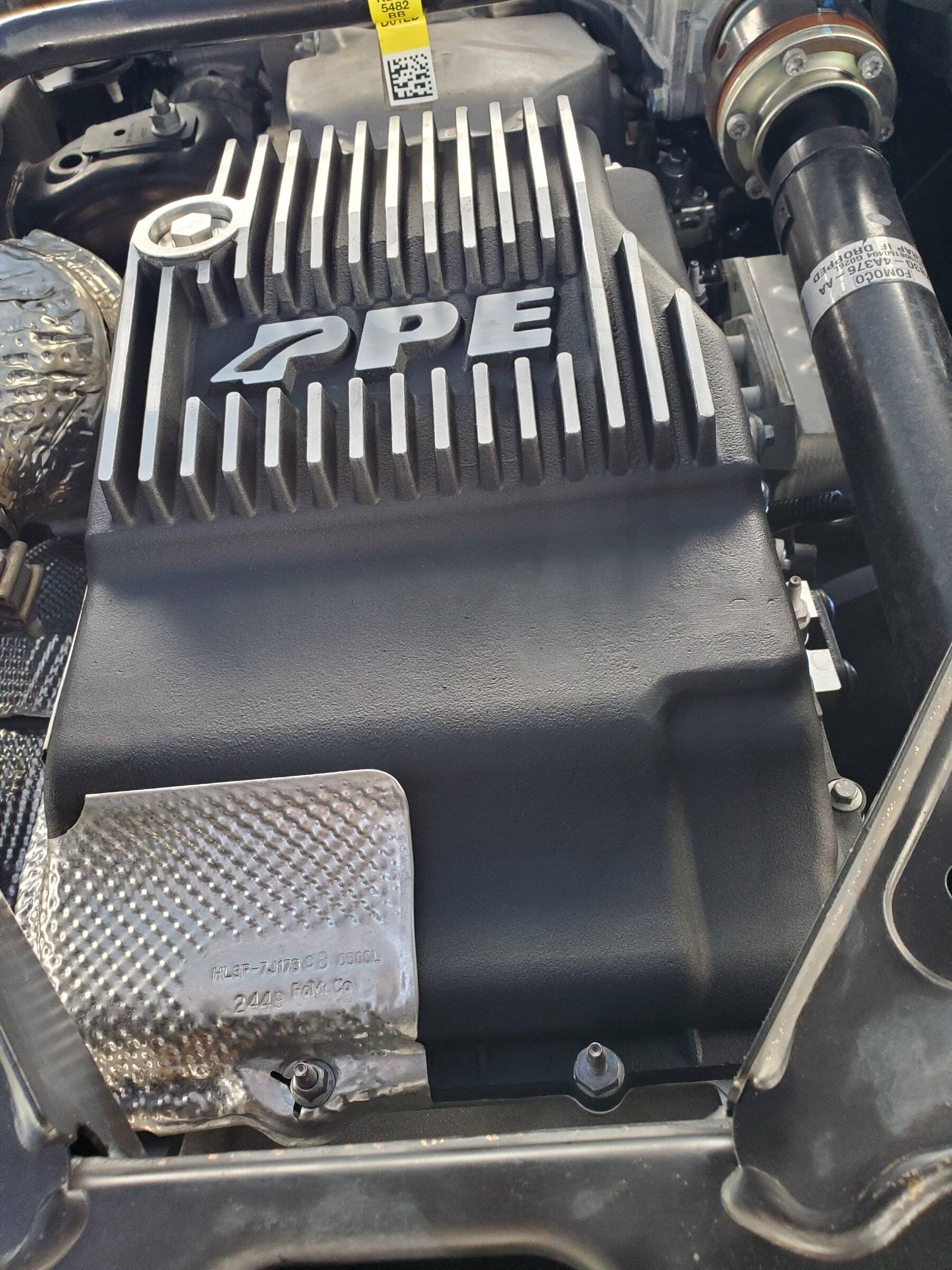

Well done! Can you share some pics of the dipstick install?

I too would like to see the dipstick installed. Also is it big enough to actually fill through?

Yes, I just put a small funnel into the hose directly and it can be filled cleanly. I had temporarily removed the dipstick to put the OEM assembly back in and have been lazy to reinstall it. I will get a photo in the next couple weeks.

Thank you for update!!!

Yesterday I took my wife's 2019 Ranger to my local Ford dealer and had them remove the transmission pan, drain whatever transmission fluid came out, replace the transmission filter and reinstall the new PPE deep transmission pan (brushed finish). It took almost 9 qts. of Motorcraft MERCON ULV Automatic Transmission Fluid XT-12-QULV to refill the transmission to the proper level.
For those of you interested here's the parts list:
PPE Deep Transmission Pan (brushed finish) - 328053110
OEM Transmission Filter - L1MZ-7A098-A (Motorcraft Part # FT215)
Seal - Transmission Filter - 7T4Z-7Z302-A (not included with the transmission filter)
Gasket - Transmission Pan - HL3Z-7A191-B
I will be doing this same thing next week with my 2019 F150
