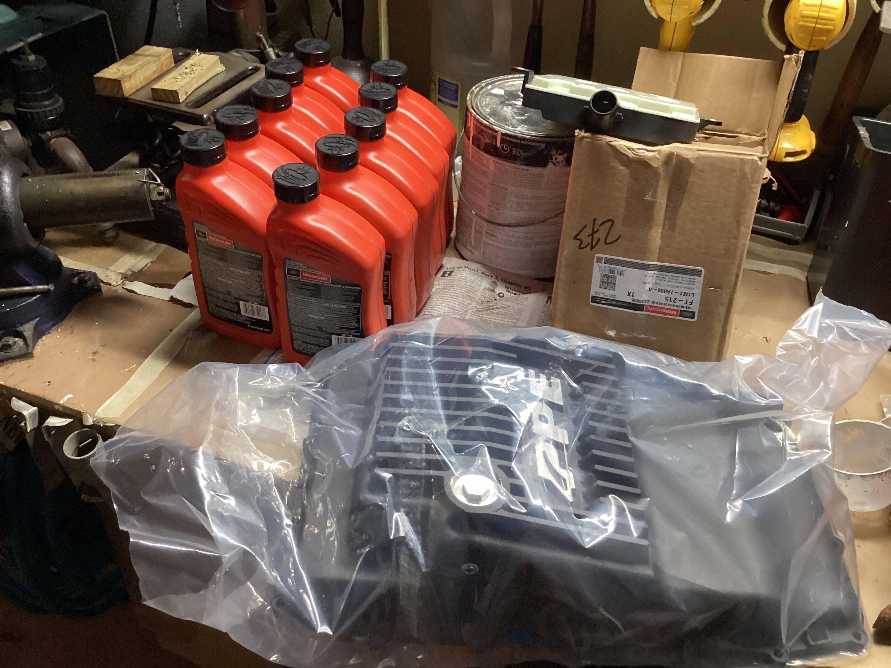

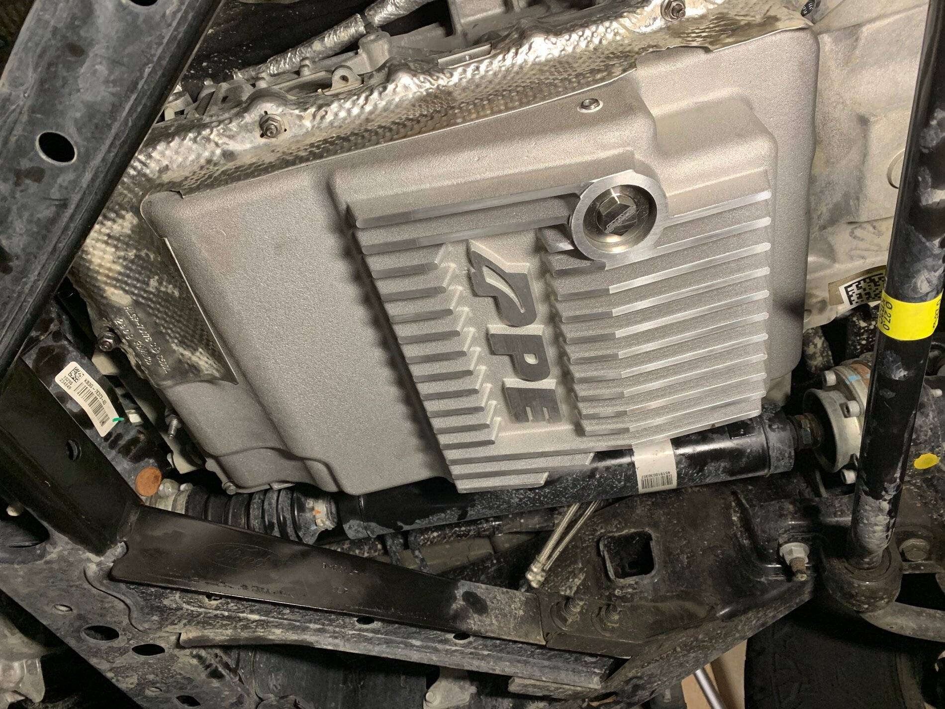

Today I installed the PPE cast aluminum extended capacity transmission pan. Its a very nice high quality peice and I look forward to having the drain plug. I took my pneumatic brake bleeder and sucked out 5.75 ish quarts, then removed the stock pan. Ended up putting in a little under 8 quarts to get the dipstick back to the correct level. When i initially checked the dipstick it was at (3) when the engine was cold so i tried to fill it back to that exact spot. Also installed the B&M trans dipstick, woah are they proud of that at $200 for a couple fittings and a piece of hose. Made marks on the B&M dipstick with a knife to matchup the numbers (3), (4) and (5). I was surpised by how dark brown the ATF was after only 21k miles, so was glad to add the new fluid. I should have done the trans filter, but I didnt have one, ill install it around 40k or 50k miles.

when you had the pan off what kind of filter does it have, a screen or a real filter?
It is a corrugated filter. Media much like a normal oil filter, but flat.
So I have a 2021 Ranger Tremor, I'm guessing it will be the same pan as you bought. I really don't want to have to buy the B&M dipstick. So a little under 8 quarts would you say would be around 7 and 3/4 would be what I need? And If I change the filter that filter would hold I'm guessing a quart. So many around 9 quarts with a new filter? What's your thoughts? Thanks
