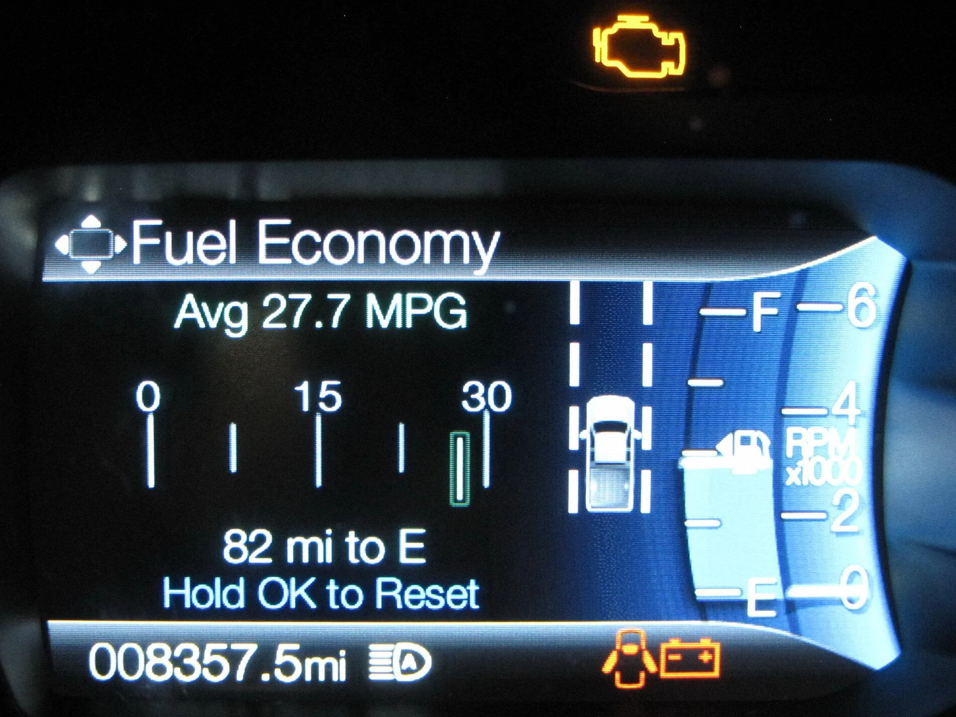

Exactly, the last thing you want to do is run your tank dry. The fuel pump uses the fuel in the tank for cooling, especially with modern high pressure injection systems. So, the DTE number is intentionally a conservative number. you burn up the pump and you go nowhere, no limping anywhere. The DTE resets anytime the truck sees the level in the tank go up. The amount of fuel in the tank is a best guess based on what the level sensor sees. So, if you don't fill the tank, The DTE will be less accurate than if you do. The most accurate number is 19 gallons when it says full.

I often get wacky estimates. How do you explain the above? It's usually because I've been towing a trailer, and then when I let it loose the very conservative algorithm that Ford chose assumes a worst case scenario for at least the rest of the tank, and well beyond the next fill-up.

Yeah, I've wondered about the DTE stuff too. Good explanations here. The other cars I've had that did similar mile warnings all came on when you actually were on or very close to empty. For example, the Santa Fe SUV I traded in for the Ranger would say 36 miles to empty when the gauge actually showed empty. Ranger starts saying like 50 miles when I hit 1/4 of a tank. I'm sure it's not accurate, but like it's been pointed out, it's a better reminder for me to fill up since it's not good to get it that low anyway.
