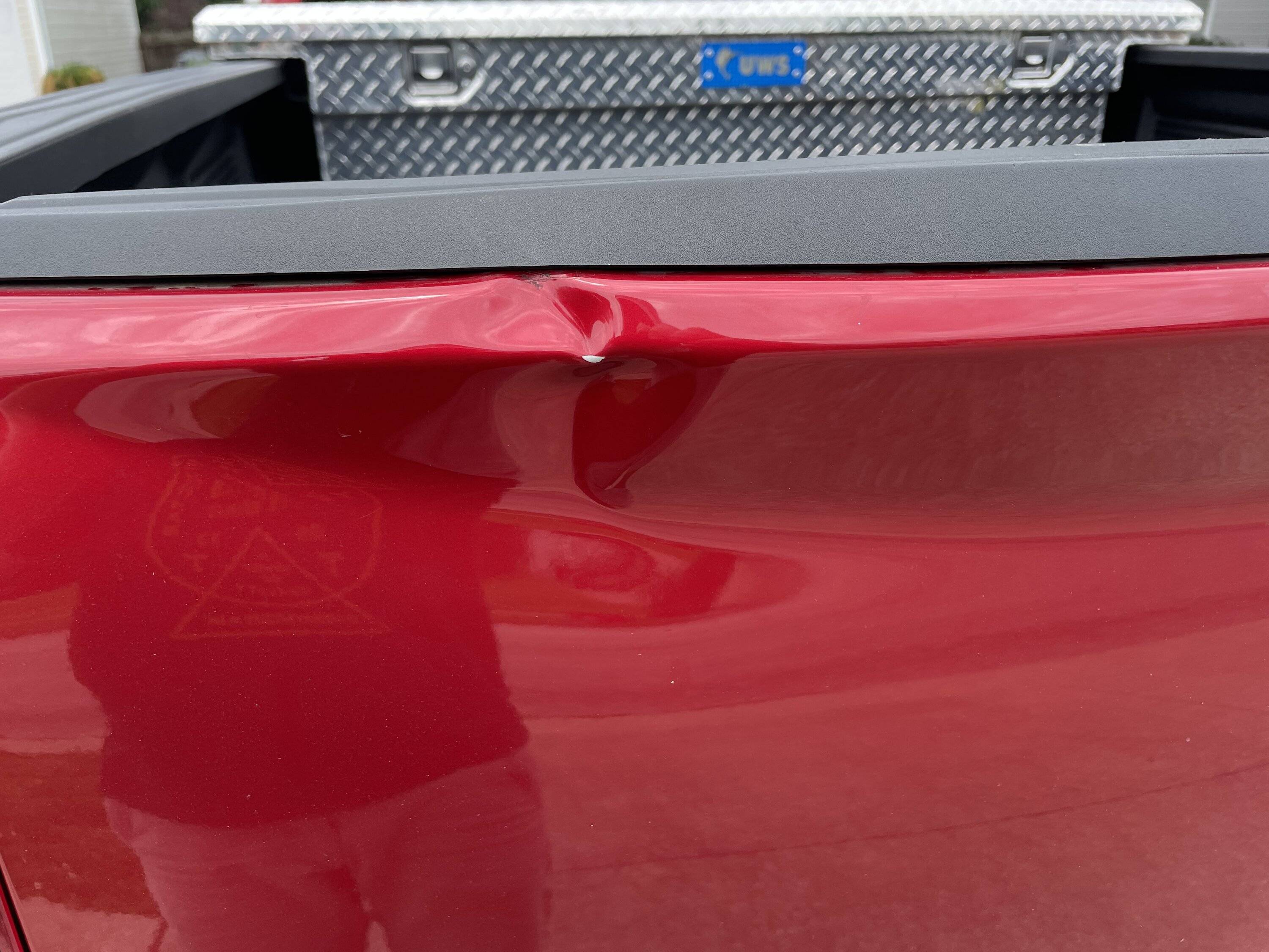

I backed into a telephone pole guide wire, so I needed to have a body shop fix the mess I made.

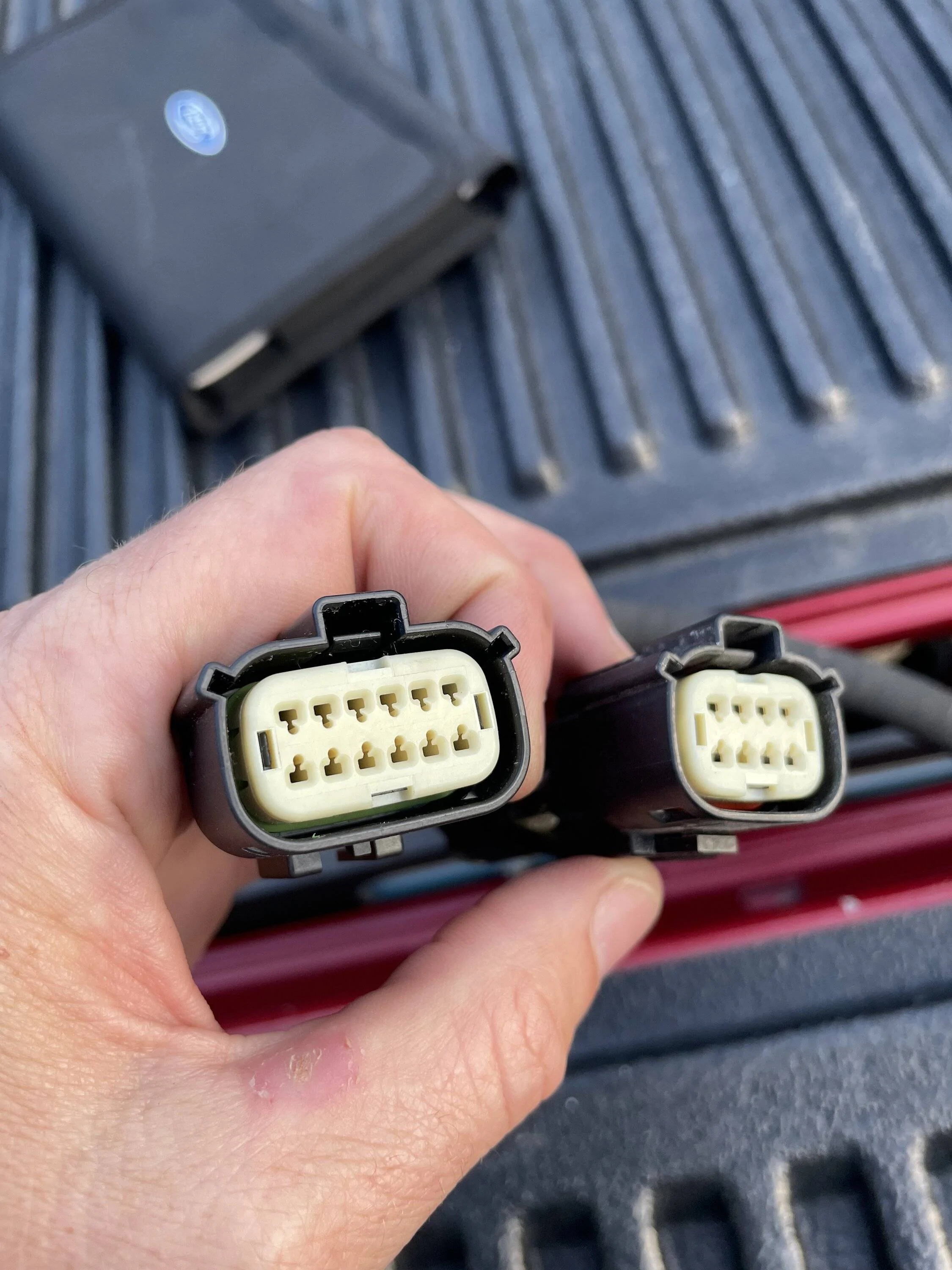

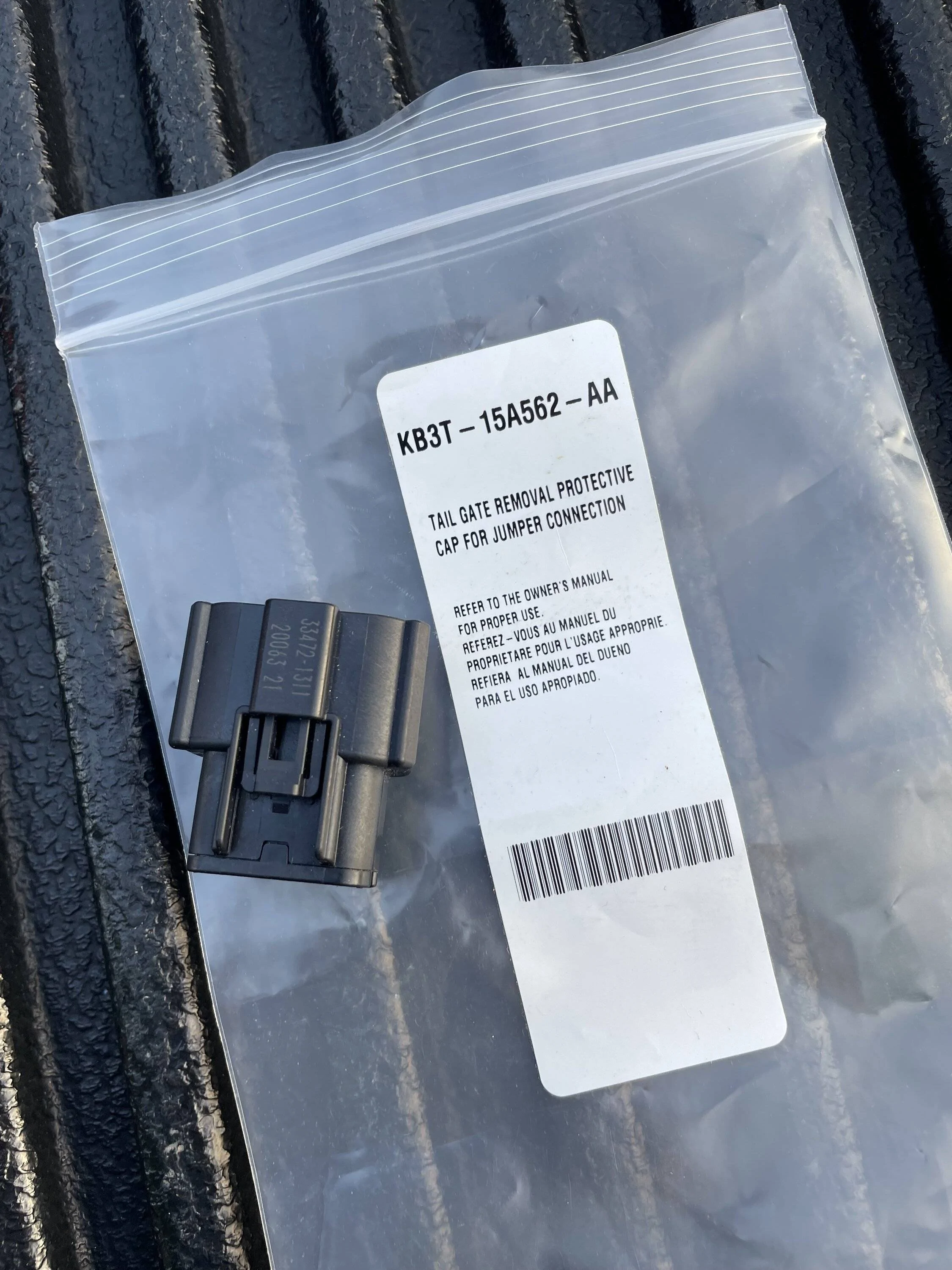

When I disconnected the wiring to the lock and camera in the tailgate, I remembered that the truck came with a plug to insert at the end of the harness when the tailgate is removed.
The problem is that it doesn't match the actual plug on the tailgate at all. The plug coming out of the tailgate is 8pin while the "protective cap" is 12pin.
Did I just get the wrong one or is this more widespread? How I'll be rolling for the next couple of days.

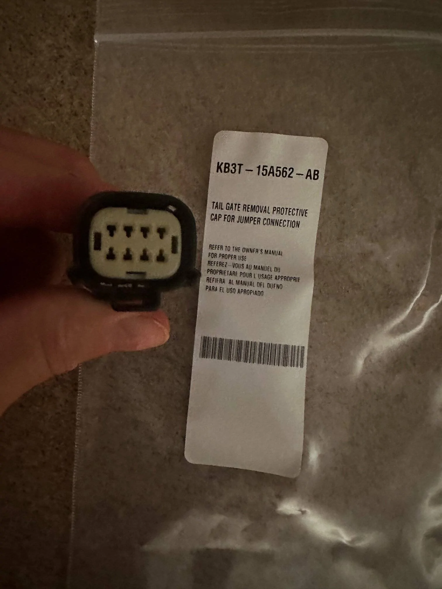

Looks like they gave you the wrong plug. Here's mine from my Tremor and it's an 8 pin. The last letter on yours is AA where mine is AB.
26,989
136,518
Thanks for the part number! Should be easy to get it replaced at the dealer.
