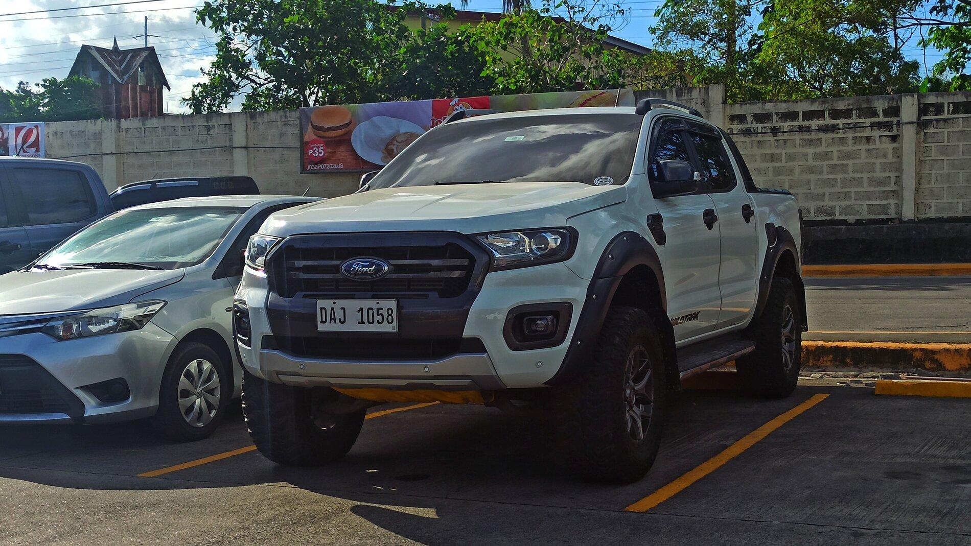

I loved the Ranger when I first looked at it, but didn't like the 3" lowered front end "rake". When I ordered my truck I ordered a bunch of accessories to make it mine. Dealer delivered the truck to me on a Friday afternoon - Sunday morning I installed my BDS 2.5" front levelling kit with FOX 2.0 shocks in the rear. I also had larger tires installed at the dealer before it was delivered (32") I just like the more aggressive look to it, fits the tires better, and handles off-road better. It's all personal - make it your own!
Looks awesome! I did a 3” level on mine and it looks like I can fit 32 inch tires on stock wheels? What brand are those tires? Looks great!

You shouldn't have any trouble with 32's with a 3" level on the stock wheels. That's what I have 9265/70/17 Nitto Ridge Grapplers) with a 2.5" level and have never had any rubbing issues.

I am running Toyo Open Country At-2 AW tires. 265/70R17 on factory 17" rims. I'm in the mountains often, a good sidewall is important for 4x4 traction and airing down when required. I also needed an "AW" rated tire as its required by law here in the mountains.
