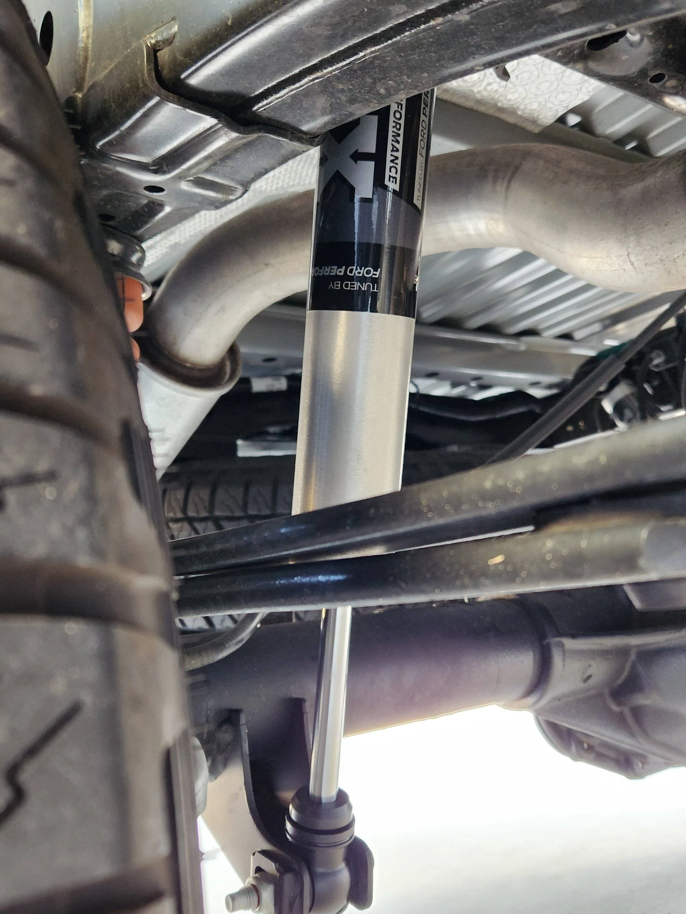

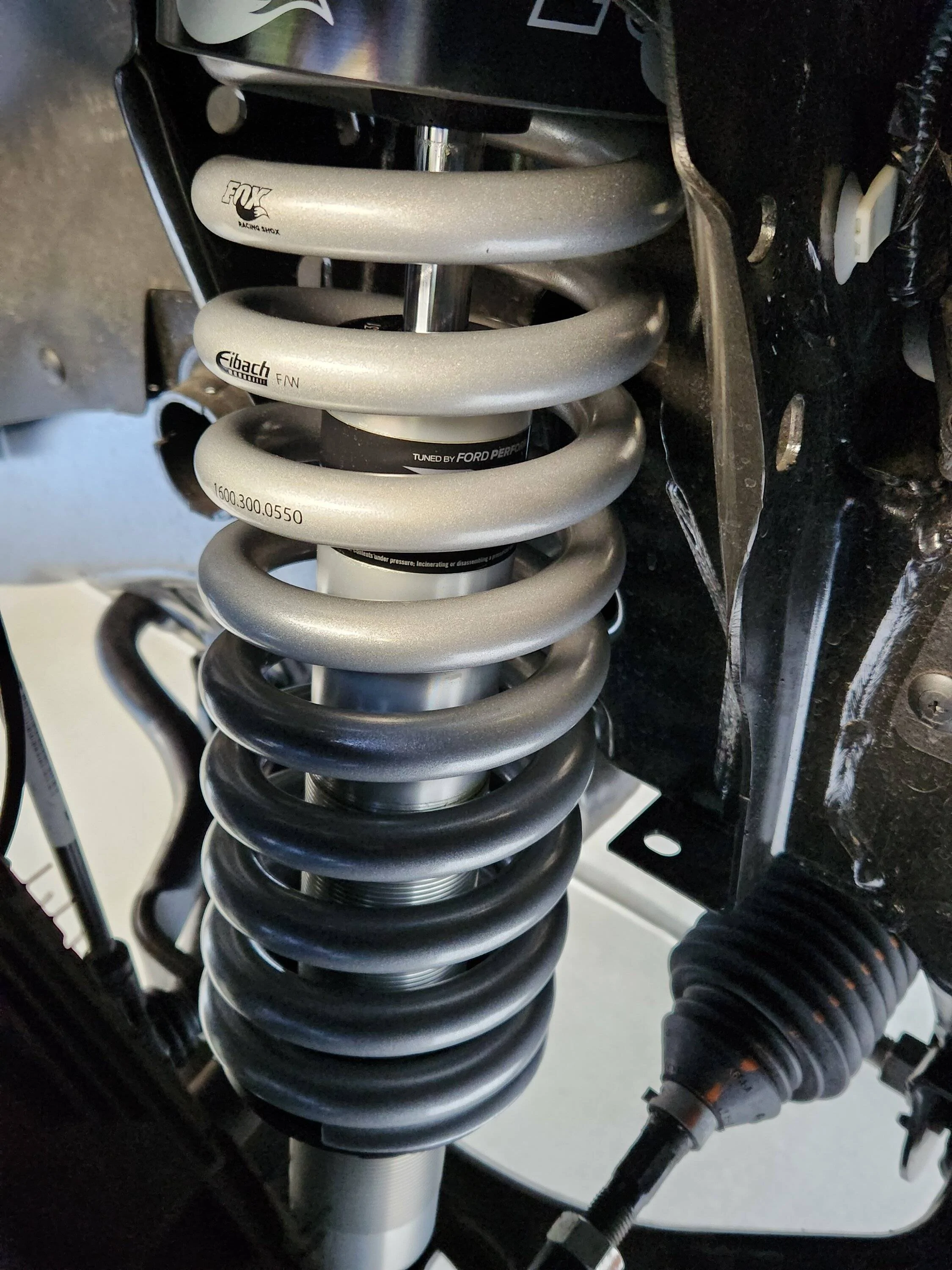

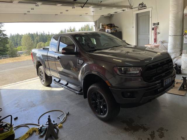

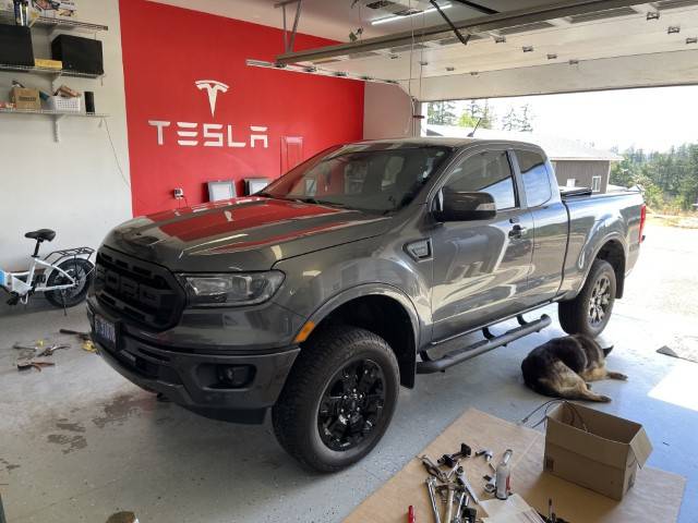

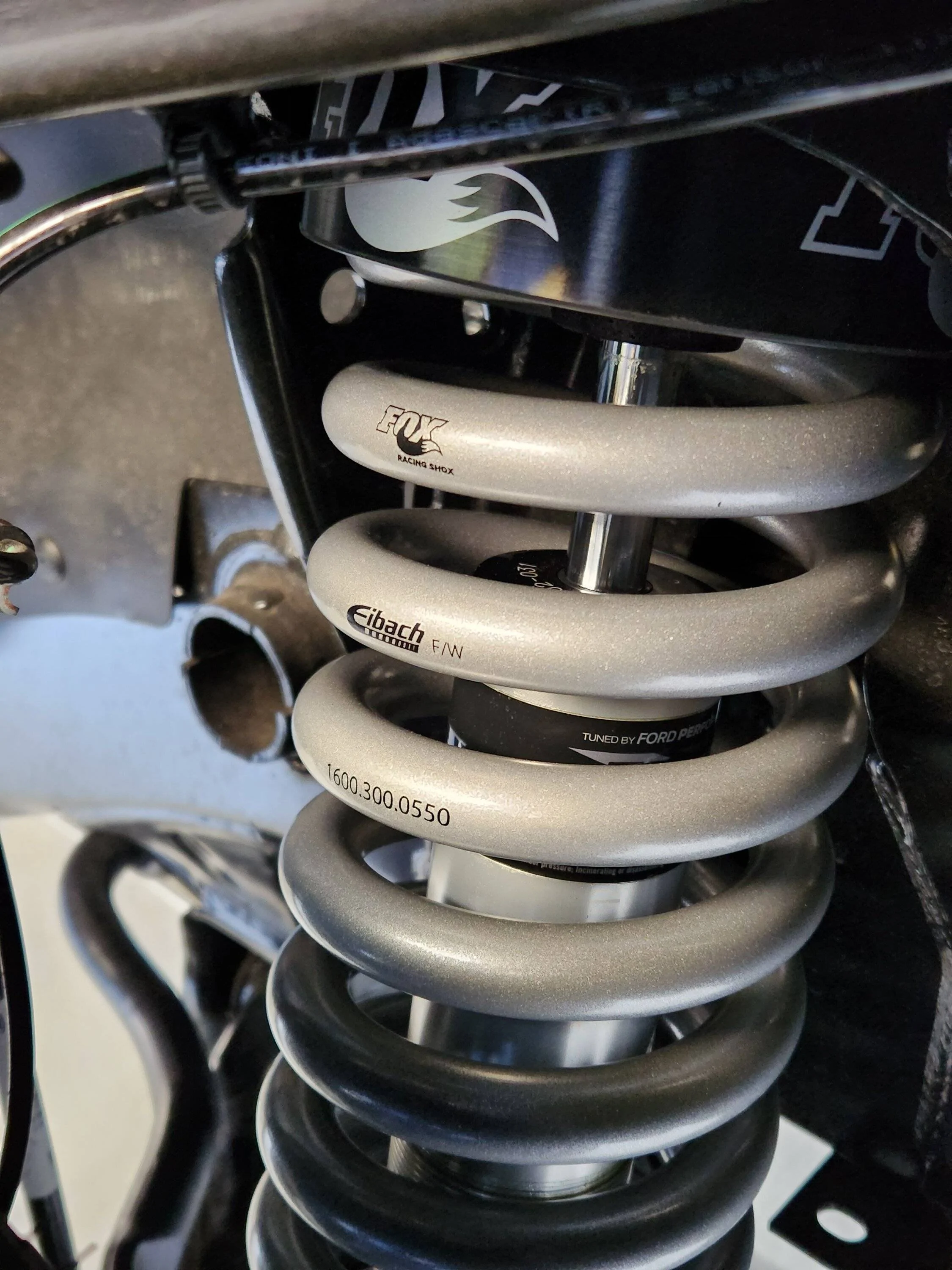

I did the rear fox 2.0 shocks pretty early in ownership, and just last week did the front coilovers and really glad I did. I don't 4wheel or tow but just the better ride quality is worth it to me not to mention it just looks meaner.
