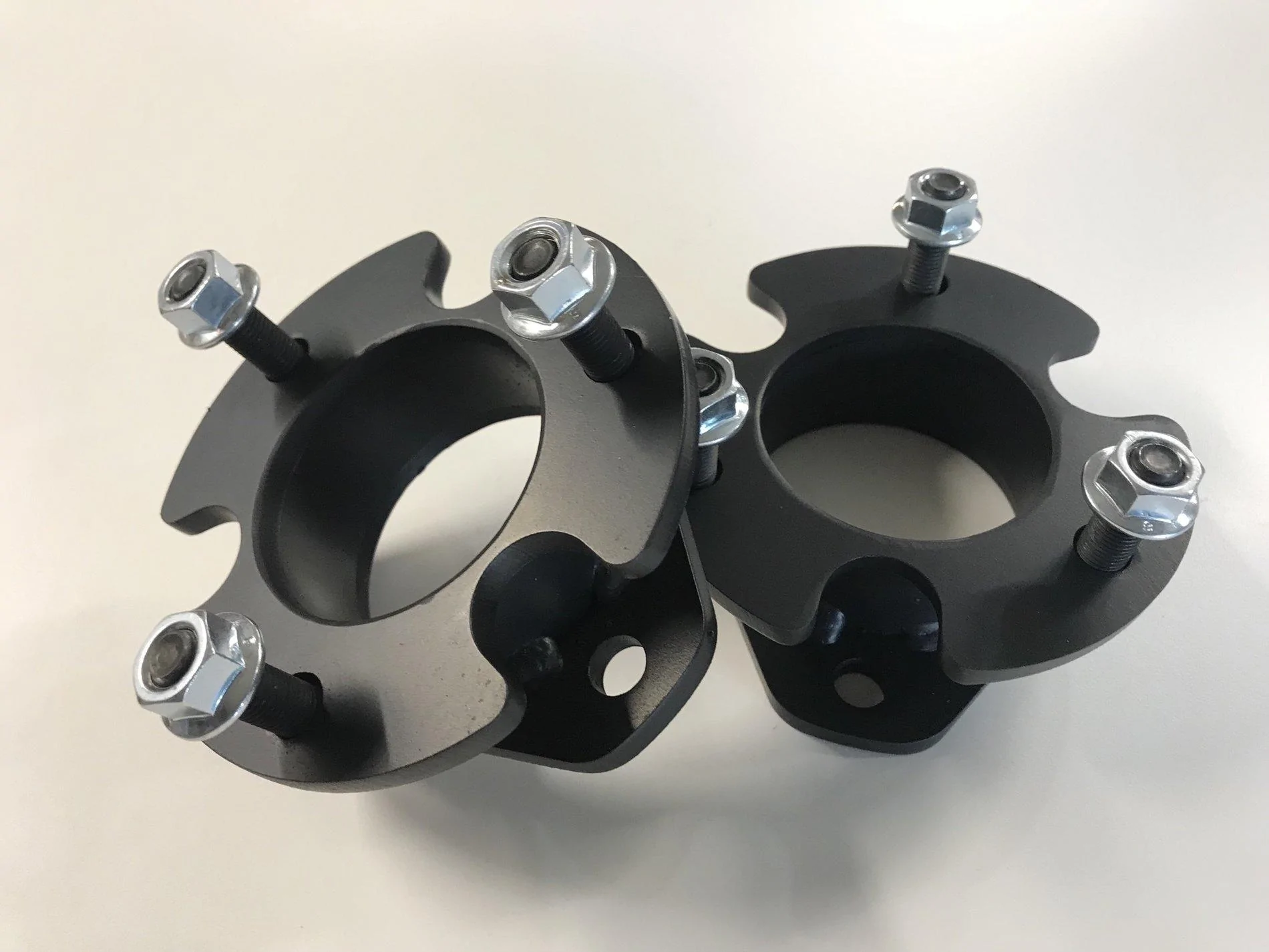

Finally got my truck fixed at Ford, it took awhile for them to order a new part and install. I opted to have @robby887 install his 3” spacer kit! He did a great job, and his way of installing made more sense than Rough Country’s instructions!
