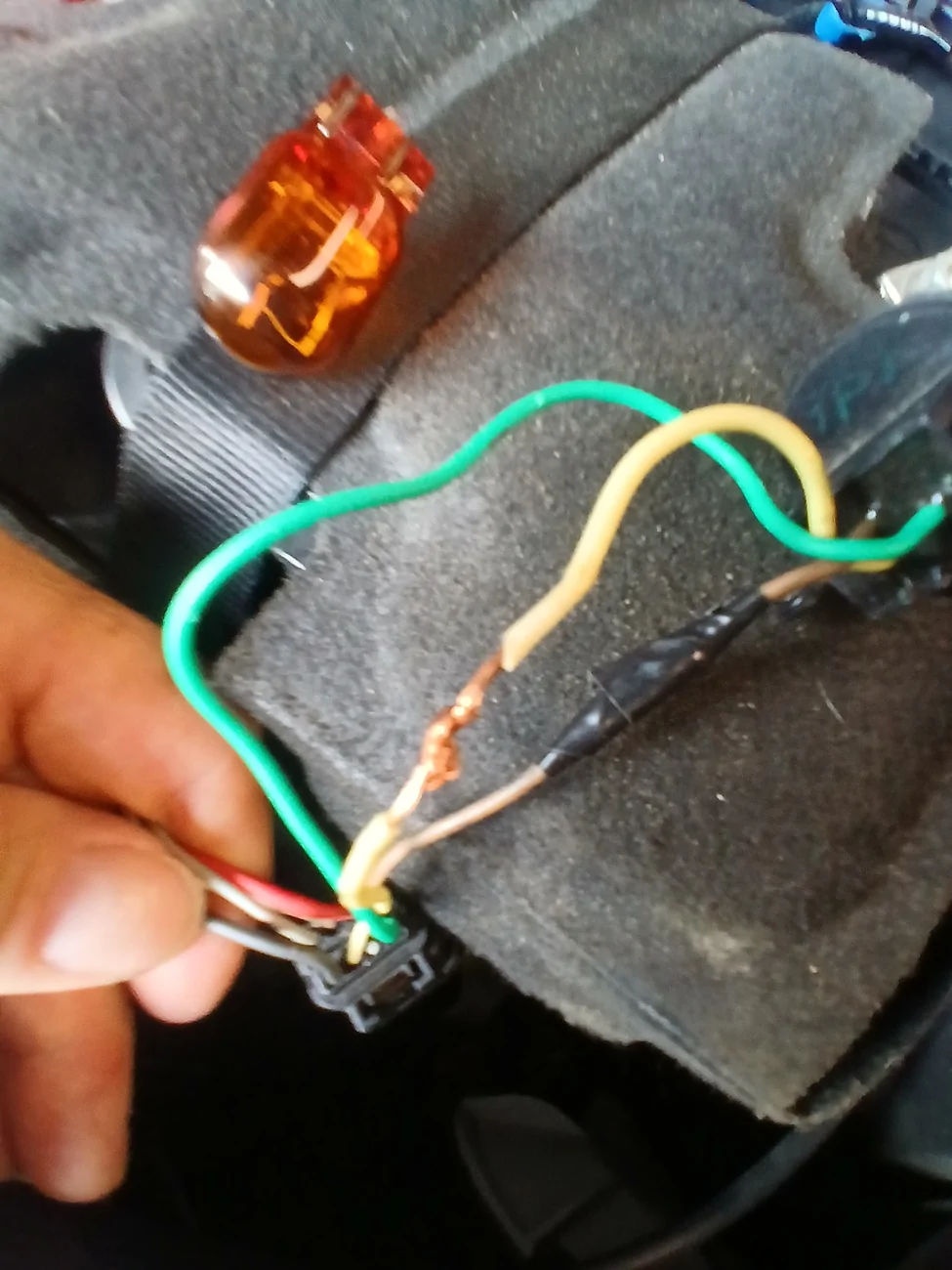

Closer inspection of the socket - it routes to the main connector - 3-wires.
As I looked at my Halo - Take Offs
The wiring diagrams do not show a individual part number for that socket, its part of the headlight assembly - I see a number on the socket 31 - OFL - C2 - 13
The only way to possibly repair is to cut away, the sealant that is on the back of the socket.
I am sure with some digging - you may be able to find a replacement socket that will match the (Locking Tabs) but the Ranger wiring diagrams do not even give that connector a (Connector #)
It only lists the main connector C1021 (Left) and C1041 (Right).
I have a feeling (if warrantied) they will replace the entire headlamp assembly

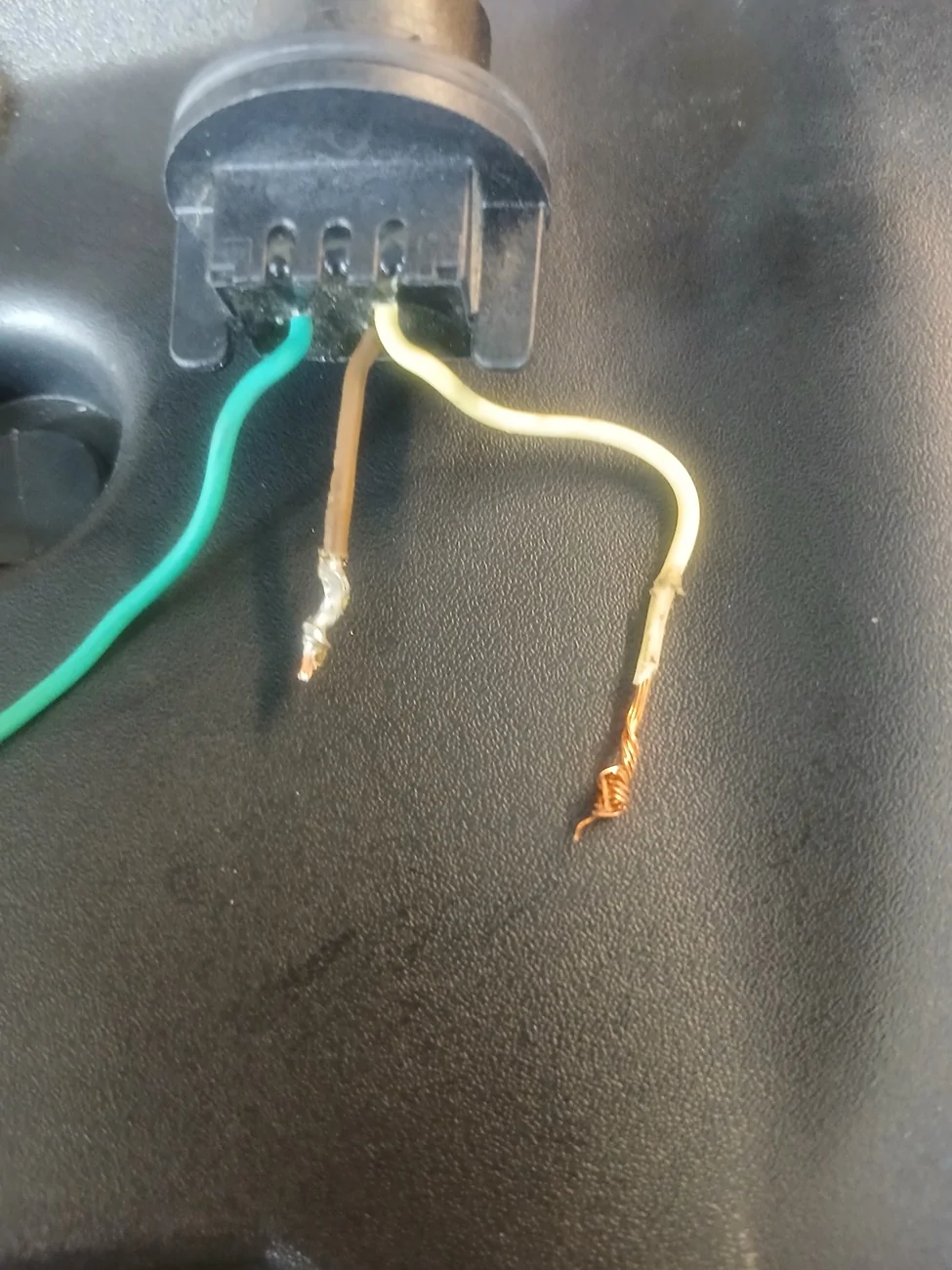

So I go out and look at my socket and see WTF and I find this ...
They cut it in 2 places , how is this not on them now ?

He tried to solder one , gave up on the other...
