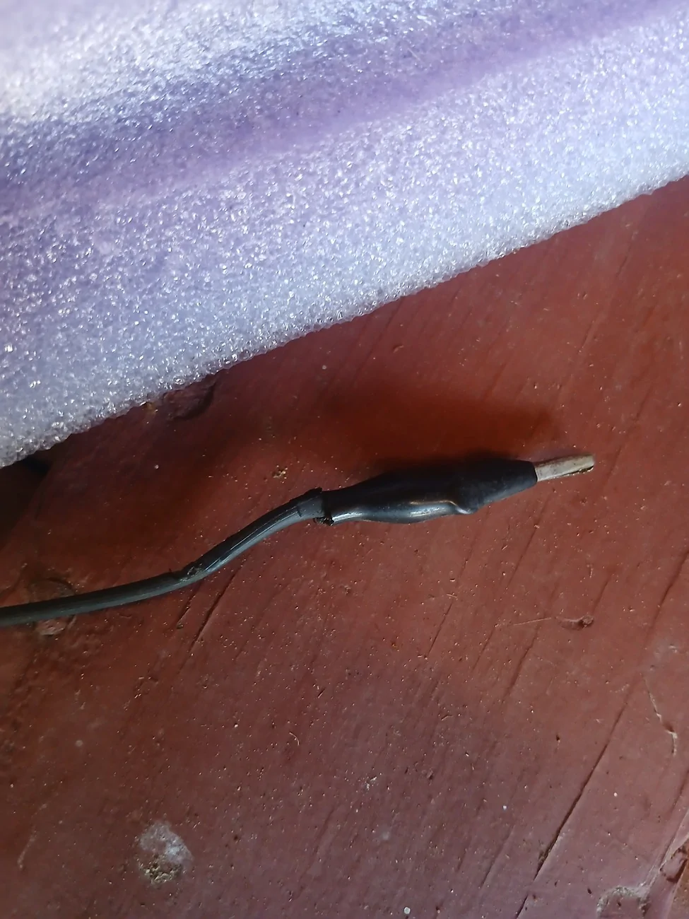

I switched the good one from drivers side to check but no change ... I guess I need a meter to check the wire for voltage?
Yes, that will show if there is power to the socket. If you have voltage to the splice but the bulb is not lighting, then there is a problem with the socket.

Well i should have lead with that...
And what follows is the most I've been embarrassed for a while (and still had my clothes on ) normally I would just disappear and not share my stupidity but here it is ...
That stupid jumper came apart inside i guess 😒, when I used the meter with the "tone" option , nothing... ALL IS GOOD NOW !!!
I now feel like an idiot for wasting your time ! I apologize 😔... I used the jumpers so I wouldn't have to stick my fumble fingers down in there while testing, never dreamed one would be bad... sorry 😞and THANK YOU FOR HELPING ME!!!
