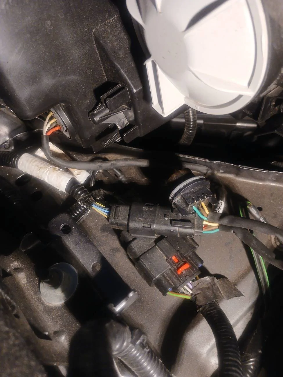

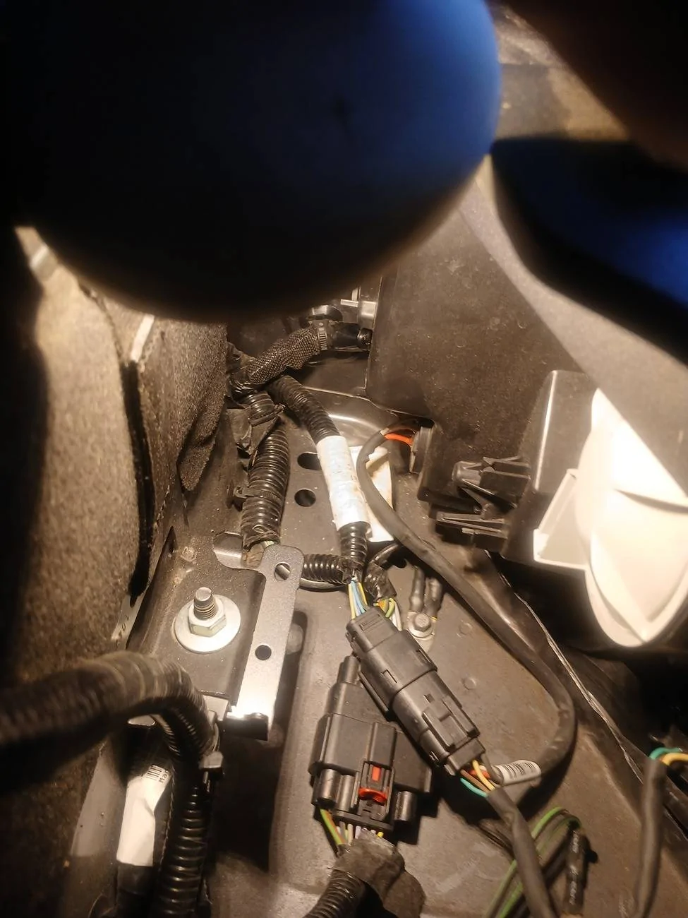

so I look down in there to see if the socket unplugs closeby and I'll be damned right there it is ! But, it pigtails off and goes back to the headlight into what looks like another bulb but isn't? (Orange wire )

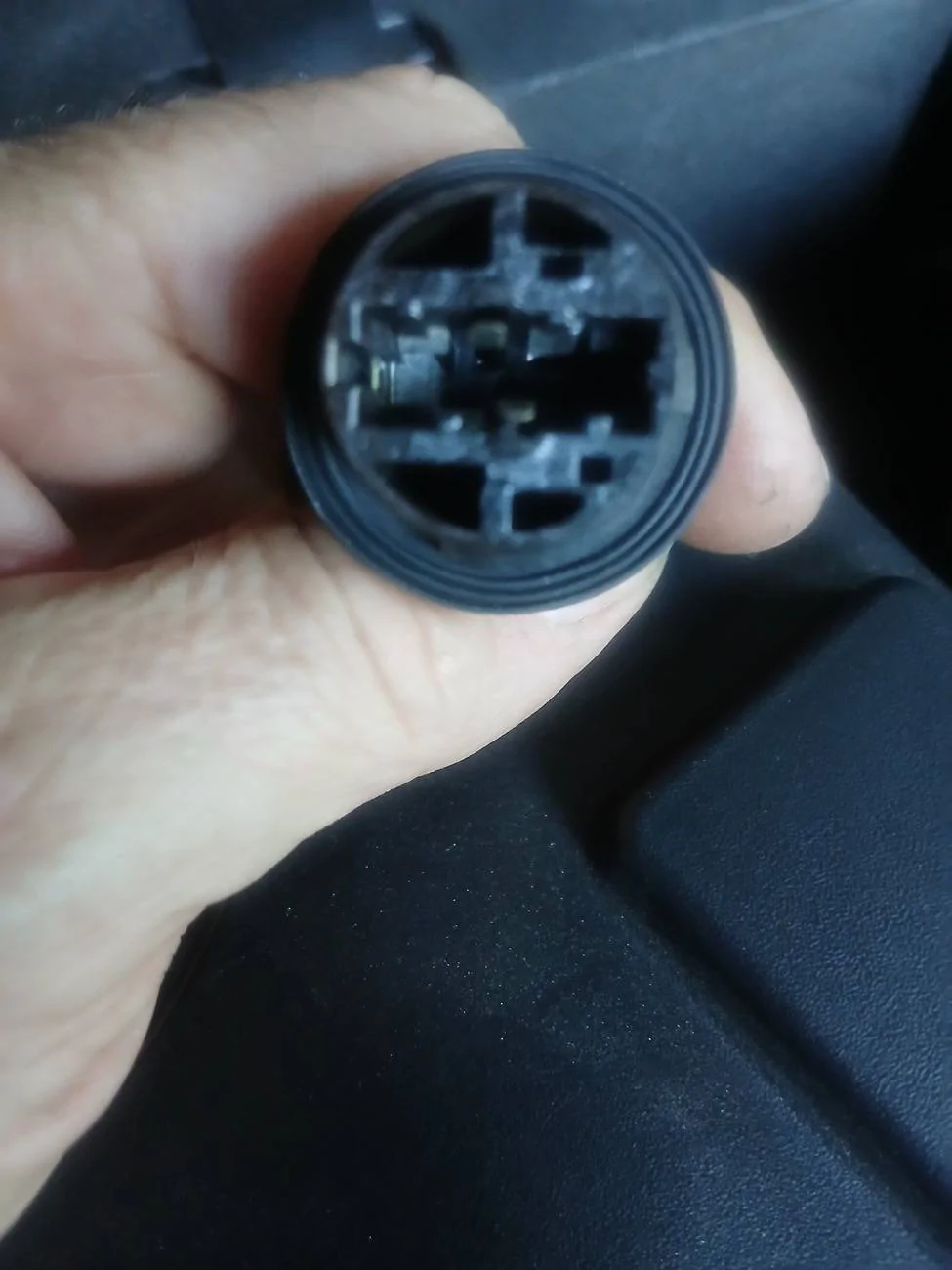

Tried bending prongs on bulb and socket and I got it blinking a couple times but now if I push on it hard it just goes off , not sure how or why but the socket is messed up inside...

Well, at least you know where the problem lies.

The main harness goes into the assembly and then routes back out through the grommet (plug) to the turn / park light socket, I will have to dig , when I get a chance in the AM to see if the turn / park socket can be purchased as a separate pigtail.
You may try to see if you can get the socket apart enough to check the wire connection to the socket and also use a pick or small screwdriver to spread the contacts apart for better engagement on the bulb, if the pigtail can be purchased separately without having to buy a headlight assembly then it would be a simple splice

I did bend on the prongs a bit , bulb and socket , made it worse as now it won't blink at all ...
