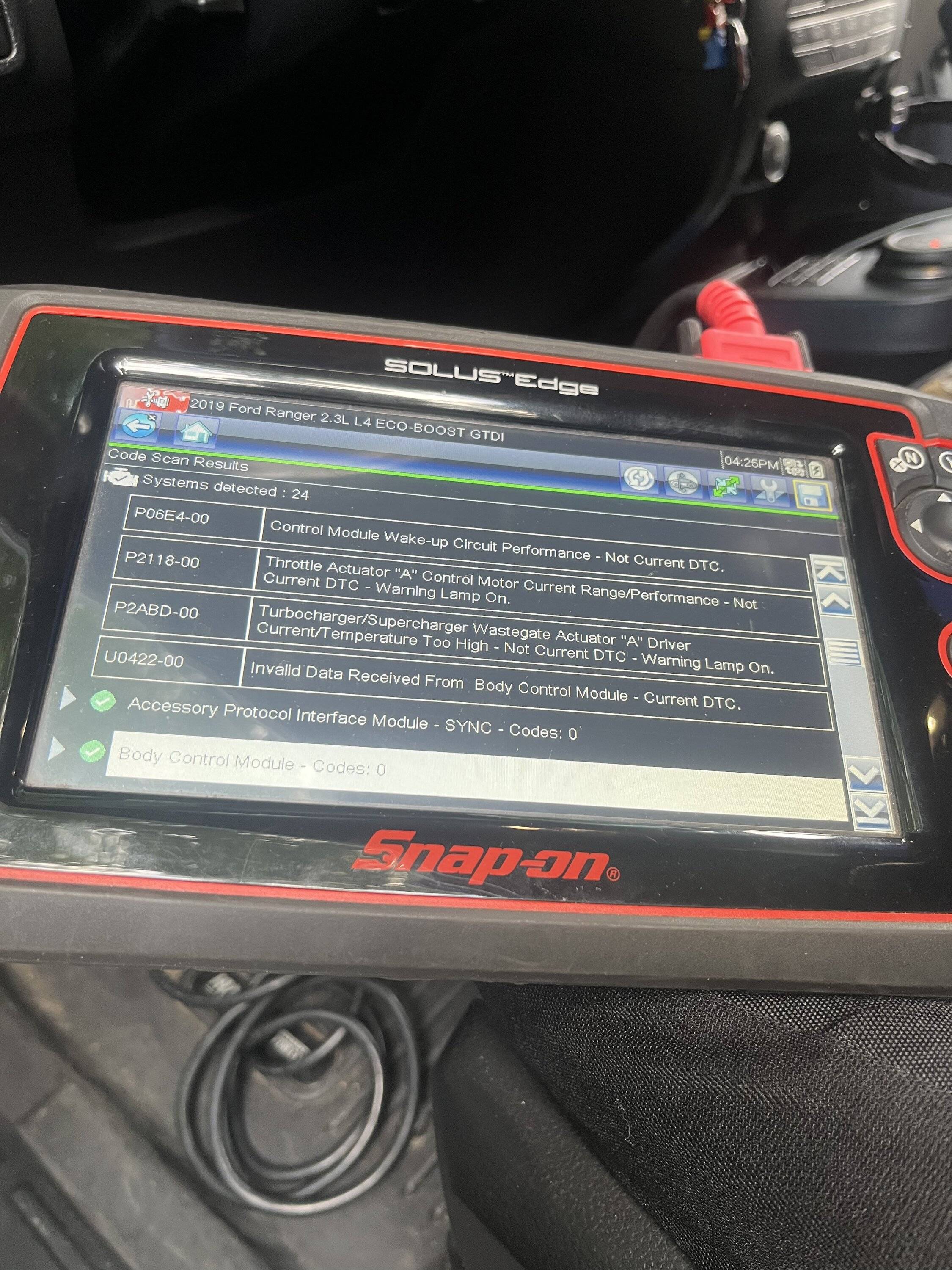

Hello all, I’ve had an interesting experience with my Ranger in the past 2 days. Luckily all the issues I had seem to have been resolved up to this point. However there is a new problem I have noticed, when I press my key FOB to lock the truck, the lights don’t flash at all. The headlights are aftermarket (morimoto XB) but the tail lights are stock and both are not flashing when I lock the truck. I noticed this tonight almost 2 hours ago. The horn still honks to notify me that it’s locked but that’s it. And when I unlock the truck it acts completely normal as in the lights flash and my particular headlights have a sequence that plays upon unlocking, startup. This issue appeared suddenly, any advice? ( attached this picture in hopes of providing any additional needed context) the picture is from yesterday when I took it to get scanned after a very concerning drive home. Btw I do believe it went into “limp mode” recently if that helps
