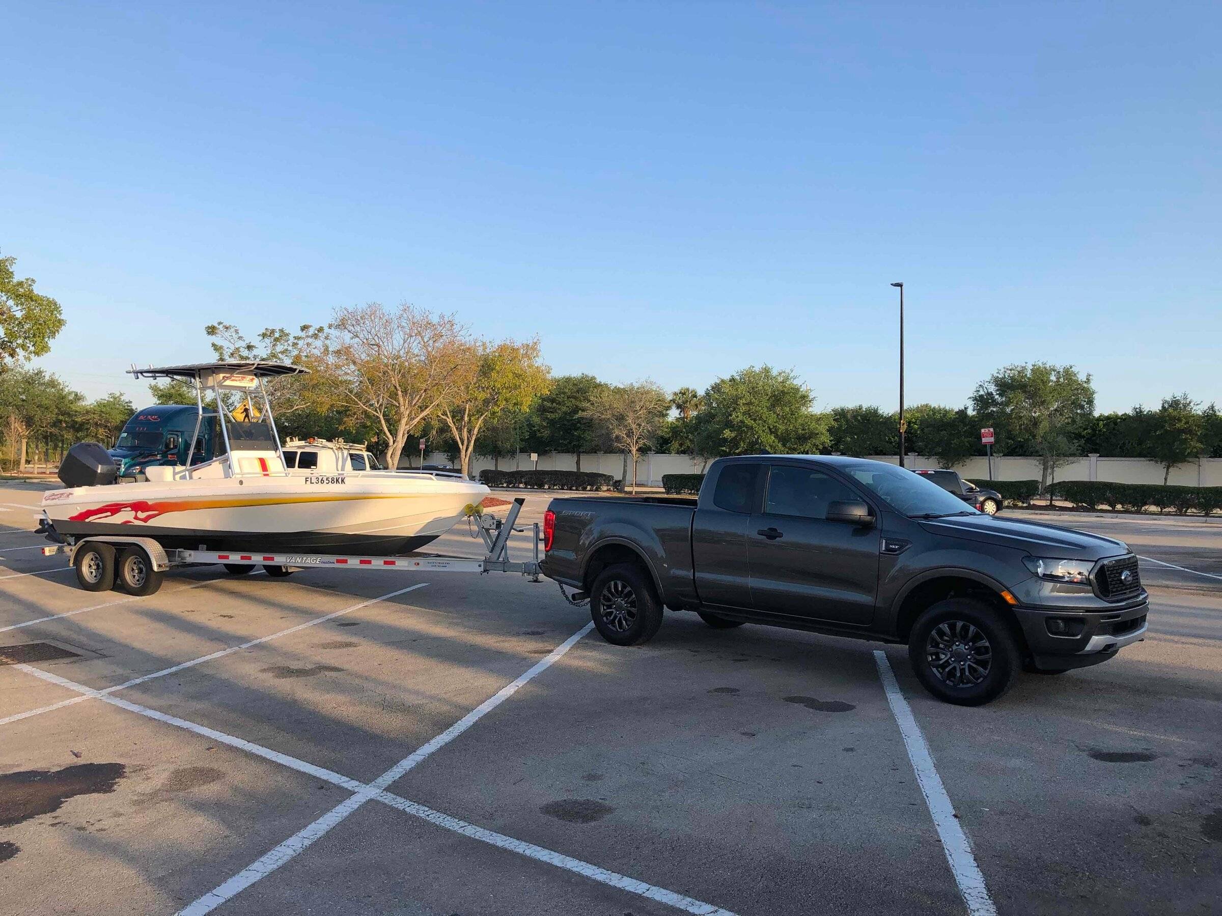

Resurrecting this thread! In looking through replies, it seems there are a lot of variables in towing, but folks are generally getting 11-14mpg towing setups I believe are similar, which is our expectation.
We're 3 days with our new-to-us Ranger and started our truck journey by towing. Traveling from South Florida to basically British Columbia -- we have time to dial our towing (and expectations).
Can anyone share if they feel this 23' boat and trailer should be getting 9mpg on flats (10mph crosswind) and 7-8mpg on hills (same wind)? Our total weight is 4100#. Trailer is a 2019 Venter with tires rated to 75mpg. Average speed through flat midwest is 68mph and 1900 rpms and Kansas hills is 68mph and 2500rpms. We're using the tow haul mode and notice the downhill engine breaking, but we haven't observed higher rpms otherwise.
What are we doing wrong? Is there that much resistance from an open bed and canopy on the boat?
Trying to troubleshoot if we have an issue, or if this is because of the nature of our setup. We really were not expecting single digit miles per gallon.
Thanks much!

We haven't seen the rpm's drop (we call it the "68mph sweet spot"). Do you think it makes a difference even if the rpm's aren't lower?
We're also getting blown away by semi's going quite a bit faster, so the speed has felt like a safety issue as well. Still, fuel economy is my first priority.
Thanks!!

9 MPG does sound pretty low to me. Just pulled a new camping trailer for 300 miles through some Colorado hills and heavy winds. It weighed close to 5500#'s and I have topper on the truck. Averaged 11.5 MPG on the way "up" and 13.5 coming back "down".

Are you running premium gas, and staying around 60mph? If not, try that. My suspicion is you are going too fast and using regular gas. Can you confirm?
I tow a 5,000 lbs GVWR trailer that is probably about 4,500 lbs the way we loaded it on a recent trip. At 60mph, with premium gas, in tow/haul mode, I get 12-13 mpg (occasionally almost 14 mpg) with zero wind. In high winds, my mileage drops to around 10 mpg, occasionally 9 mpg. That is seriously uncomfortable wind for towing, and the Ranger is 2 gears lower than it would normally tow in.

I think we may be going a little fast -- we were mostly watching the rpms, not the mph as our guide.
And we are not running premium gas; that is a good recommendation!
Thanks so much!

The manual states to run premium when towing. It will make a couple mpg difference and be nicer to the engine :)
FWIW, I always run premium. The few times I've tried regular (not towing), my mpg drops by around the same percentage difference as the price between regular and premium, if not more.
