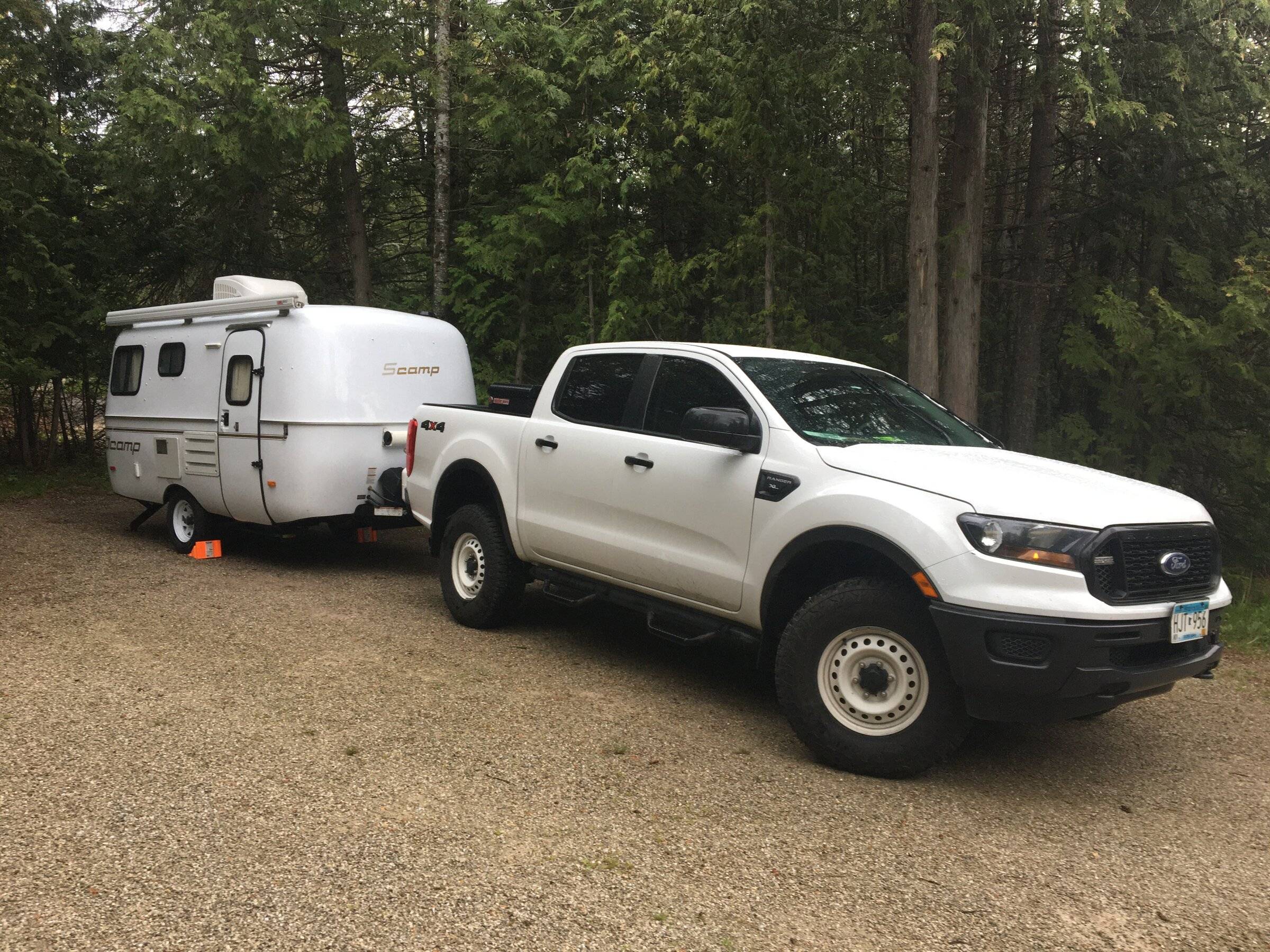

This is 3,000lbs and fairly aerodynamic.
We get 13-15 at 62mph.
That being said it’s too small and we’re going bigger.

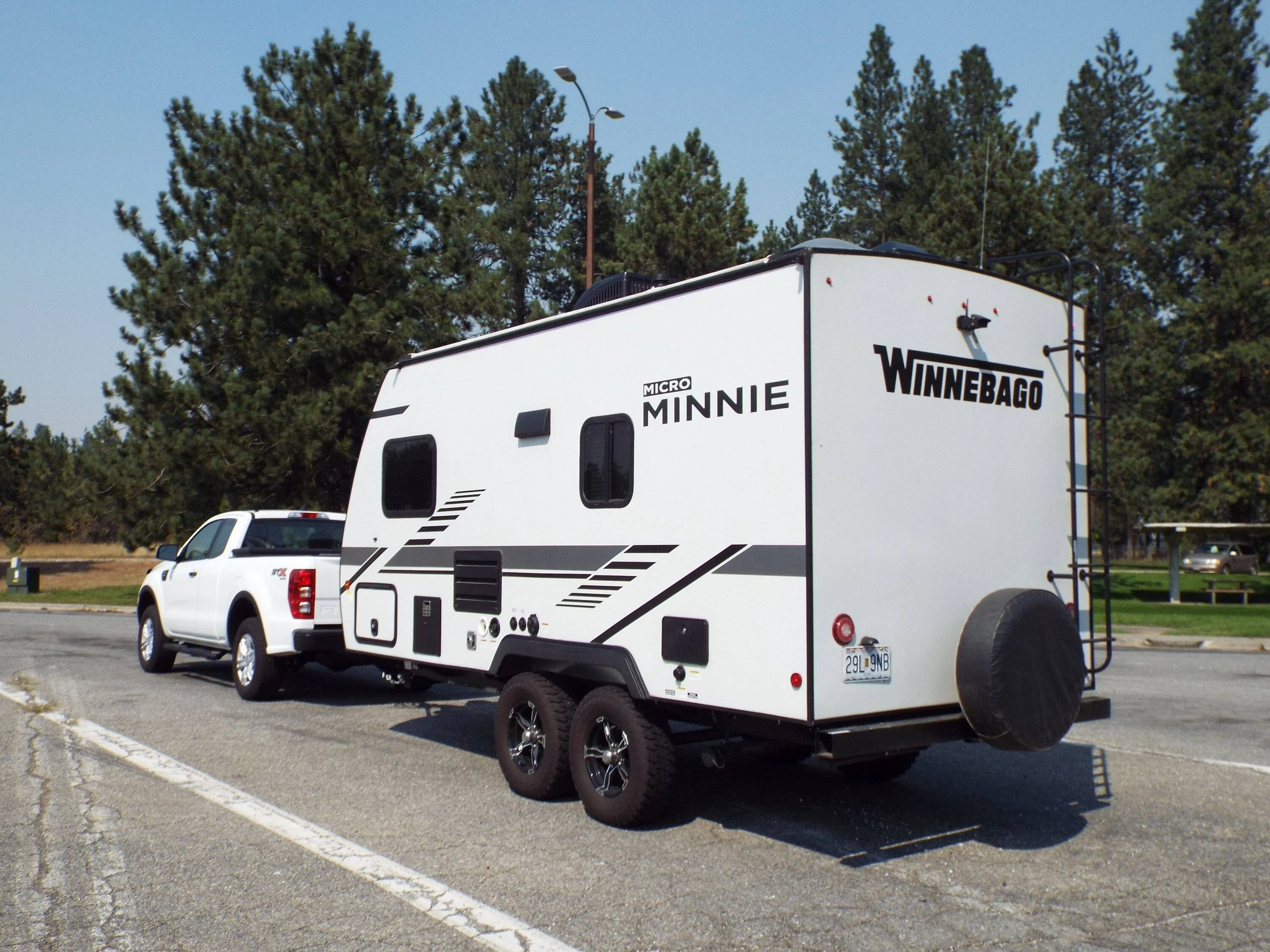

Towing our new RV, a MiniLite 2109s, pic below..... Per CAT scale, total RV weight is 5300 with 750# on the receiver and an Equalizer WDH. This is a 10.5h x 8w, dual axle trailer.
Our longest 800 mile roundtrip thus far was mostly on Florida's Turnpike, from Miami to Rainbow Springs SP. Driving 65-70mph in tow/haul mode yielded 10mpg. This is hand calculated, total miles driven against total fuel purchased. This is about as true a calculation as you can get. You need to use totals once the trip is over so that you remove as much pump / tank top off variation as possible.

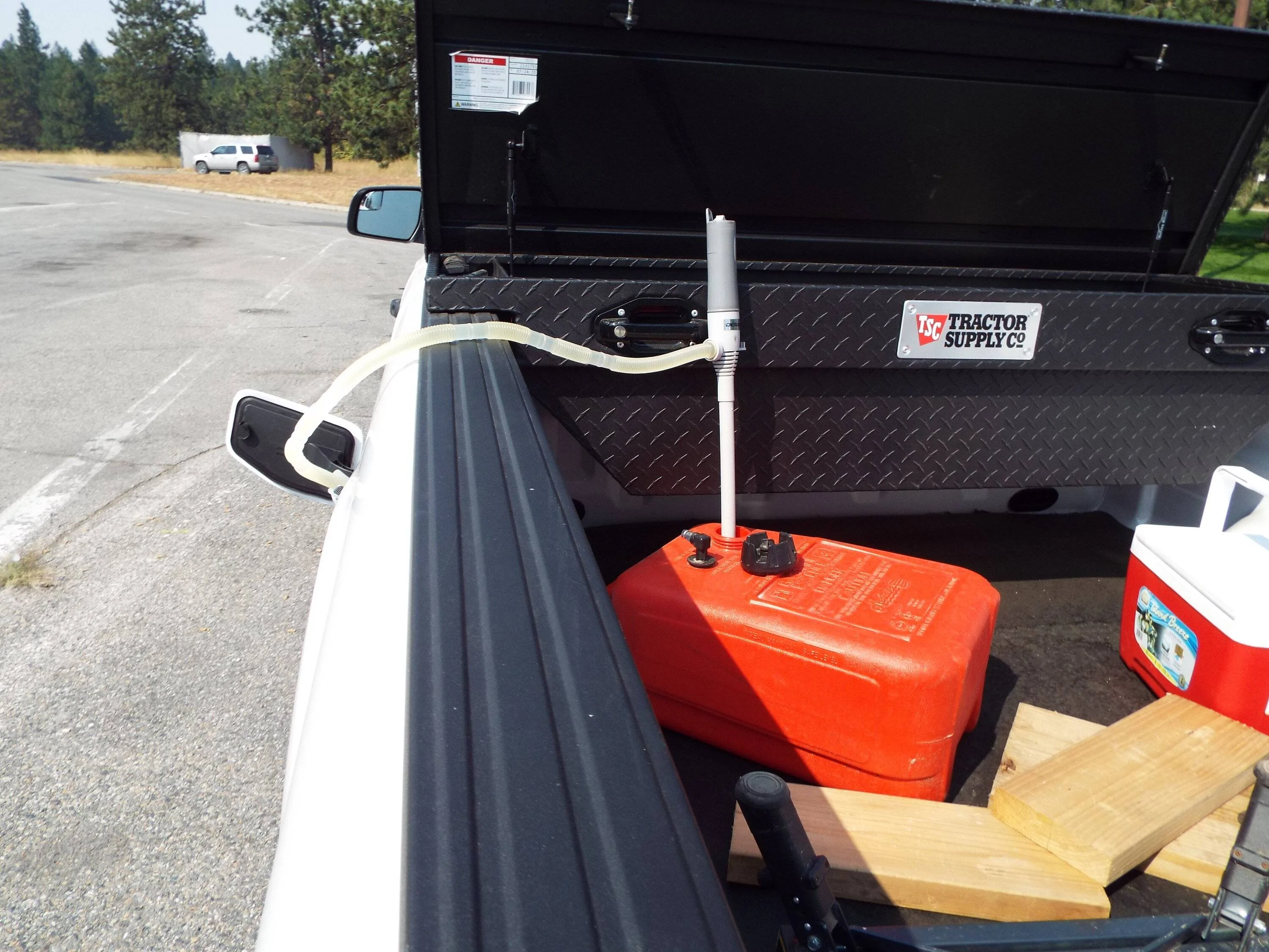

The answer to your question(s) is "It depends". Our TT weighs in at 3650 and pulls like a dream behind our Ranger. As for mileage, we've had as good as 14 and as low as 8-9. Seems like the biggest influence, besides mph, is wind and its direction. I don't believe weight is a biggie. Within reason. Earlier this year on a trip to Phoenix, we bucked some pretty nasty headwinds and saw our mileage plummet. Coming home from Phoenix, with a nice tailwind and mostly downhill travel we were above 14mpgs. I don't worry so much about MPGs anymore... it is what it is. I do carry a six gallon tank and transfer pump. I use it sometimes when we hit a rest area and it looks like it will get me to a bigger town or different state where fuel is more affordable.
All in all I plan on an average of 11 mpg when I rough out a budget for a trip.
