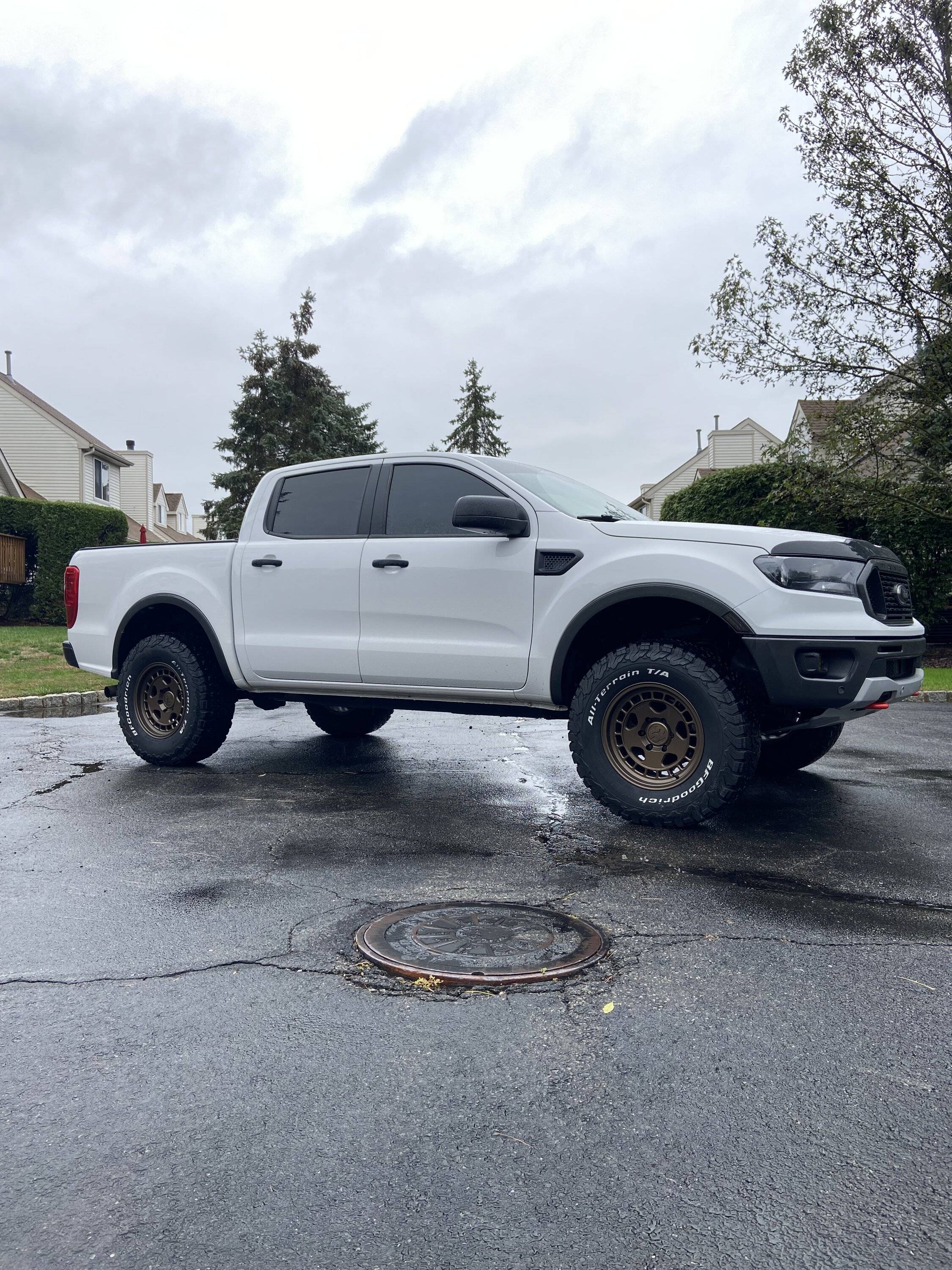

Ask and you shall receive
Definitely sexy. How's road noise? I was looking them up and I'm certain they are great offroad, but also quite bit heavier than OEM ties. Like 15 lbs heavier for the 265/60/18.
Thanks!
Noise is not bad at all. There is some moderate tire noise around town with the windows down at maybe 40mph but it’s very low for an aggressive tire.
These are still C rated so not as heavy as some other options in this size and good road manners. Overall quite happy with the purchase. They balanced pretty well for a big tire too.

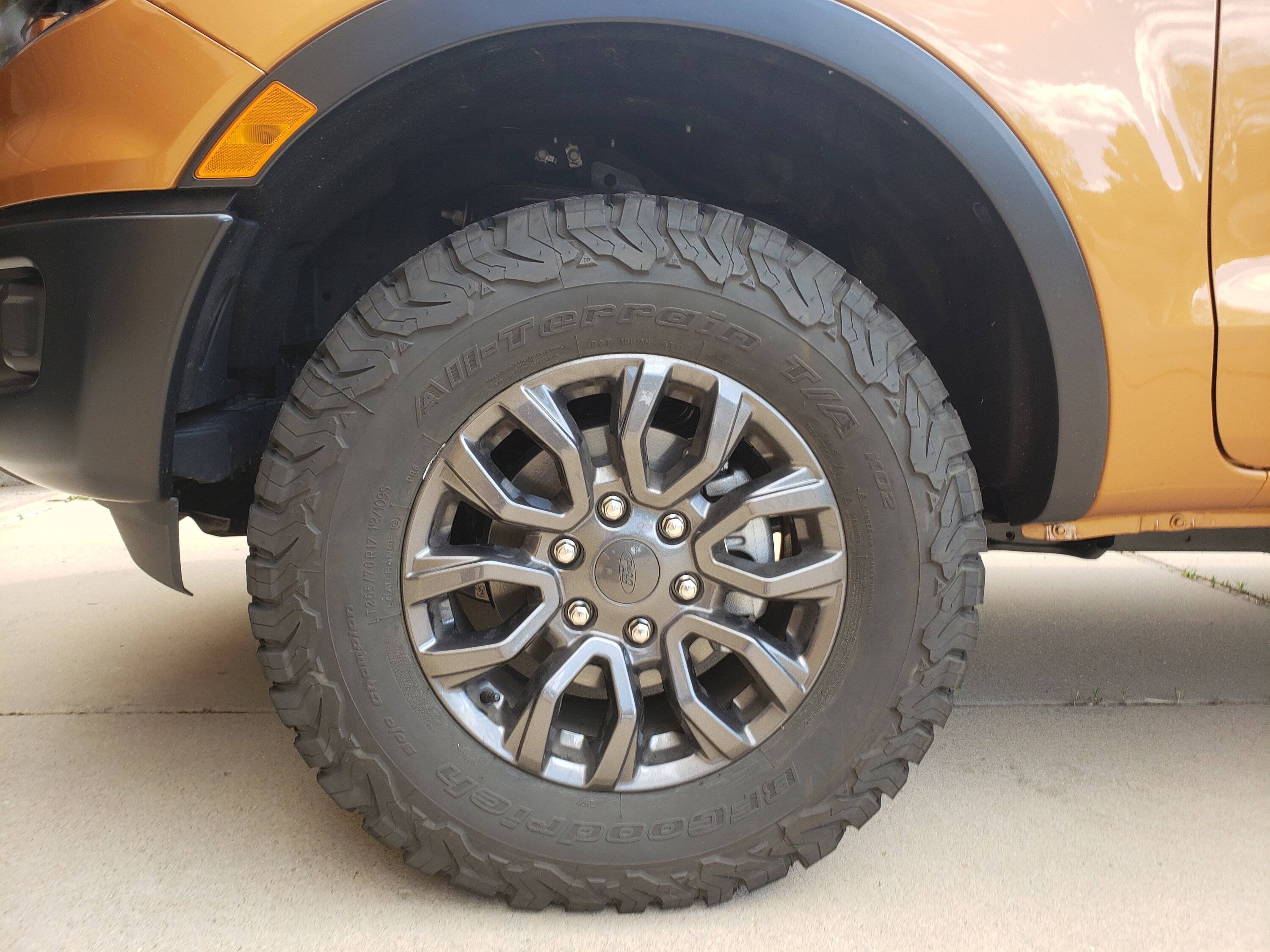

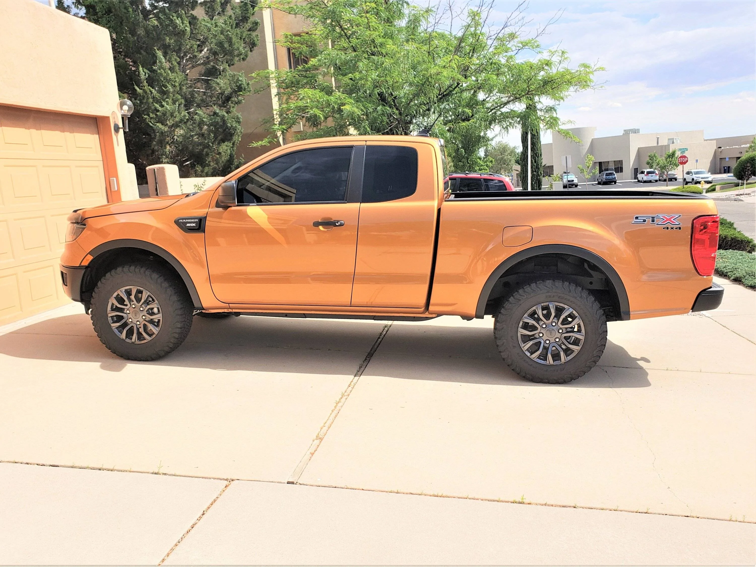

Love my 6ply 265/70/17 KO2's! (45lb.) Quiet and smooth riding on the highways. Can't tell that they are A/T's by the ride. Most reviews say they are long lasting and wear well.

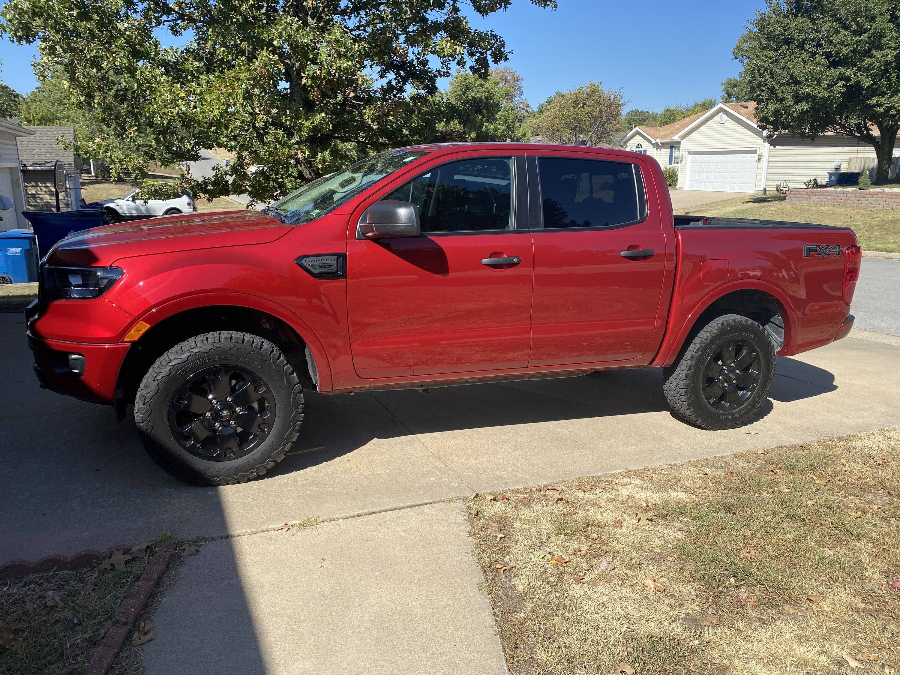

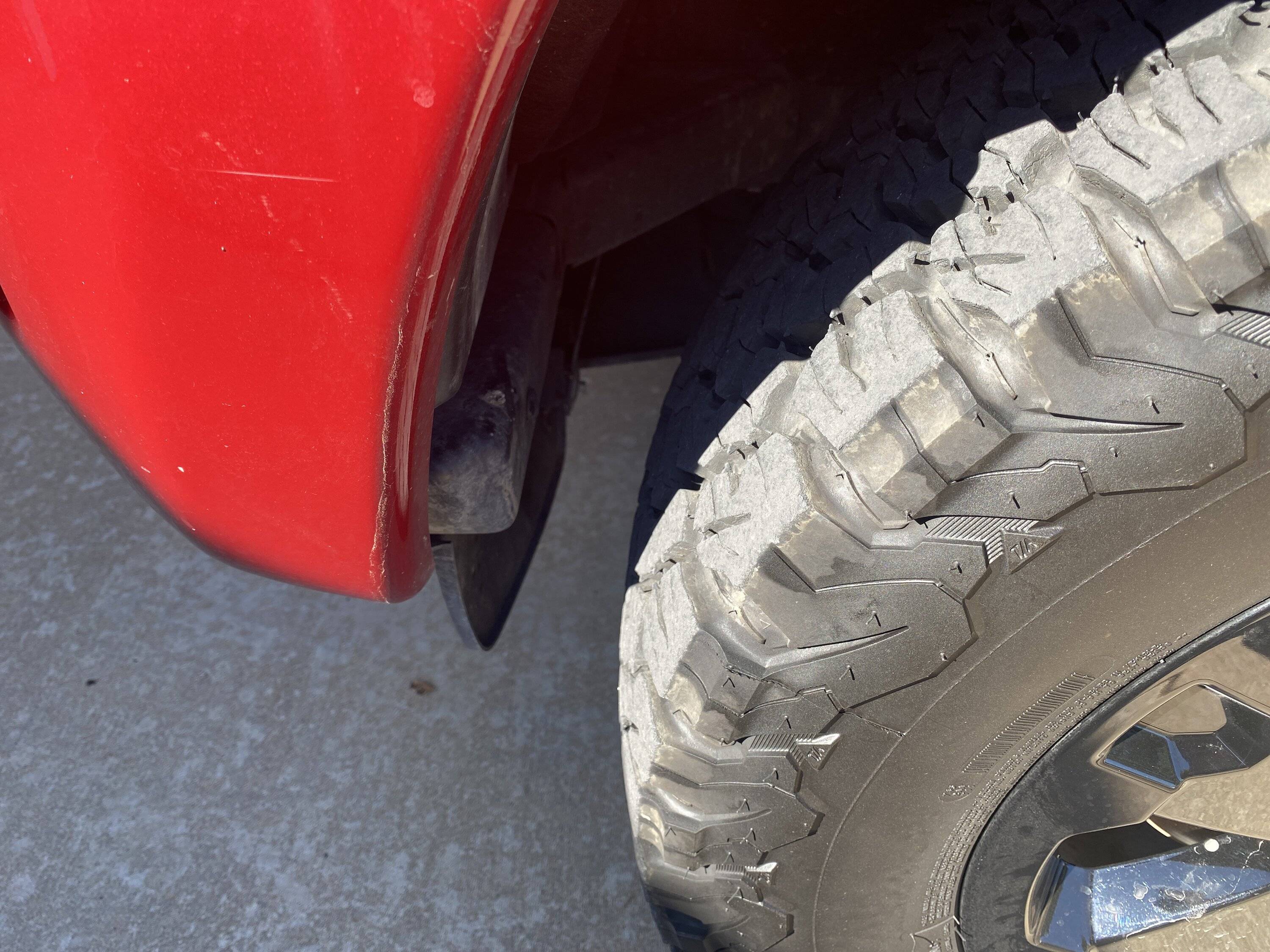

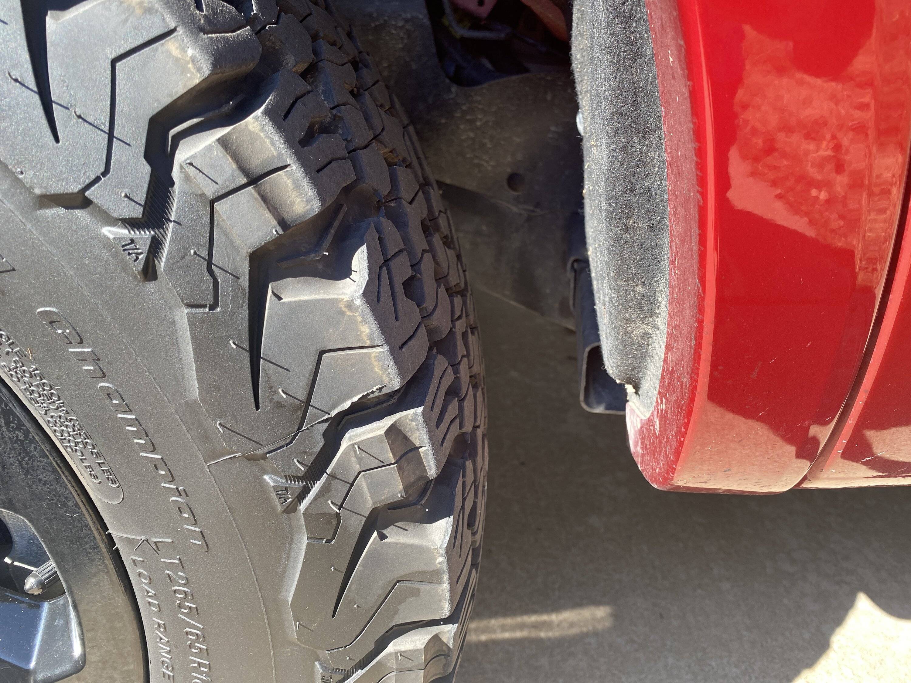

I got the 265 65 r18 ko2s
No rubbing, no cutting crash bars. I love my black appearance package wheels and didn’t want to buy a new set.
