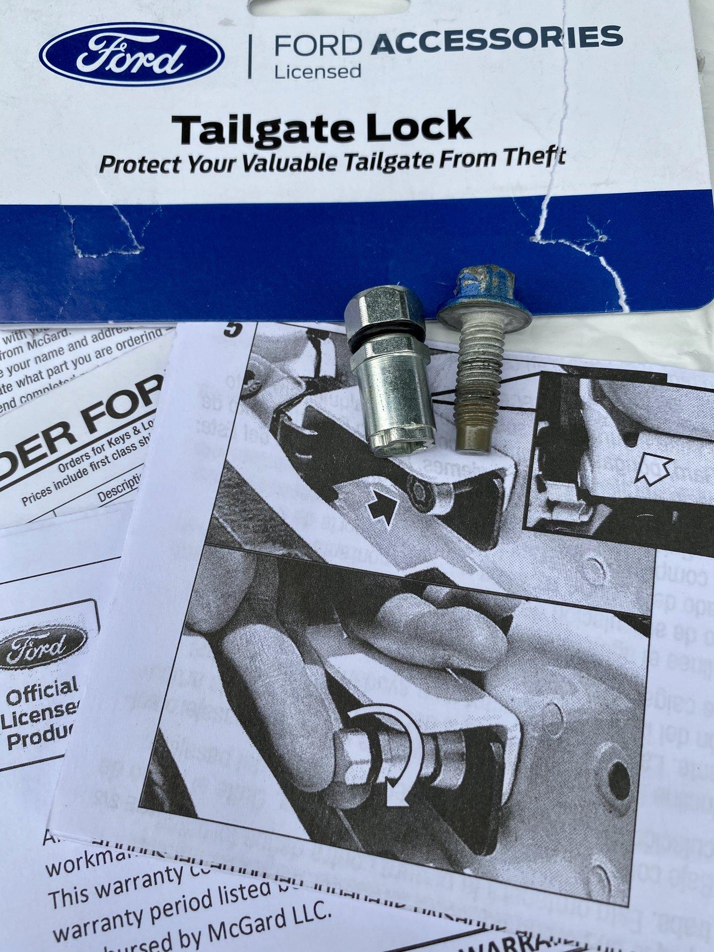

Bought her in November saw threads about tailgate thefts went meh because I’m in the country.
This arrived from my originating dealer today. Install took five minutes. Came packed nicely with a note “we know people have reported thefts we appreciate your business and want to protect your investment”
Was surprised and pleased at the arrival of this.

Hmmm. $39 or a $250-1000 deductible. Seems like cheaper than an insurance claim. On another note, I just went out and tried to pull the tailgate off the anchors with the tailgate up or down and couldnt get it to budge. How are these designed to come off?

Tilt them at about a 45 degree angle and lift them off.

Tailgate lock assembly is an easy install, all you need is a 10mm socket or wrench to remove the original bolt and a 1/2 inch wrench to tighten the new keyed bolt. Easy peasy in 10 minutes. Just remember to keep key and original bolt somewhere safe incase you need to remove tailgate or return it to original condition.

Can someone please explain how this works and how it differs from the oem lock on the tailgate? Thanks!

This isn't the tailgate latch lock. That lock prevents opening the tailgate. The tailgate "bearing" that it rotates up and down on is made like a pipe with a thick flat bar in it. The pipe is part of the tailgate and has a slot in it. The flat bar is attached to the bed. If you want to remove the tailgate from the bed, you lower it to 45* open where the slot will let the bar through, and the lift it off. The lock discussed is bolted over the slot to prevent removal.

VKB3Z-18168-A just found that part number for the tailgate lock on Levittown ford and eBay still can't figure out how it works but there's the number......
of course the shipping is absolutely stupid ridiculous at 22.67 to texas for what looks like two bolts and a piece of metal....... fed ex only option shown so thats a NO........

Sure wish someone would video an installation...I have the item but cannot understand the poor picture instructions and how they go with the written instructions.
