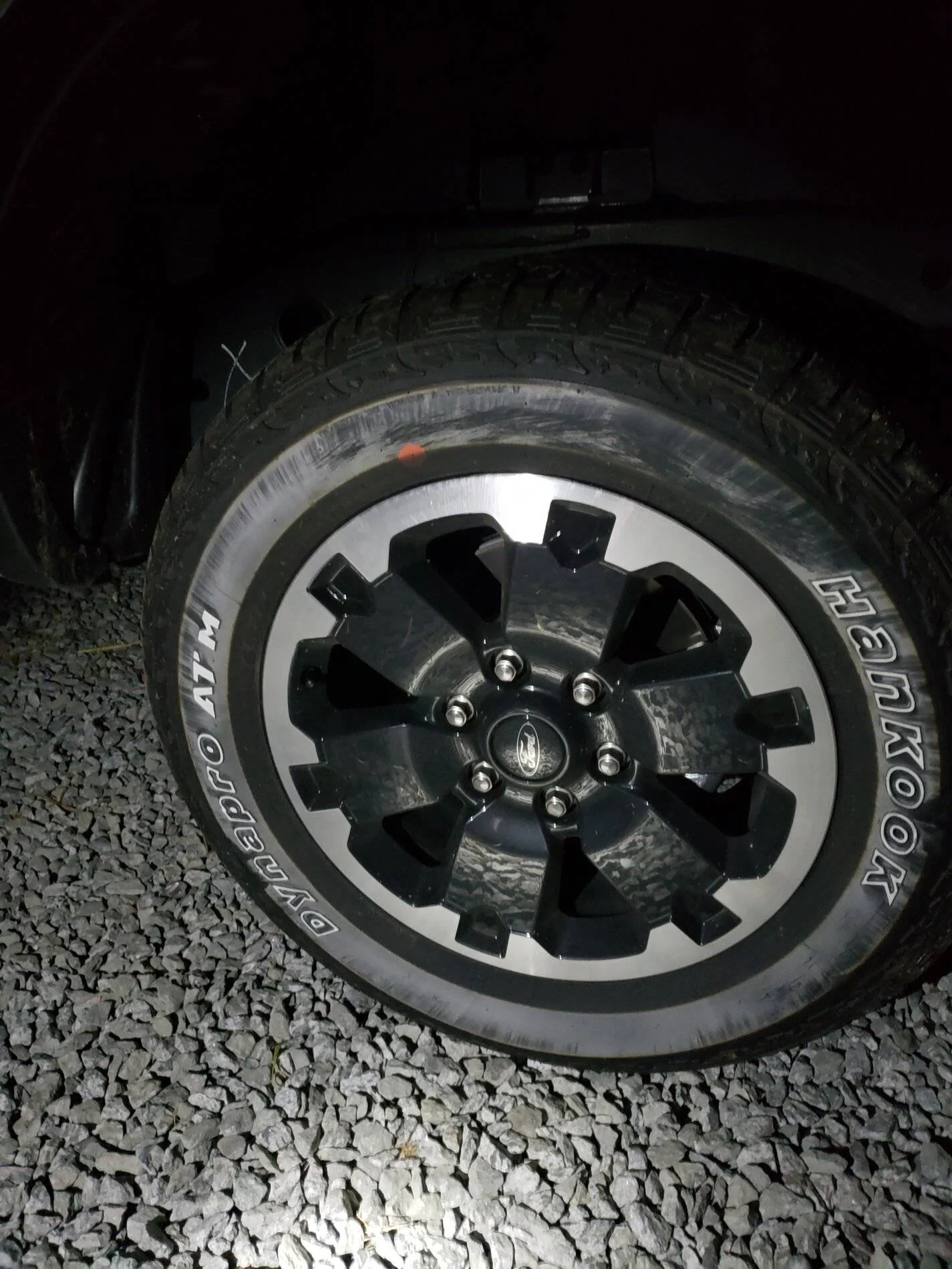

that pic is of my tires after driving 200 mile sint he rain. Truck had about 250 mile son it at the time.

This photo looks like they just need a good cleaning. Not a quick flexi-wand brush or similar, but down on your knees, with a synthitic, stiff bristled hand held brush and a little soap.

I am also noticing the same rapid discoloration in my Hankook 18'' tires that came with my 2020 FX4 Lariat. Do other people also have this happening? Is this issue common for other white lettering tires, or is it some sort of manufacturing defect in the Hankooks? Since it is only a cosmetic issue, I am also doubtful this defect will be covered by the tire warranty.
I have had other brands of tires discolored like this. Took a stiff brush and soapy water and scrubbed them real good.
Then put your fave tire dressing (like McGuires). Like new!
I would clean that up and stop using tire shine - it’s likely the culprit. Use a good rubber conditioner like Aero Cosmetics Rubber Care instead. It gives a dark matte black finish and is good for your tires. Gets rid of that brown oxidized-looking buildup and just might stop that chalky buildup at the same time.
It’s not shiny - it’s a matte finish.
