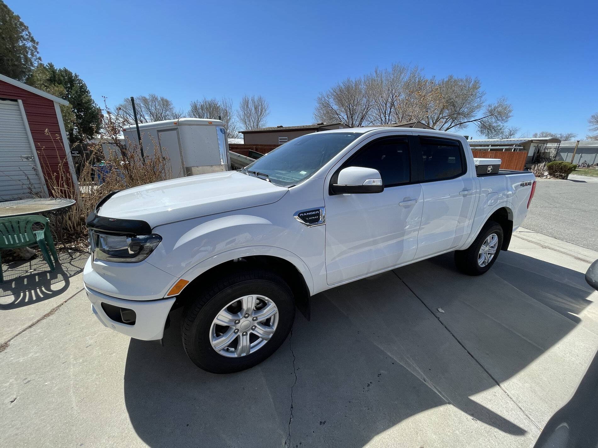

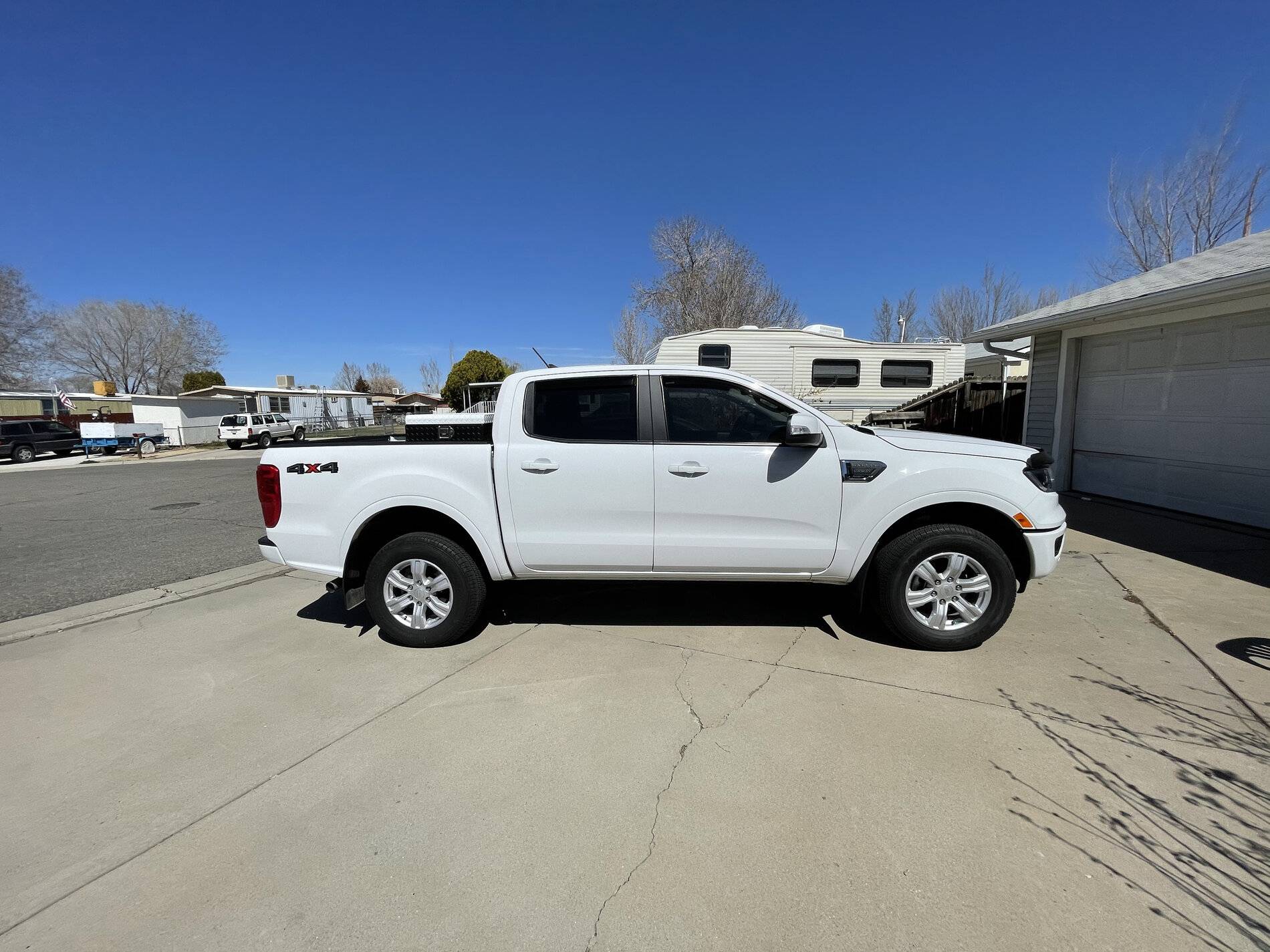

I got a set of the 17" STX from a friend ... I love the look, but, find the Bridgestone Tires like to follow the grooves on concrete highway. Not a biggie, but, a Tad unnerving at first.
Aside from that, the ride is better due to more sidewall. The speedometer is still dead on, according to Colorado State Patrol. The wheels I got had TPMS sensors in them, so I can change back and forth and the truck just seems to "know" what tire's or at least tire pressure is.
Personally, I like the STX wheels better than the 18" Lariat rims.
