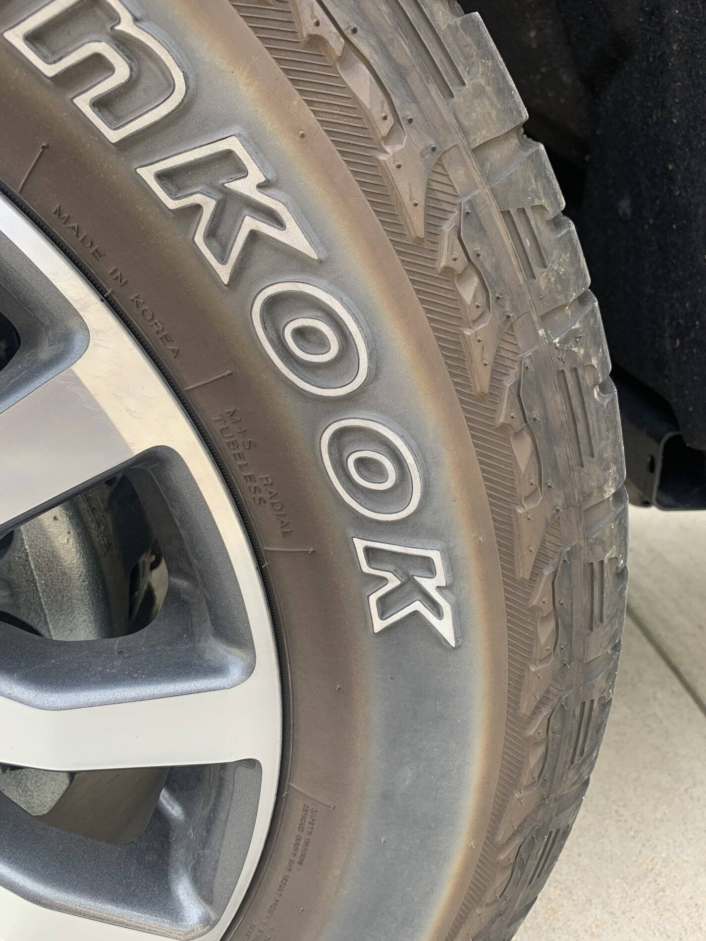

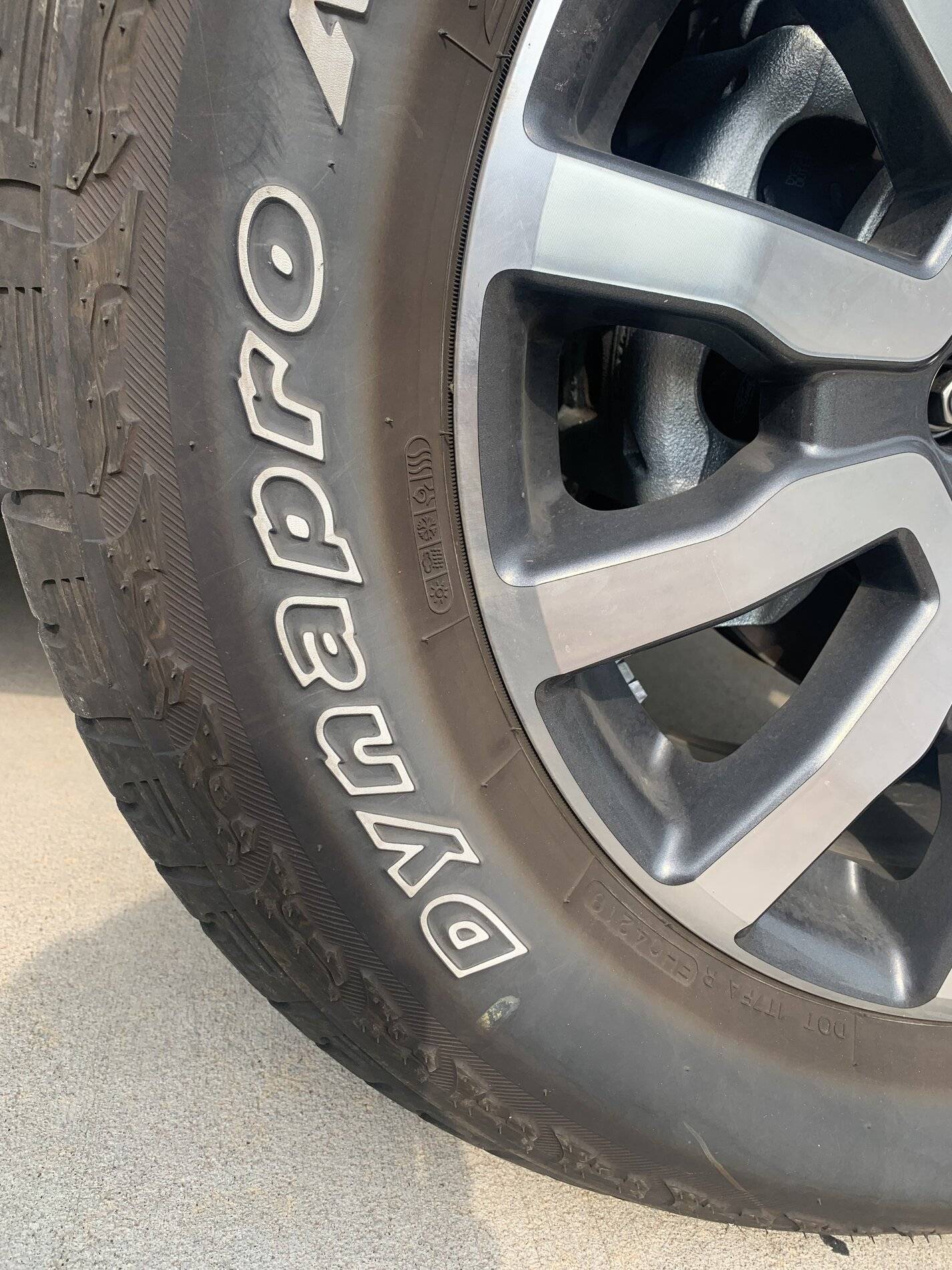

and the tires have some sort of white lettering defect where the whole sidewall is white unless you keep it dressed with tire shine
I am also noticing the same rapid discoloration in my Hankook 18'' tires that came with my 2020 FX4 Lariat. Do other people also have this happening? Is this issue common for other white lettering tires, or is it some sort of manufacturing defect in the Hankooks? Since it is only a cosmetic issue, I am also doubtful this defect will be covered by the tire warranty.

Yeah. Mine looks just like that after I drive thru alot of rain. Tire shine hides it. To me, if it's within so much time they should replace. I need to look into this and the next time I wash it I won't dress try tires so they can see. At 200 miles I noticed it after a trip through torrential rains. My sales man said something they put on tires at dealer. Aka the dressing. The band is perfectly around tire so that's not it. I think it's a defect with the top black coating that is supposed to hide the whitewall from the white lettering band. Complain. I am. Maybe will be a tsb.

I will also say I have had white lettering on other tires and never had this happen. I have a 2007 xterra in my garage with white lettered duratracs and all it has ever since since new, in 2006, are white letters and never had this issue. Defect.
I would definitely be complaining about that, and expecting replacements or compensation.

i've pinged my sales guy again about this- i pinged him after driving it 200 miles and sent him a pic back then and it was worse than the pic above but exactly the same area. it is on all tires with some worse than others.
