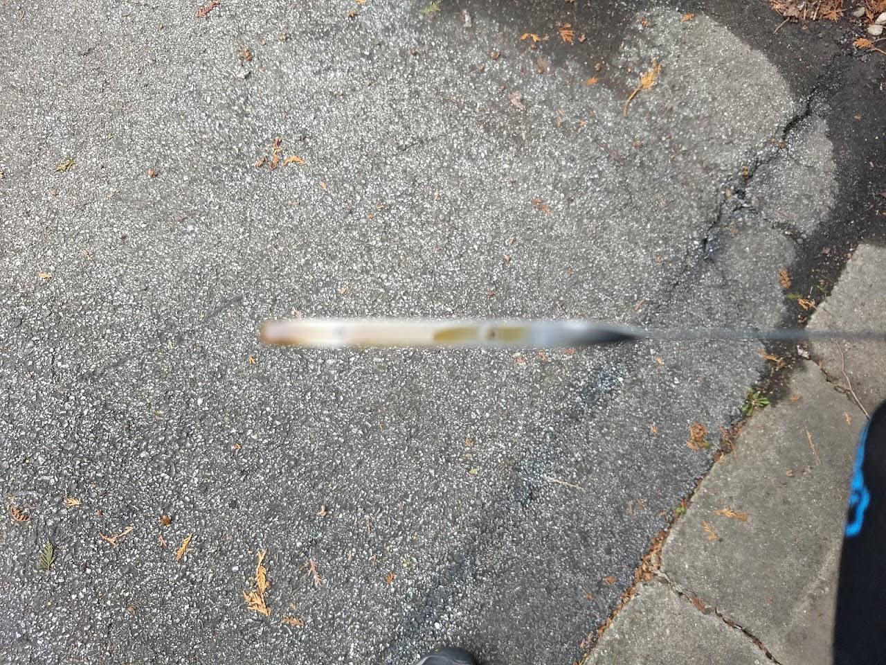

Oil Level on our Ranger, factory fill synthetic blend. From when we picked it up with 3 miles on it... until first oil change at 3,686 miles.
Take a photo: it's a great way to compare if things have changed.
@ 2,200 miles the oil looked like this:

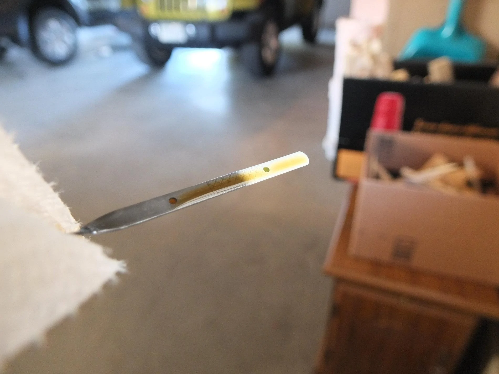

Like this?
2epfHGWKIDdN2nxg8B_oQaOOi7zqJiJ2CFpJMy9Y49aUHbrnYqEIn5D6ICSTfS6wswiznJcpvVEtc9bxKS=w1280-h960-no.jpg
