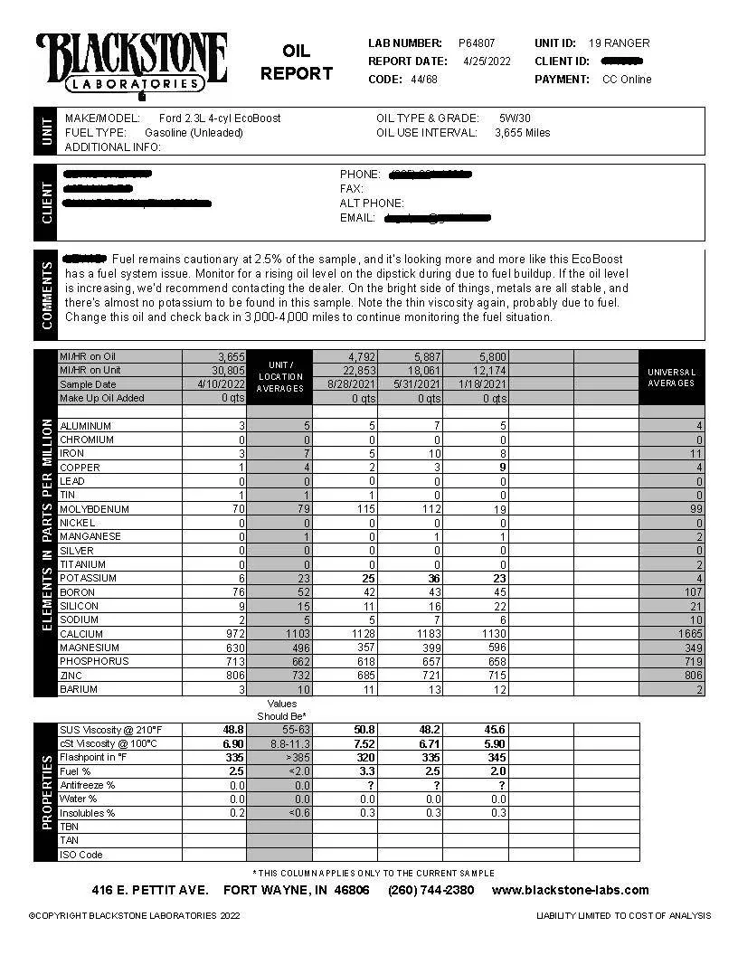

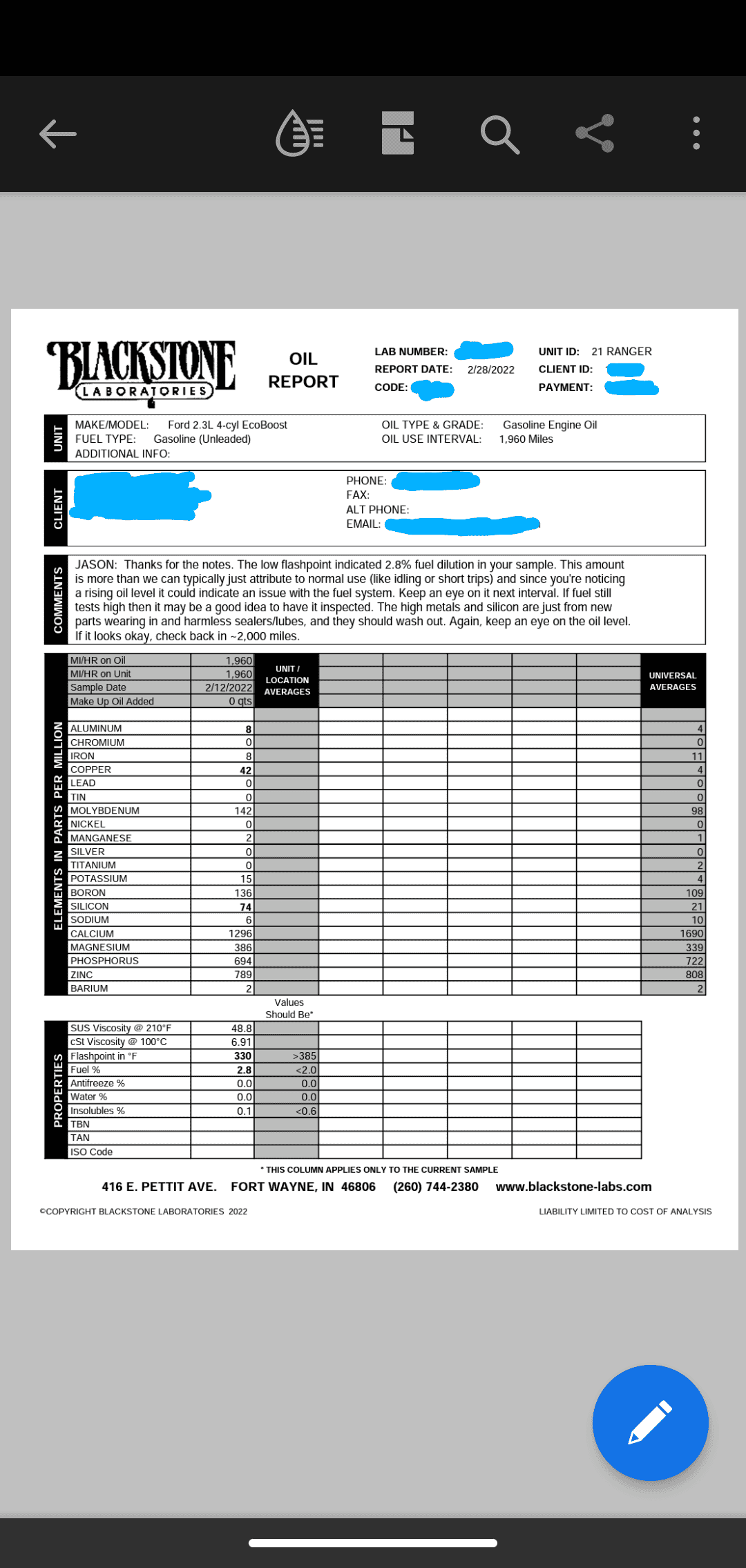

Im cautiously optimistic that mine may be improving. I have more than 2k miles on my oil change and the oil level has only risen about 1/16th of an inch as opposed to the 3/8 inch rise on the factory fill in the first 1960 miles.Got my oil analysis back today. I forgot to include my 5w30 oil weight so they didn't include the sus viscosity (55-63) or cst viscosity (8.8-11.3) acceptable ranges on the report.
Oil level at about 34 miles was at max fill hole and at 1960 miles it was 3/8" above max fill. Recovered about 6.75 quarts on the drain and lost a little. When I refilled engine with 6.25 quarts, it was at max fill hole. So somewhere between .5 and .75 quart will bring it from max fill hole to 3/8" above max fill.
