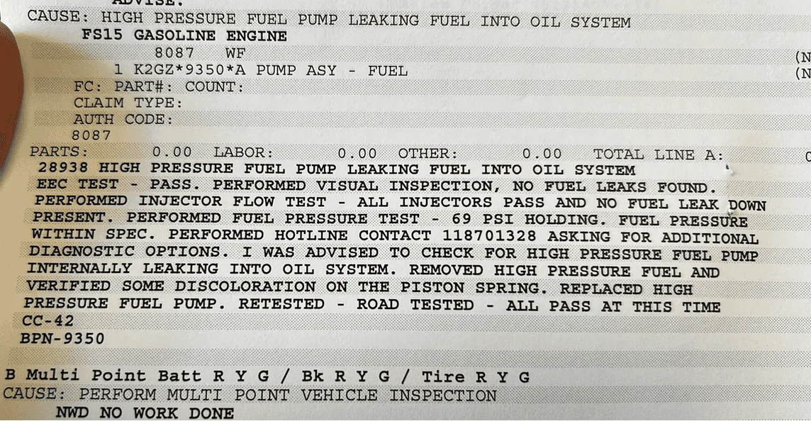

Getting back on topic, my oil was drained and measured at 28k miles. 7qts were again measured and oil was diluted by the fuel. Oil smelt of fuel and was thin. Below is pic of what was done by tech. High pressure fuel pump was replaced.
Those who have their records from repair attempts, please pm as the dealership's service manger would like to see what other techs have attempted to replace to resolve issue. I have yet not sent out sample to blackstone for analysis. I do not believe replacing the high pressure fuel pump will resolve my issue.
Thanks,
Joe

Thank you for sharing that service department write-up. I have tested the resting fuel rail pressure myself and it was holding at 70psi on mine. Sounds like that is the expected range.
My first dealer service visit was a waste of time really. They were going to start the diagnosis process, but ford corporate stopped the pre-authorization and redirected them to check the engine oil level immediately after shutting the engine off, instead of following the owner manual instructions to wait 15 minutes. I requested an updated addendum to add to my owner manual and that has been met with crickets. Of course they would not give me any visit documents showing why I was there and even the Ford pass app has no details other than I visited. I made notes on the paper given of why I was there, signed and dated it and took a picture for timestamp evidence. Not my first rodeo.
