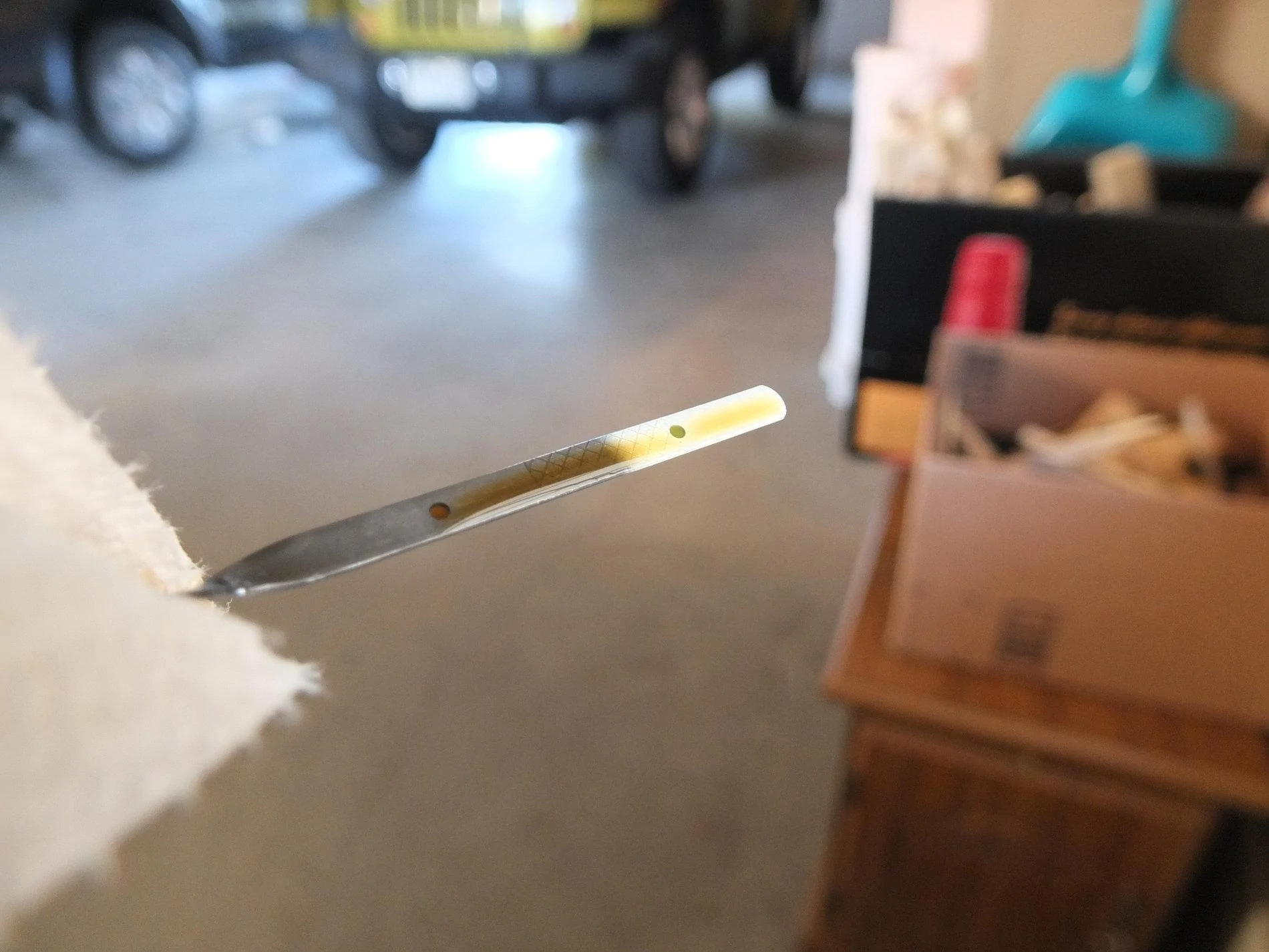

FWIW: What I did was take a photo of the dipstick with oil on it... then compare the photo to each time you check it.

Is this your level, with 6.0, or 6.2 quarts??
Factory fill...
But when I changed the oil I put in 6.0 quarts, not 6.2... worked just right. :like:

I still have not found the answer to how the Ranger dipstick is marked. Mine has two holes and a hatched area that starts at the lower hole and stops before the top hole. The owners manual does not picture my dipstick and instead shows hatched area stopping at upper hole.
Is the upper hole full mark or the top of the hatched area? Ive had two dealer oil changes and one was at top of hatch, the other was between top hatched area and upper hole.
With fuel added to my oil, it is above upper hole when checked after sitting overnight.

So ooo-- The picture is your previous, oil level?? I did the same thing, at 6k (second oil change/6 quart dump), but didn't "establish" the level on the stick-- at 7000 miles, checked it cold/overnite sit, and level is 1/4 inch, above top of crosshatch area, well below that "upper hole".
