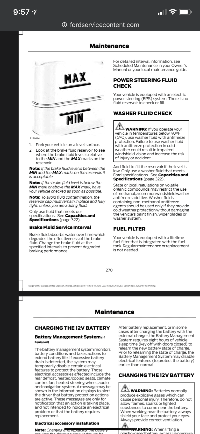

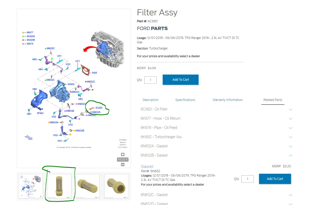

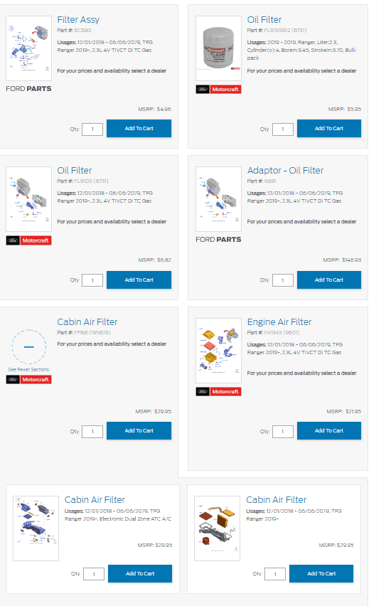

2019 Ranger Owners Manual -Replace the engine-mounted and frame-mounted fuel filters every 30k. I spoke to a service advisor who advised this is not the case. He checked with his parts department as well and they advised there are no fuel filters listed for the Ranger. Any comments on this? Why it may be listed in the in the manual?
I'm guessing that it was carried over from the T6 rangers which are diesels. Probably saves time and money being able to copy a bunch of pages rather than create a new manual from scratch.
