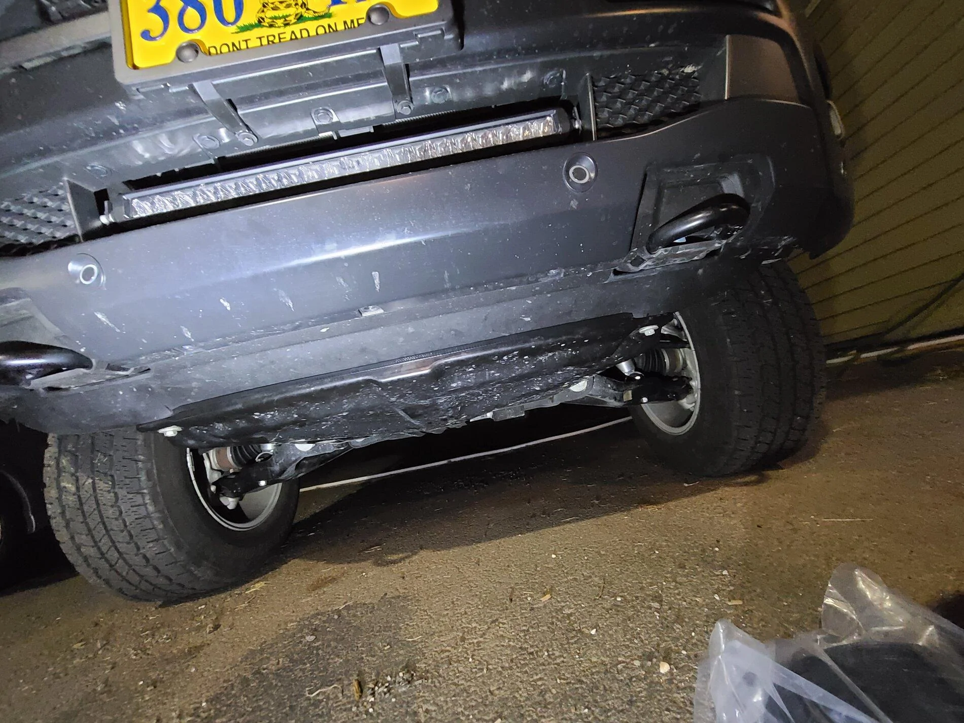

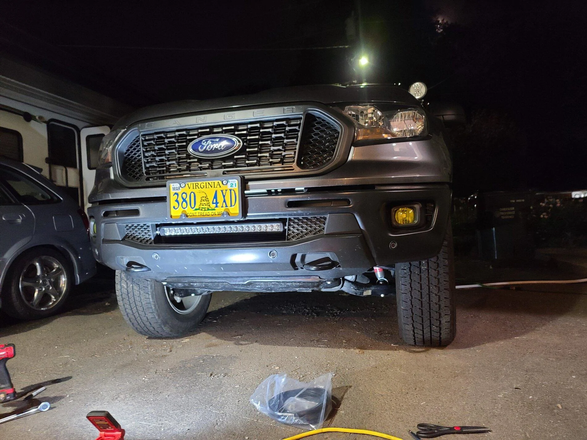

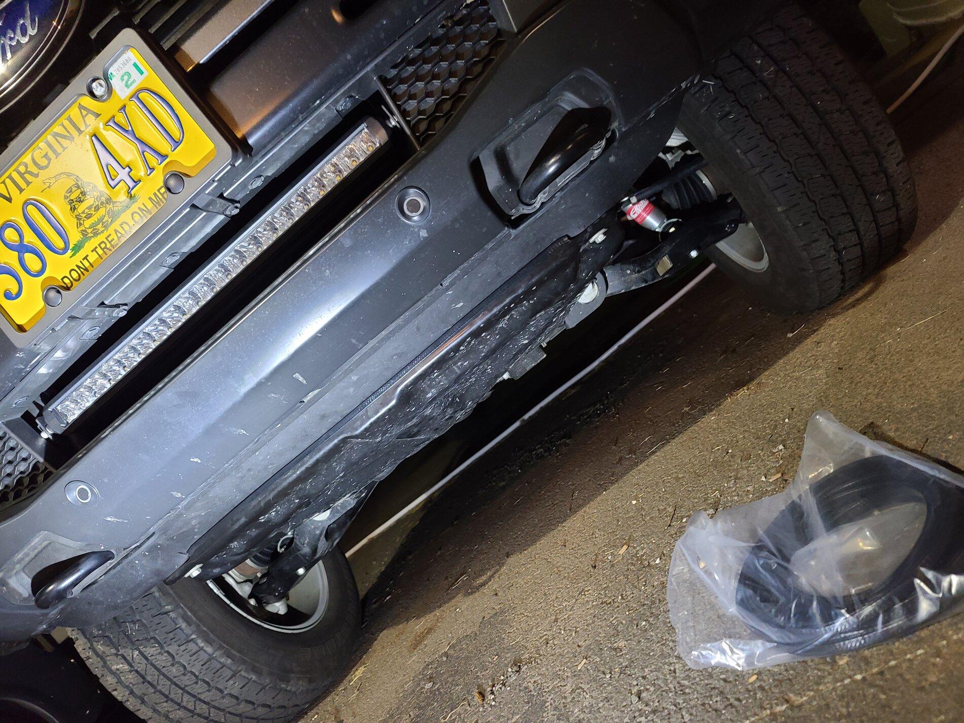

Well Boys, I got'r done. I might add, doing this mod would have been so much easier, had I decided to do it before removing the air dam to store in my frig'n attic. Trying to wrestle it back on and lining up the bolt holes for prep and tracing was a real challenge to my Christianity.. Not gunna lie. I had a bit of a time with it, rolling around on the garage floor... Words were said, tempers flared, I think I may have overheard Duke and Dave's name being used in vein once or twice?.. It put up a good fight, but in the end, clean living prevailed.
Mine is about an inch wider than intended. Having a firm grasp on my limited capabilities, I was worried about fitment, so I kept a little extra on the width. I figuring I could always trim it down further later on, if necessary. - All in all, (a side from feeling like I've been repeatedly kicked in the ribs) I'm super happy with it.
Thanks again fellas!
