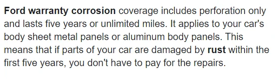

i thought Fords rust warranty was for perforation on panels only?
gonna take a fair bit for that to perforate.
That is body panels nothing about frame and cross members . No one is willing to buy a new truck with. A rusty bottom . It's a defect in there paint .

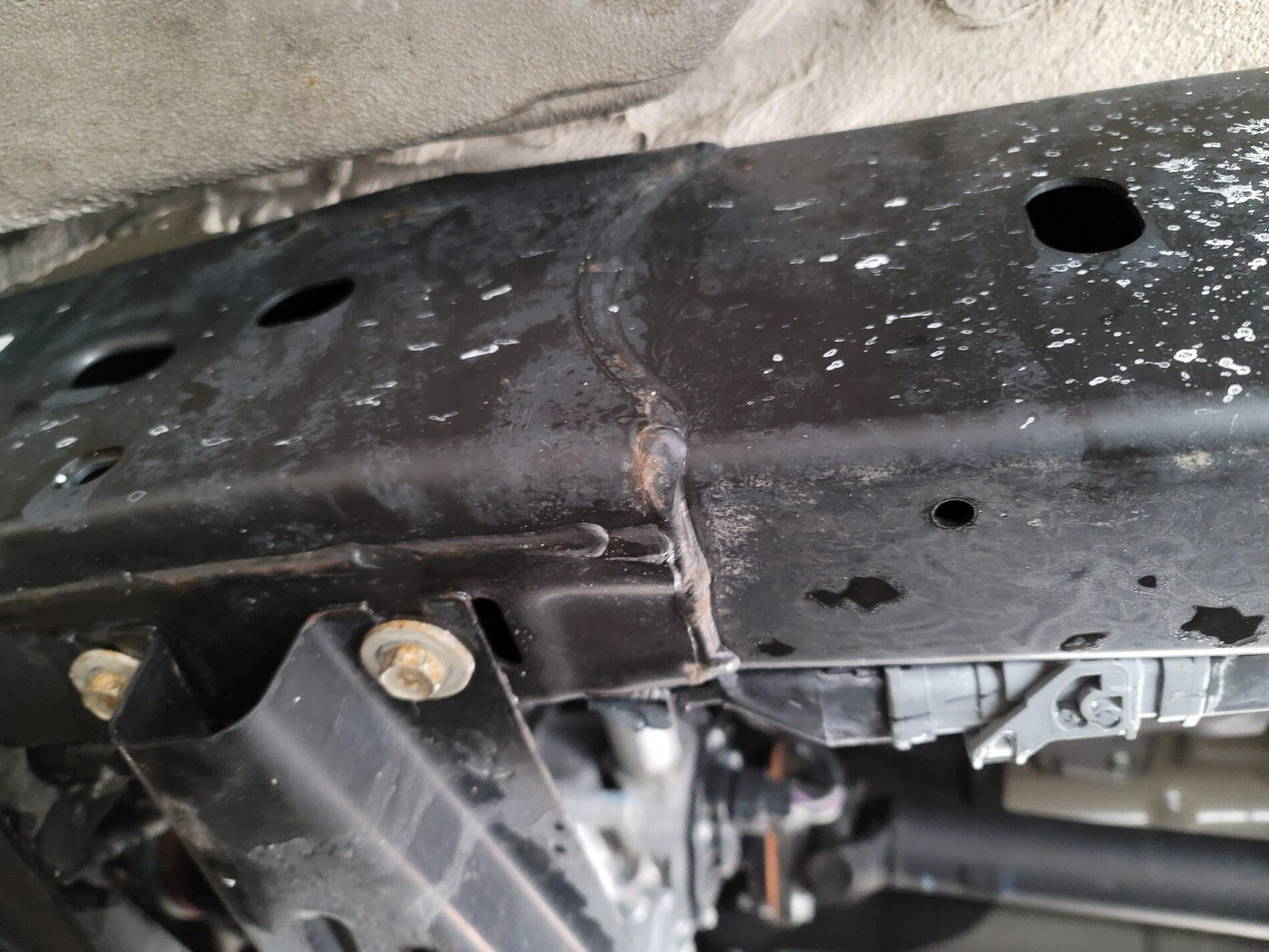

This is what mine looks like. My 2nd winter with the truck. I plan to hit the welds with a wire brush and hit them with rust-oleum for cosmetic reasons.
